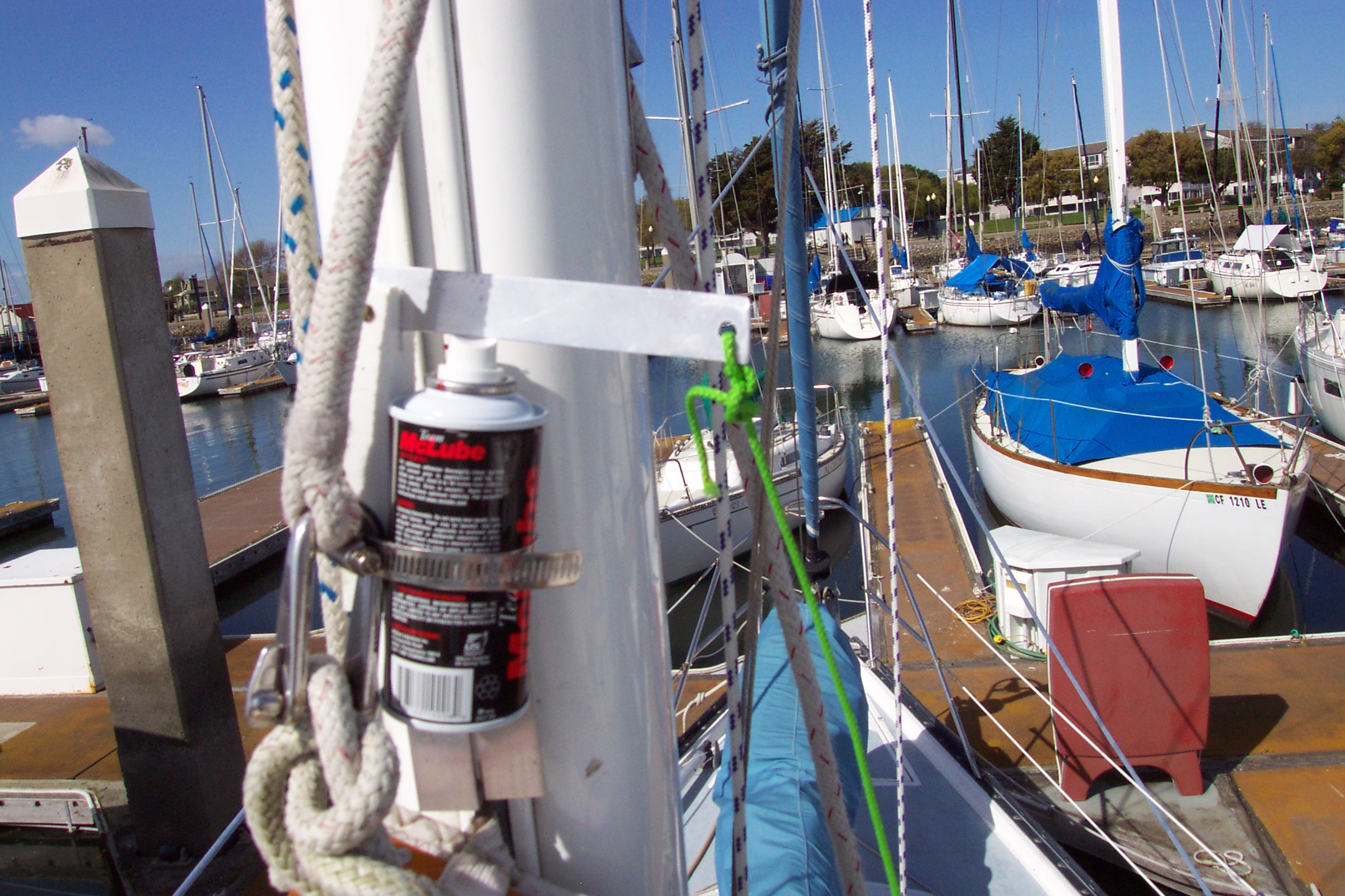

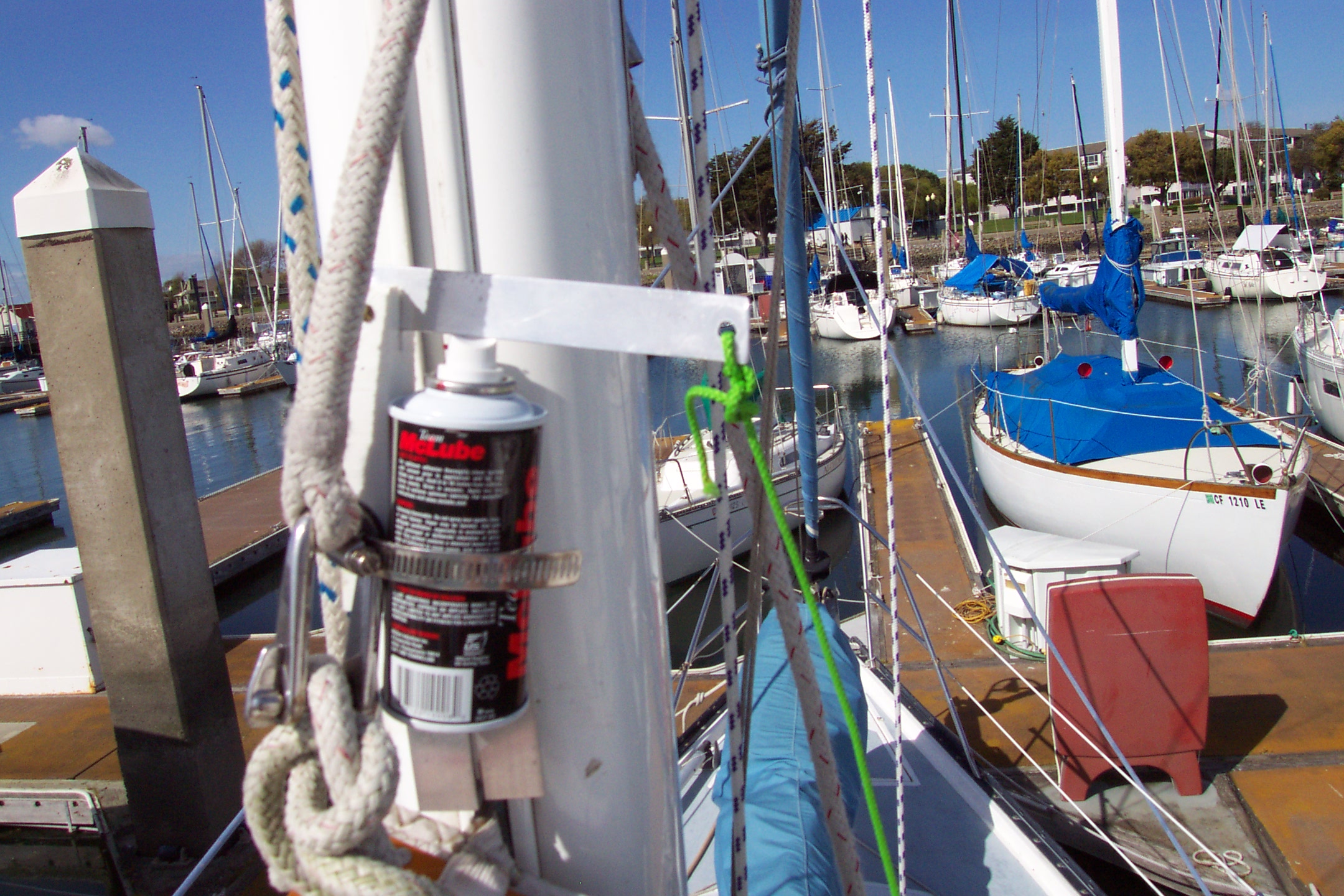

I cobbled together a rig as shown in the picture. The halyard is used to raise and lower the can of McLube and the green cord allows remote squirting. Treatments are good fir about 2 years at a time and it really works.
Ingenious, John. However, there is a kit that you can purchase that does the same thing if one is not of the ingenious inclination. Some will use a dry lube soaked rag stuffed inside the track an pull it up the mast with the halyard. That is also supposed to work quite well and cleans and lubes the track in one swipe.

... there is a kit that you can purchase that does the same thing if one is not of the ingenious inclination.
I am far from ingenious - do you have a link to a product that holds a can to the headboard shackle (I could do John's hose clamp), but more importantly activates the spray?
