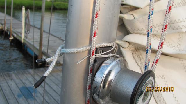

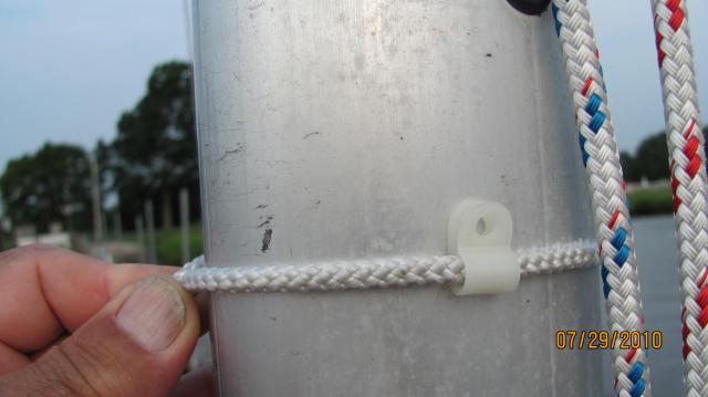

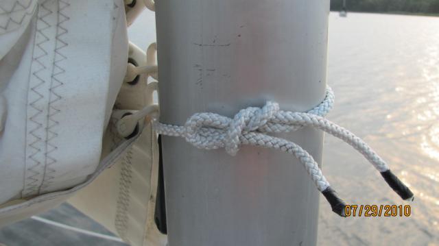

Here's a sail slide stop that I've been using for many years that is fast and easy to use. It involves a small diameter braid line tied around the mast with a reef knot. As most of you know, a reef knot is nothing more than a quick release square knot. Fortunately, I have a mast winch that is situated in the right place, that supports the line above the sail slide feed track, that keeps the line from sliding down the mast. I recently decided to tie the braid line to the winch bracket with a small twine. If you don't have a mast winch you could still use this idea on your boat by installing a plastic wire clip with a stainless steel machine screw to hold it in place.
I've tried those "knob thingies" that they sell at "Worst Marine" and I don't like them. If you're not keen on drilling and tapping a small hole in your mast, maybe you could just use Velcro for now and try it out. I've found that the Velcro which is sold in Automotive stores is more heavy duty with larger hooks than the fabric store variety. I recently purchased some at Auto Tech and I've been using it in the interior of my boat and it holds up pretty well. Give it a try and let me know if you like it. The winch on my mast is on the Port side, so I make the reef knot on the Starboard side. You may prefer the reef knot on the Port side. It's entirely up to you.
