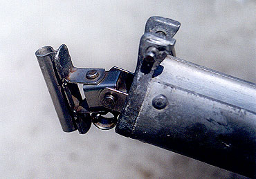

Most Odays of that era used a sliding gooseneck.
Unless the mast head sheaves are 'frozen' and unable to turn freely, your problem 'may' be how you set the sliding gooseneck
before you raise the sail.

4. Once the mainsail is
fully raised as far as it will go, loosen the 'pin' on the gooseneck fitting and (pull) slide down the gooseneck to the 'top of the black band on the mast' OR pull down on the sail/boom (stretching out the boltrope) by approximately 1-3/4" to 2" and lock the gooseneck. Some sliding gooseneck arrangements will have a 'downhaul' rope which attaches and is held fast to the mast via a horn cleat ... usually near the 'deck' to 'lock' the gooseneck.
In any set-up with a sliding gooseneck, the 'final' adjustment is always pulling
down on the gooseneck to TENSION the boltrope on the mainsail. (That final tension is what holds the halyard in its ball cleat or sharks toothed cleat, etc.
