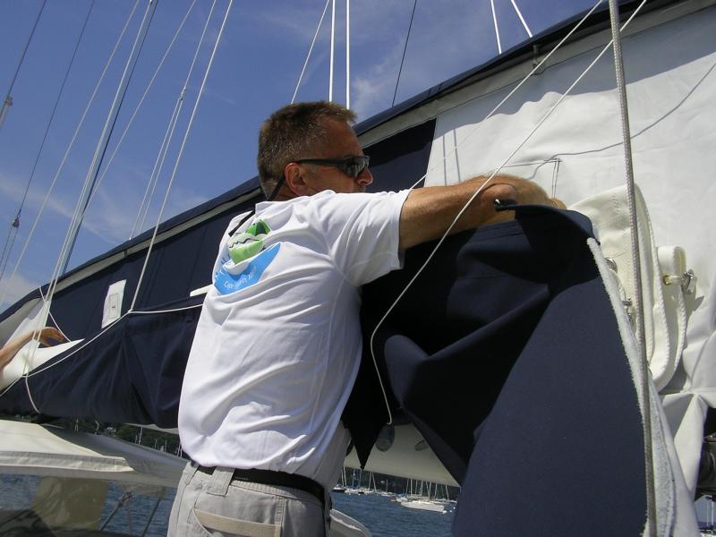

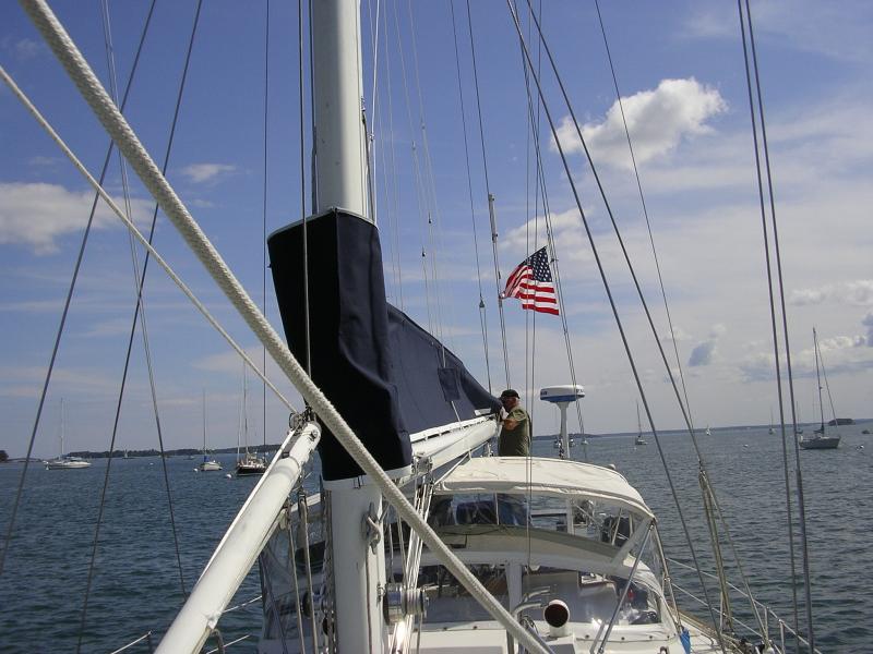

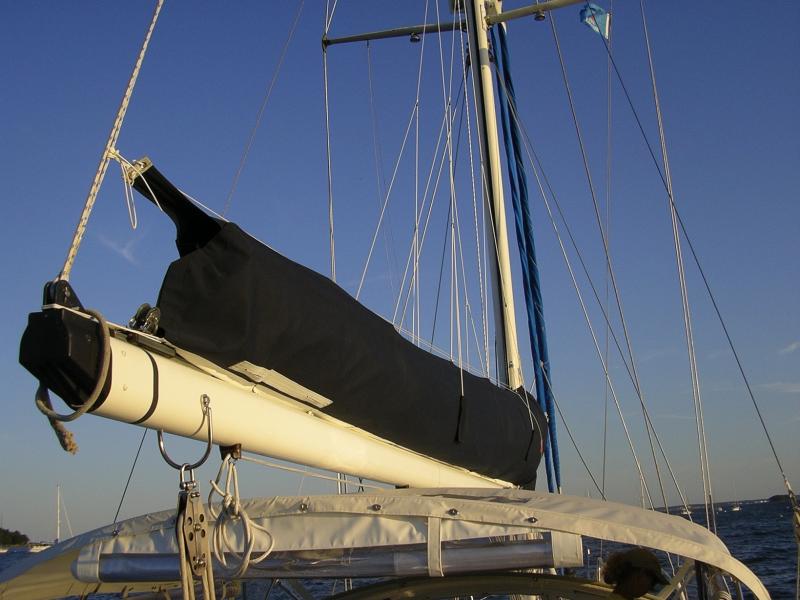

We have one that's a little different. The pack was made by a local loft and the pack has slugs which slide in the boom track. The main is loose-footed, no slugs just a tack and clew. Here's three pictures when it was first made. I've since altered a few items that make it work better.
We had issues with rain seeping through the zipper on top and filling the folds in the sail. Its going to happen. Ours holds many gallons if we don't raise it after a good rain. I've learned to leave one side slack so that the zipper isn't a low point.
As you may have seen in the other videos of packs, dropping the sail needs some stuffing to get it all back inside especially with a new sail. Ours is still stiff after three years and requires me to pull the boom over to the side of our bimini to stuff it and pull the zipper. The zipper likes to be pulled straight, you can't cheat off to one side.
I raise the main at the mast so my wife has to hold the boat to the wind. She doesn't have an easy time of it even with tell-tells, windex, and ST60 showing wind direction. Once the battens clear the jack lines we're good to go. I'm adding more line to the jacks to pull them free for raising.
Once the main is up we sometimes leave the pack up which doesn't seem to affect the sail shape. Other times I drop it level with the boom. Not too sure which is best.
We made a little cover for over the top if we're going to be in a marina or anchored for a while and that keeps the water out as well as bird crap.
The 3rd picture shows the inside of the pack as we loaded the main.

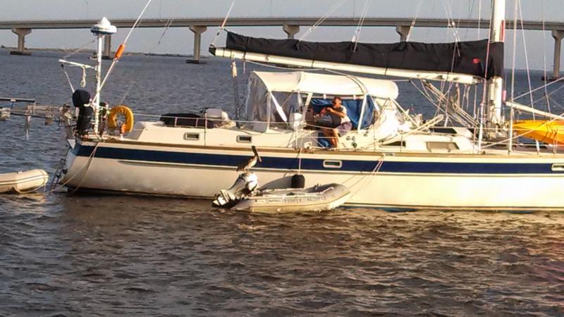

All U Get
Ps I found this picture of what it looked like while we cruised. Sorry no close ups of the reefing lines going through the rear of the pack.
