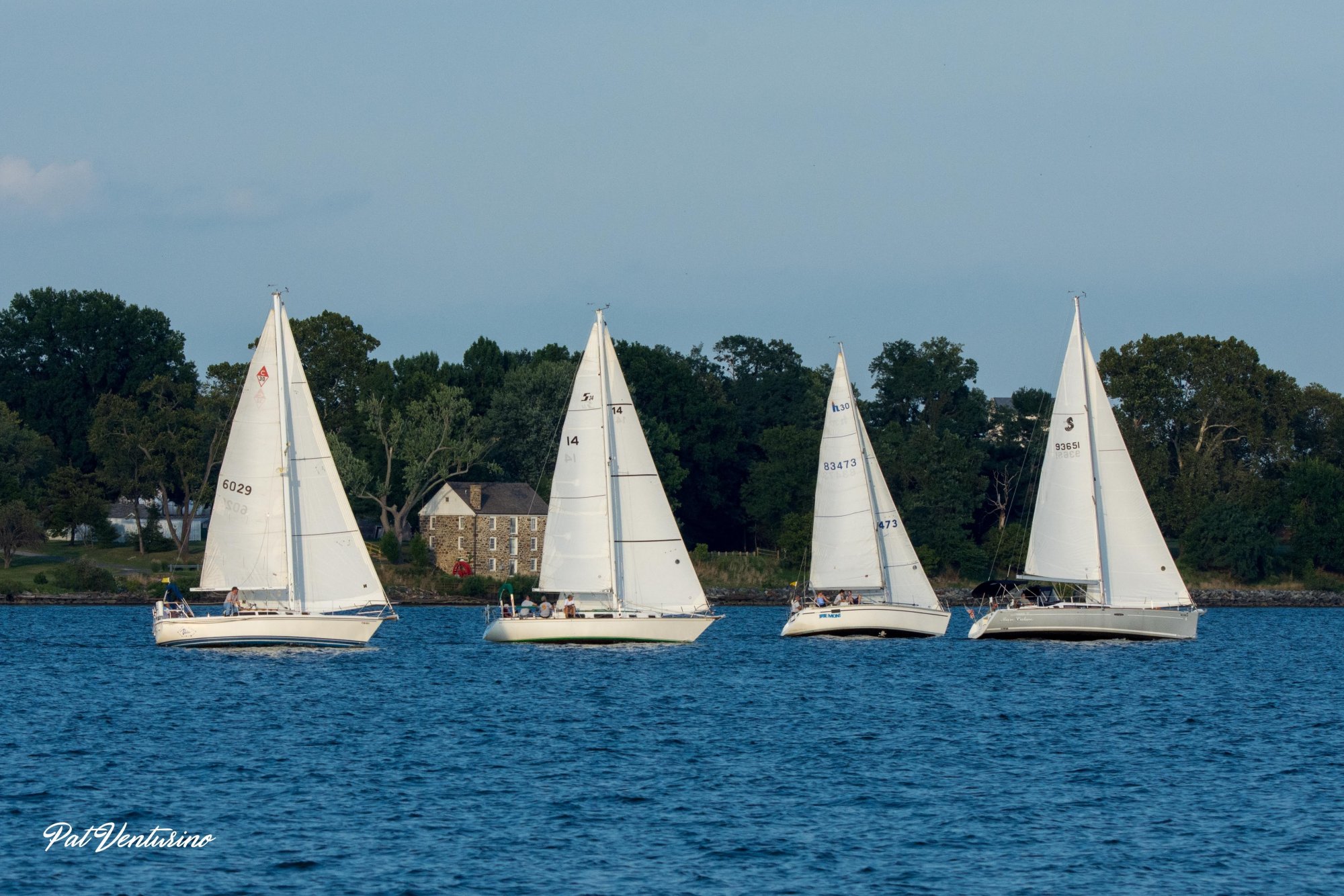

I used the 12” numbers from Defender for our mainsail on a 37’ boat. I don’t find them too small. For perspective, here’s a view -

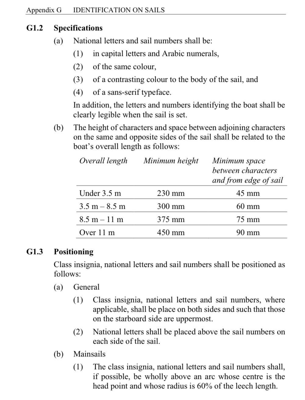

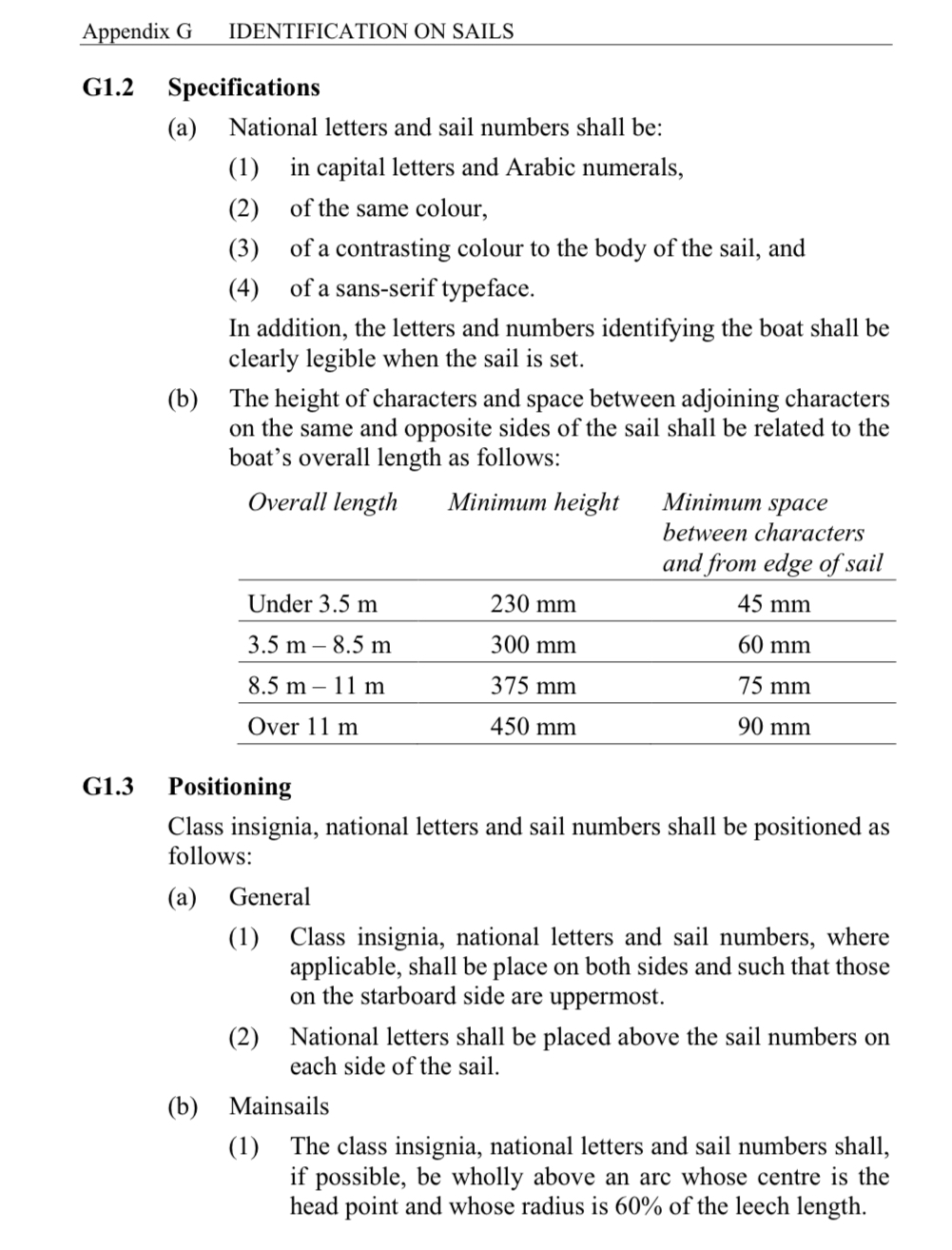

I did not realize those requirements. I will see what I can find out there and position them accordingly. Thanks again for your help.

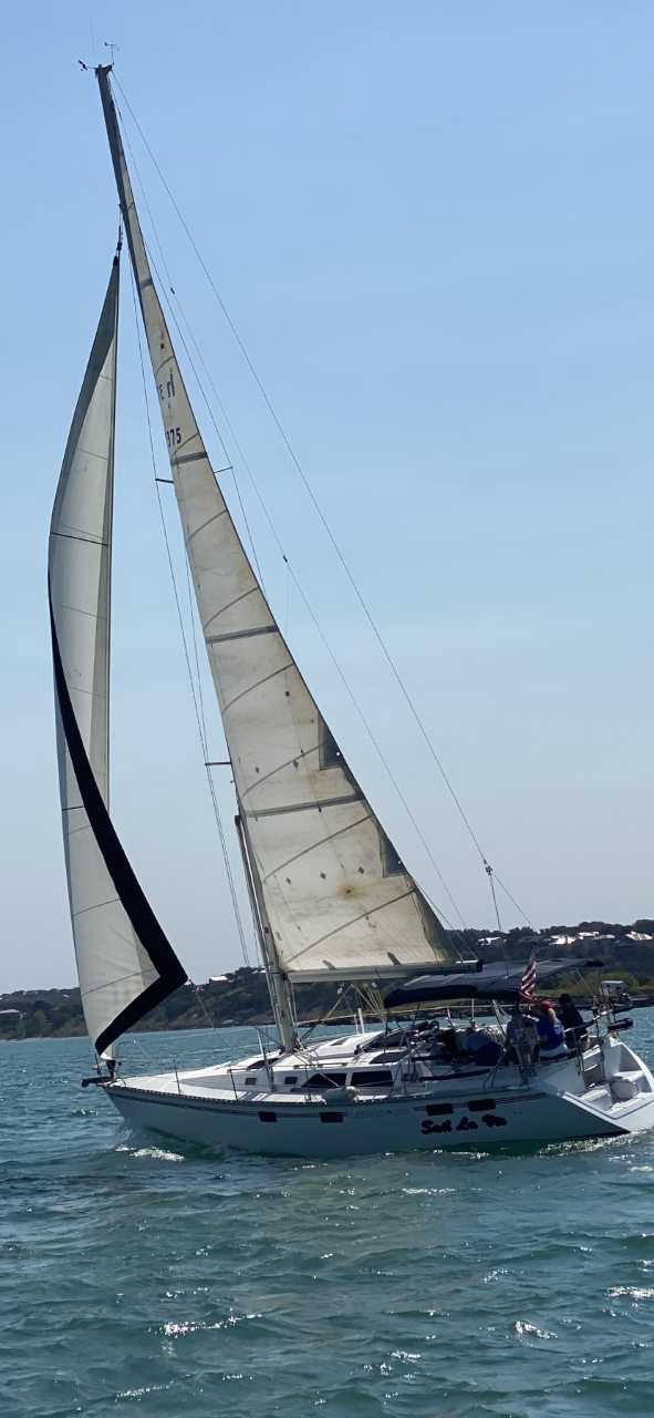

My wife and I went up to the boat last weekend to put the numbers on the mainsail and I did not put them on straight...damn!!!!! This weekend I will try to peel them off and start over, or I must order two new ones.
Damn!!!!

@Panama Jack - dang, feel your pain. Nothing worse than that feeling of trying hard to get something right and have it good sideways... somehow, the harder I try the more squirrelly they go! And casual indifference gives better results!
Fingers crossed for you... though I fear with a week of sitting the adhesive will present a challenge... but maybe a casual approach to removing will work! Don't overthink it!
Good Luck!

Sorry to hear that. Between the leech, luff, cross cut panels, and draft there are certainly plenty of disorienting lines to make it tricky. They don’t always come out in the same direction.

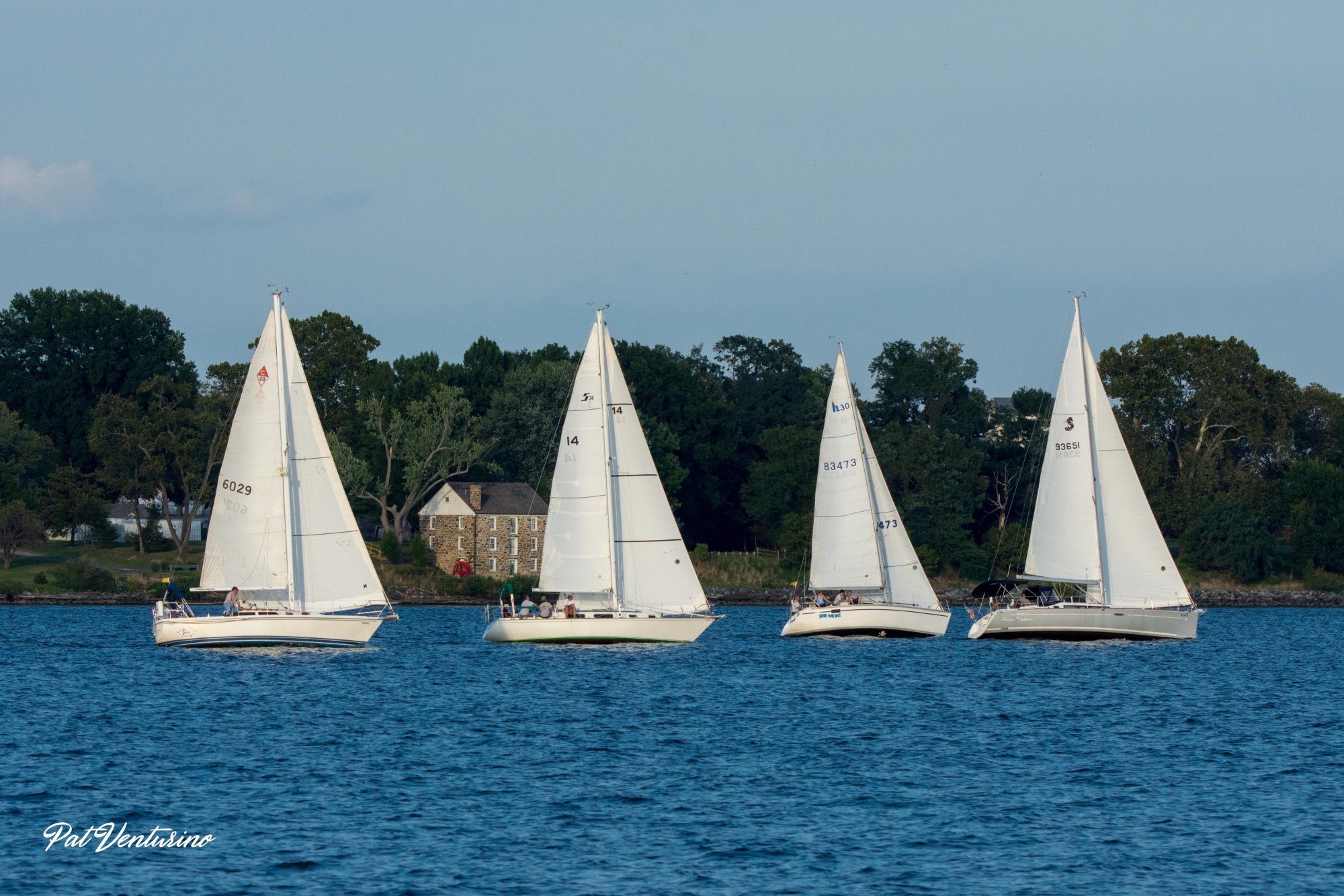

Oh...very nice. Yeah...mine is roughly where the "14" boat has his number. I will send you a before and after pic this weekend...hopefully. Keep in mind that I have to raise my mainsail while in the slip. Hopefully the wind is not too strong Saturday morning.....hahaha.
