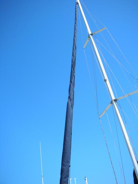

I switched to a Dacron sacrificial strip when I had new sails made on the advice of the sail maker who said the sail would fly much better without the Sunbrella. It did, much better. However, the Dacron only lasted a few years. After I replaced it, I purchased a jib sock from this site. It hoists with the spinnaker halyard. It is a bit of a pain to put on and off, but I don't use it unless the sail will be furled for some time. It was worth every penny. I did modify it so that there is a lacing of shock cord so that the cover does not flog in winds.

I've flown the same genny with both and I'm convinced the sunbrella covers negatively affect performance. My ideal set up is the one described by Rick, a dacron sunband with a jib sock. Here in the land of year round sun you can count on 3-4 years of life for dacron and maybe 6-7 for Sunbrella.
