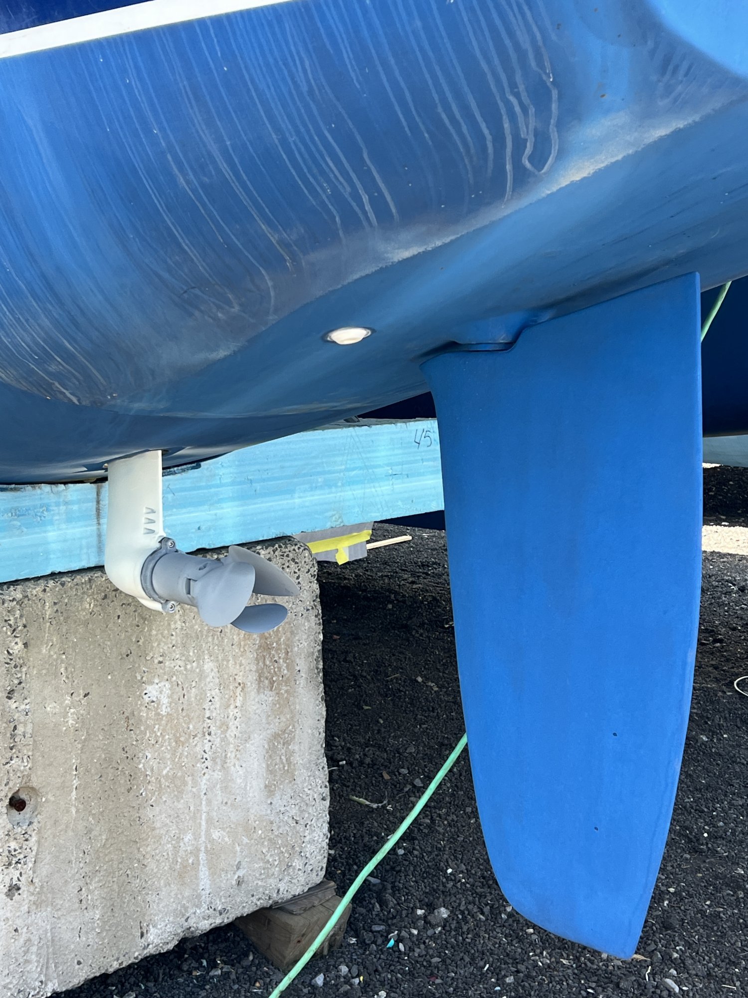

Another issue with saildrives is that they take in raw water for engine cooling through a combination of slots and holes in the drive leg. The makers will boast that this is a feature - because it eliminates the need for another thru-hull. It also pulls water in down lower so there’s no aeration to interfere with water flow, nor is it likely to suck in surface weed. However if you suck in a fish, or weeds, or plastic bags, or anything else that obstructs the interior of the mysterious cavernous interior of the saildrive passageways, there is no easy way to clear the intake. You can’t poke a hanger or cable down the hose to clear it from inside the boat, and if you dive on it the complete pathway isn’t accessible from underneath in the water.

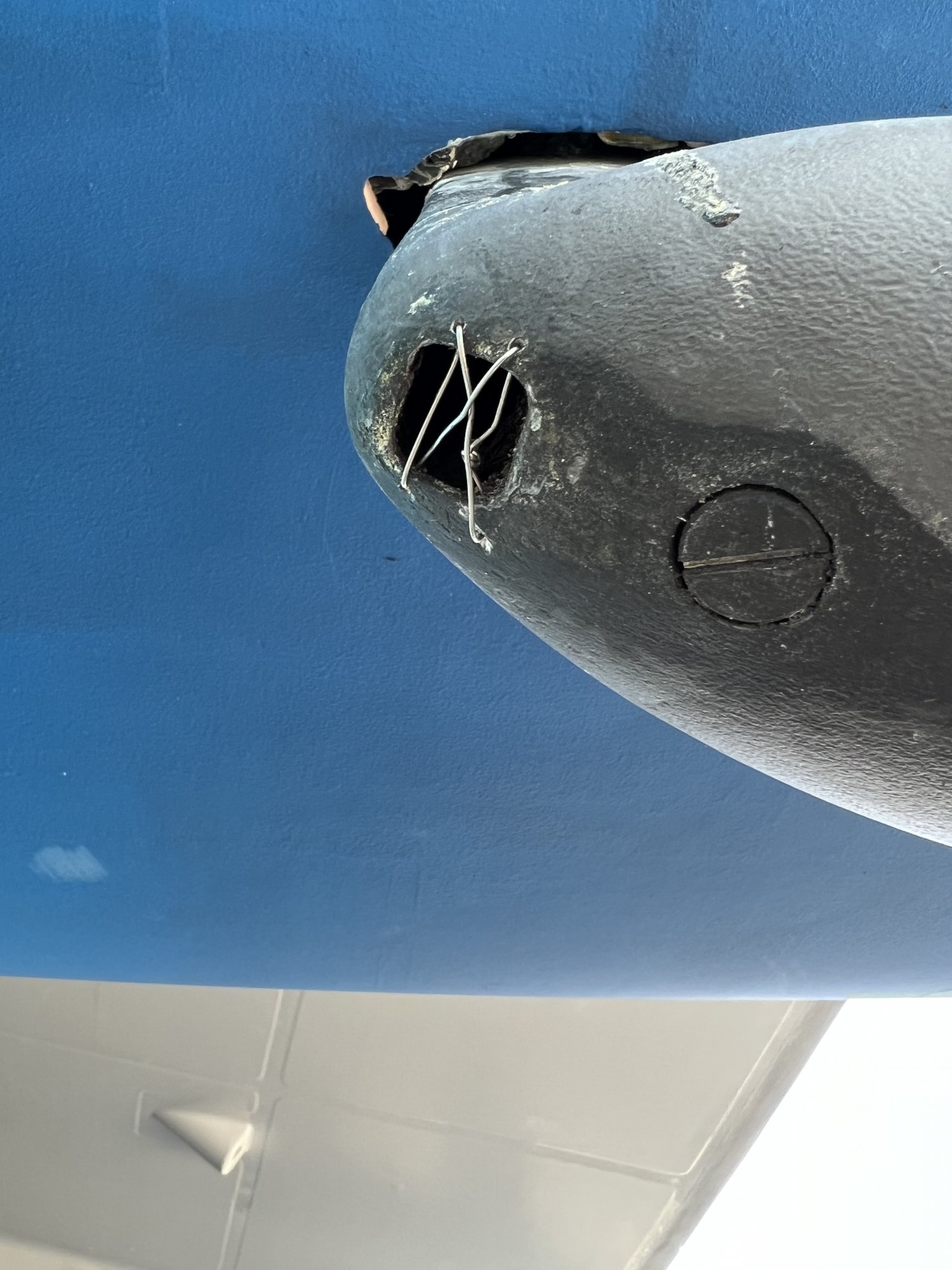

One thing I did was to drill four 1/16” holes around the main intake at the bottom of the drive, and threaded it with stainless seizing wire to block larger objects from getting sucked in. (Picture below). After I took the picture I coated it with spray-on aluminum primer and bottom paint.

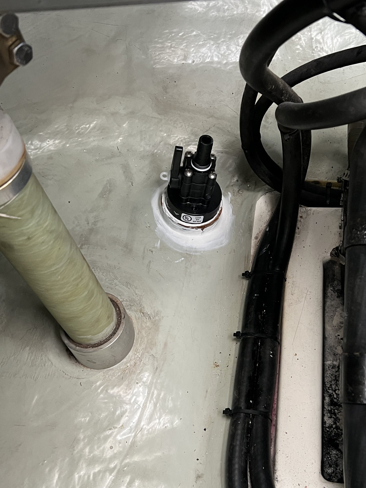

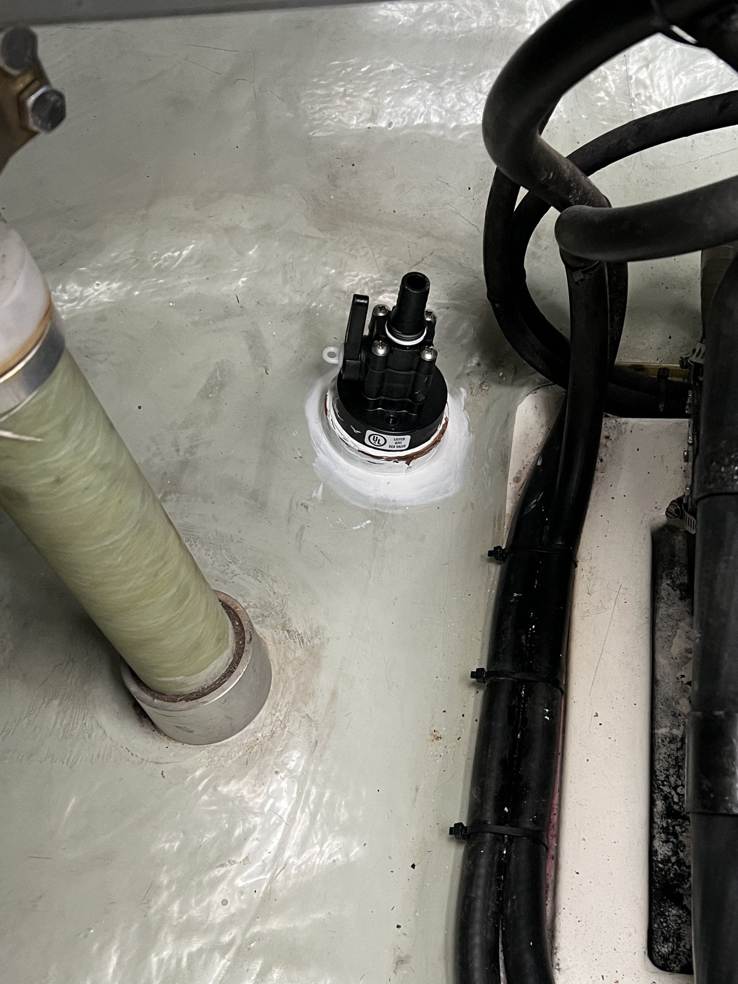

The other thing I did was to add an extra thru-hull in the engine compartment that will not be used except in emergency, if one of my saildrives gets blocked. The intake hose would be diverted from the top of the saildrive to the spare thru-hull.
I'm just not comfortable with the SS wire through the aluminum body. Seeing as you now have a sensible, reliable thru-hull, why not use it full time and remove the SS wire and forget it. Another source of possible galvanic corrosion removed.

But I looked again at a galvanic scale table and decided to remove the wire intake “screens”. I’ll try using some heavy monofilament fishing line instead.

I think all made by ZF..I don’t think that hole in the bottom is a water intake..
Not sure about OEM. There are differences between different models and makes but they’re all fundamentally similar. The hole in the bottom is definitely an intake.

Last week I was seeing white smoke/steam from one of my engines. Various spot checks on the engine block and exhaust riser with the IR thermometer showed it was operating within normal ranges, only a few degrees hotter than the engine on the other side, and the exhaust seemed to have good flow, yet the water coming from the exhaust was MUCH hotter than the other engine’s exhaust flow. I shut down that engine and didn’t use it again until a few days later when I needed it to maneuver into a marina service bay.
The mechanic I consulted ran various checks under load at the dock, and suggested I move the intake hose to the backup sea cock as a test. It resolved the issue.
With a partially obstructed saildive intake, having the ability to run the boat without it saved me an undetermined amount of yard labor to troubleshoot an engine cooling issue that wasn’t in the engine. I can only imagine the bills trying to find the blockage in the engine - and cooling system disassembly before the last-resort of hauling out.
I can correct the blockage at my home marina when I do scheduled haulout and other maintenance. No disrupted trip nor urgent haul-outs in unfamiliar places.
I highly recommend adding an intake at your next scheduled haul out.
PS- the mechanic said he’s never seen anyone do that before, but it’s a good idea. He said he’s going to start recommending it to saildrive and I/O powerboat owners
