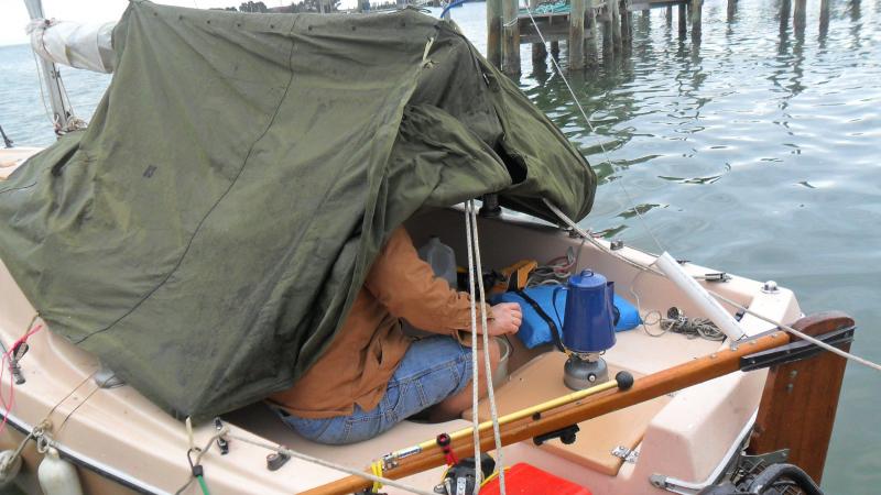

But in the meantime.... here is a picture of my boom tent. It is a two-part tent that I got from a military surplus store. The apex of the tent is snapped together over the boom. This pic was taken at Ocracoke Island.
I know there have been a lot of posts about mosquito netting designs. Mine have always failed at some point and the cabin fills with the little buggars... so I just use the netting like a big blanket and wrap myself in the netting and use it like a blanket. If it is hot out... I don't even use a sleeping bag, just the netting. I wear a baseball cap and the bill of the hat keeps the netting off of my face.
P.S., that was my previous boat (A Mac 22).

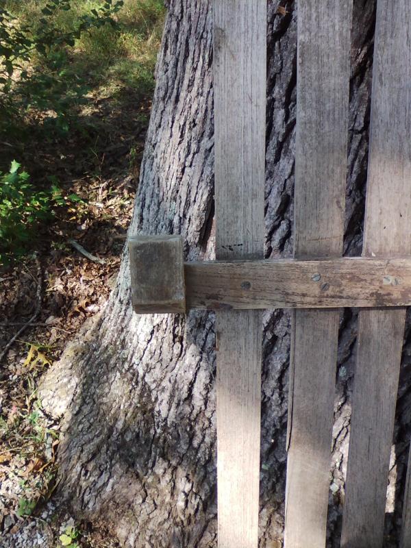

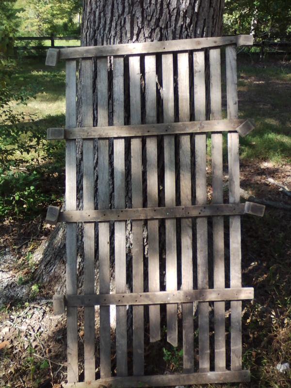

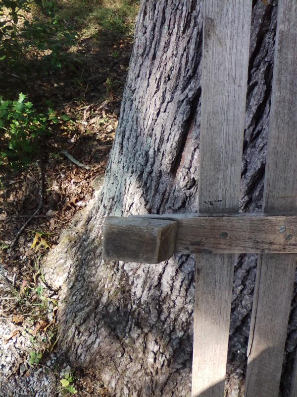

Here are the pictures of the cockpit grating. I zoomed in on the dog ears. You turn these in when you want the grating to sit on the cockpit sole and you turn the ears out when you want the grating to span the foot well of the cockpit.
This one came out of a Rhodes 22 that I'm fixing up. I plan to use this as a template and build my new one out of Trex.
