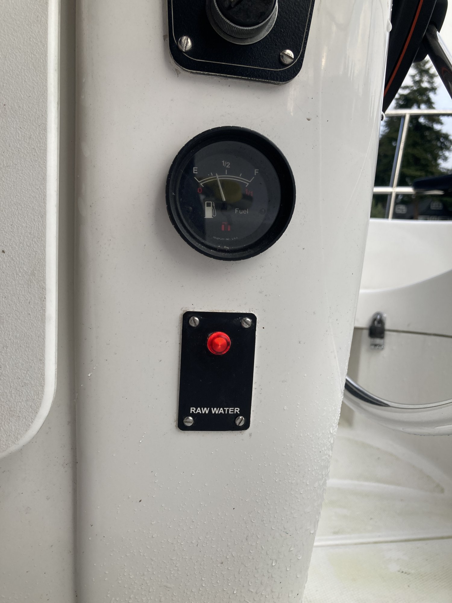

Only one thing to do ....................
Had a number of close calls where one of the crew grabbed the ignition key which was looped around the engine thru-hull but forgot to open said thru-hull because we just "had" to get going. Several other situations occurred over the years but someone always managed to catch it before any damage was done. Just plain lucky, I guess. Biggest problem of all is that the exhaust is a few inches below the water line. No indication if the water is flowing or not.
You're going to hear an assortment of the whackiest solutions to this problem but all they tell you is that your engine "has been running" without cooling water and you are now up "Schitt's Creek" without a paddle. Invest <$100.00 on a flow detector and you'll know instantly when water stops flowing and before problems start.

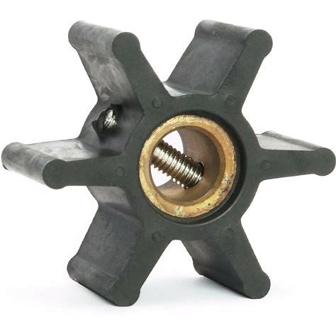

My impeller has a stainless steel screw in the center that fits into a notch in the pump shaft. I once had a brand new, fresh out of the box, impeller that failed at the insert in the center with the screw. The rubber just spun around the insert. You couldn't tell be holding it, the insert was spinning but the rubber blades just stayed in place.
I'm telling you this story because it was the "sound" of the water coming out of the back of the boat that gave it away. It just didn't sound right and given that the exhaust in underwater there is no way to tell, except sound.

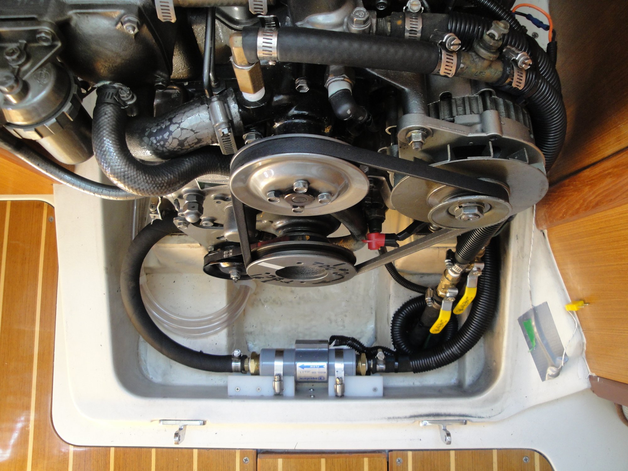

This engine is fresh-water cooled, as you can see the heat exchanger in the photo. The OP needs to also open up and inspect the heat exchanger.
Confused. Wish to avoid confusion.
Fresh water cooled 2GM is a rare animal indeed. The original post (to whom I intended to direct my comments) does not provide a photo. I did not see one from you either.
Is the 2GM original post (post # 1) motor raw water cooled?

Yanmar model number should indicate whether or not is is fresh water cooled. Such as 2GM20F (where “F” indicates fresh water cooling). But raw water still pumps through exhaust mixing elbow.

Sorry, I missed that the photo above was not from the OP...
