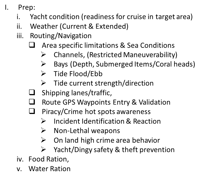

I am going to have my 2nd talk in NYC about the most important (IMHO) subject of sailing and cruising: SAFETY!!!
So if you have any plans to spend time on the water... It is very important for you to have a good understanding of safety while sailing.
There are two questions I get asked all the time: ...
1) How much does it cost to sail...
2) Aren't you afraid of Pirates, Storms, Fire, Equipment failures...
This talk will give you answers to the second question and will make your sailing adventures much safer as you gain knowledge and understanding that is based on my 30+ years of building and sailing SY Aliza around the world.
Remember, safety is about coming back from your sailing adventure and having great stories to tell... The other alternative (Unsafe sailing) is not really fun and can cost someone their life.
https://www.facebook.com/events/1754230797935720/

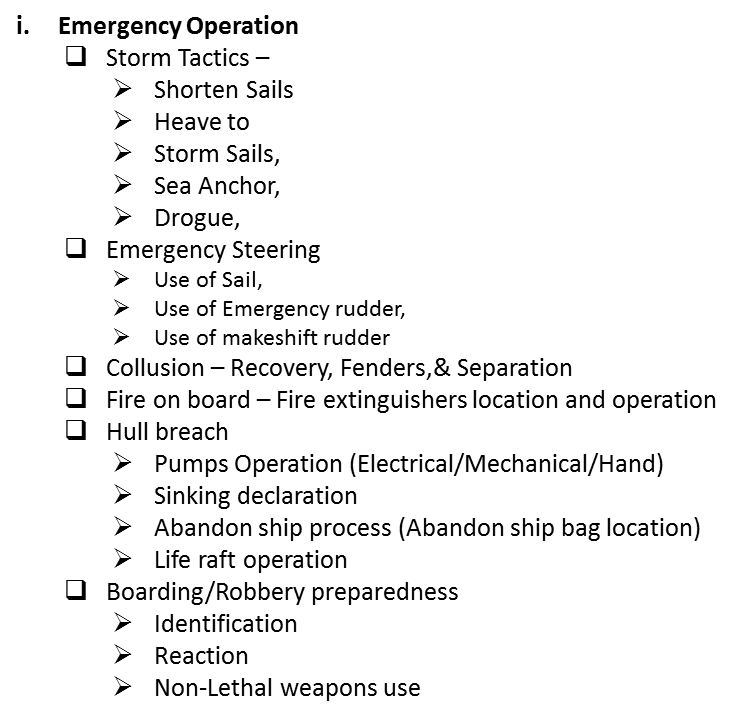

I prepared my thoughts on the subject and wanted to share it with this group and get feedback on the list and potentially get your thoughts on the subject. Please feel free to provide constructive feedback or better yet come to the meeting and contribute ;-)

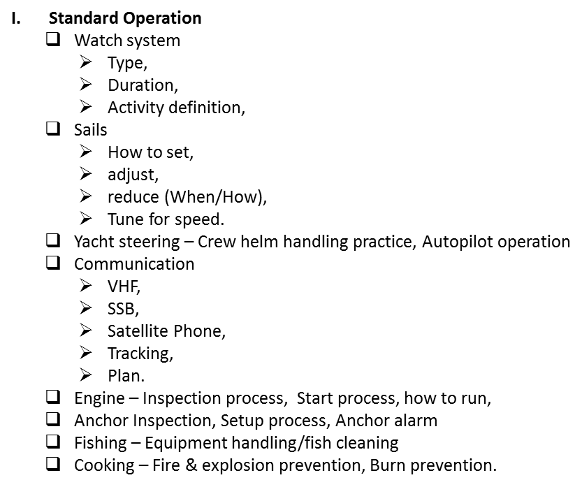

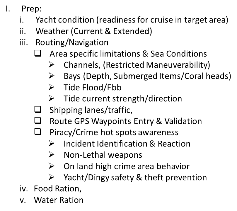

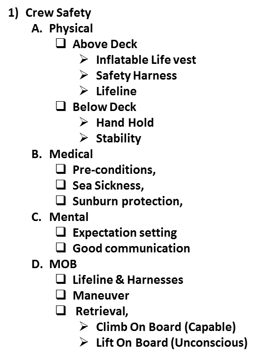

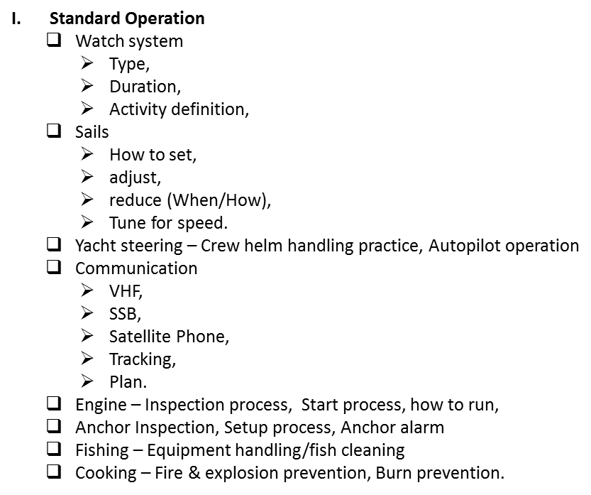

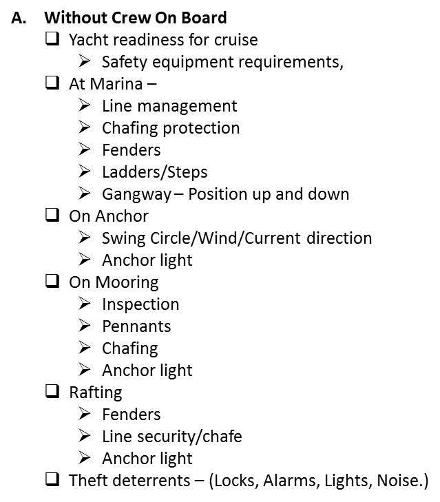

Hello John, Thank you for the input.
Indeed all of the points you made are very important and have potential for major impact on safety. My talk was 2 hours long and covered all of them under the Communication (For the AIS, DSC, EPIRB, or PLB) and Under the Watch (For Radar and AIS) and there are many other things that are included on the next level.
I will try to include a PDF file that lists (in red) the next level which was covered in my talk. Feel free to provide any additional feedback.

Yacht Safety:
Under Emergency Operation
Storm Tactics--need to review other active approaches--e.g., lying a hull, running under bare poles or minimum sail, fore-reaching under storm jib and deeply reefed mainsail, or trysail, etc.
Emergency Steering--subdivide as to what type of emergency. Your remedies are for the loss of rudder function only. For loss of steering due to quadrant cable failure or similar, then 1) activate autopilot if there is one attached directly to the rudder post (hydraulic); 2) attach emergency tiller; one should be on board.
Crew Safety
Medical--include passive dehydration and hypothermia as risks; how to avoid. Also, need aboard remedies to common ailments--such as cold/flu & food allergies (e.g., cough suppressant, decongestants, analgesics, epinephrine, etc.)

A factor which we found helpful, including for crew confidence, was actually practicing some of the emergency procedures, such as Man Overboard and retrieval, emergency tiller installation (also helps make sure you have all the parts, and know how to use it. Include also steering the boat with the emergency tiller, so you understand the importance of a block system to hold it! We actually experienced a steering failure at the start of a passage a few years ago. While part of teh crew implemented the emergency tiller, others diagnosed the problem - which turned out to be a loose set screw! But, one of the things we learned, and KG alluded to it above, was that, as it turned out, our autopilot was still functional in this failure mode. We didn't realize it at the time, but we discovered it later. So, just being aware that that could be a possibility is worth mentioning.
Deployment of drogues and sea anchors. If possible, attend live demonstrations of life raft deployment and setting off flares. All of this stuff may seem easy, but actually doing it, without ever having done it before, on the actual boat you will be sailing, can really be an eye opening experience. I'm sure your presentation also emphasizes actually using your harness, and not being casual about it.

Thanks for your feedback. Indeed all of these are great suggestions and I implement a few as Crew Confidence building exercises. It works well as it builds teamwork, gives confidence and also provides knowhow.
