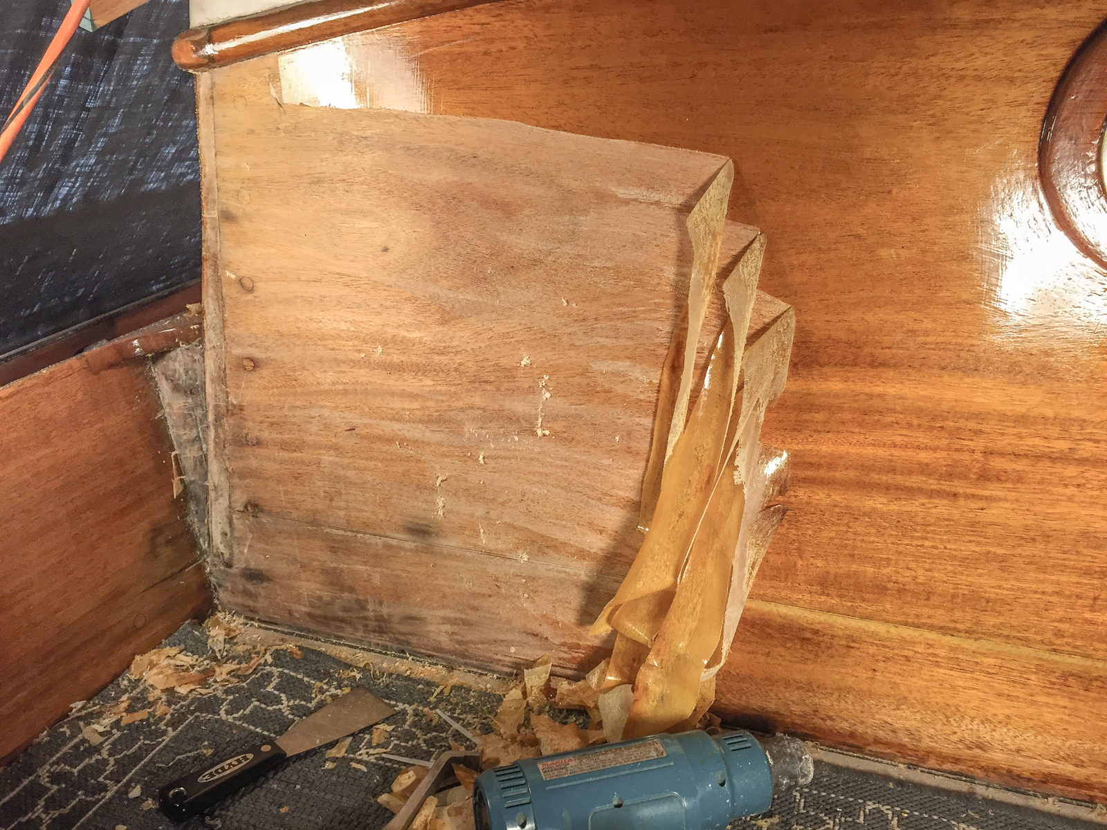

I think the easiest-fastest-cleanest - and safest way - is with a heat gun and a stiff, not too sharp, push scraper.
Be careful around your gelcoat. Use a low setting and put a couple layers of painters tape on the gelcoat to give it extra protection from over heating (if the tape curls, you're too hot).
Then I like to use sharp pull scrapers of various sizes and shapes, to clean up the last of it. Be careful with scrapers, you can do a lot of damage if you're not used to them.
The thicker the varnish is, the easier it comes off with a heat gun. Some use a light chemical stripper after this but I usually sand lightly, with a flat block. Sometimes some areas I'll use a RO sander, but very carefully so as to make the surface flatter than I found it. This is easy!
The most difficult way to remove varnish is by sanding. It's also the easiest way to damage, cup, dish, etc. the wood.
