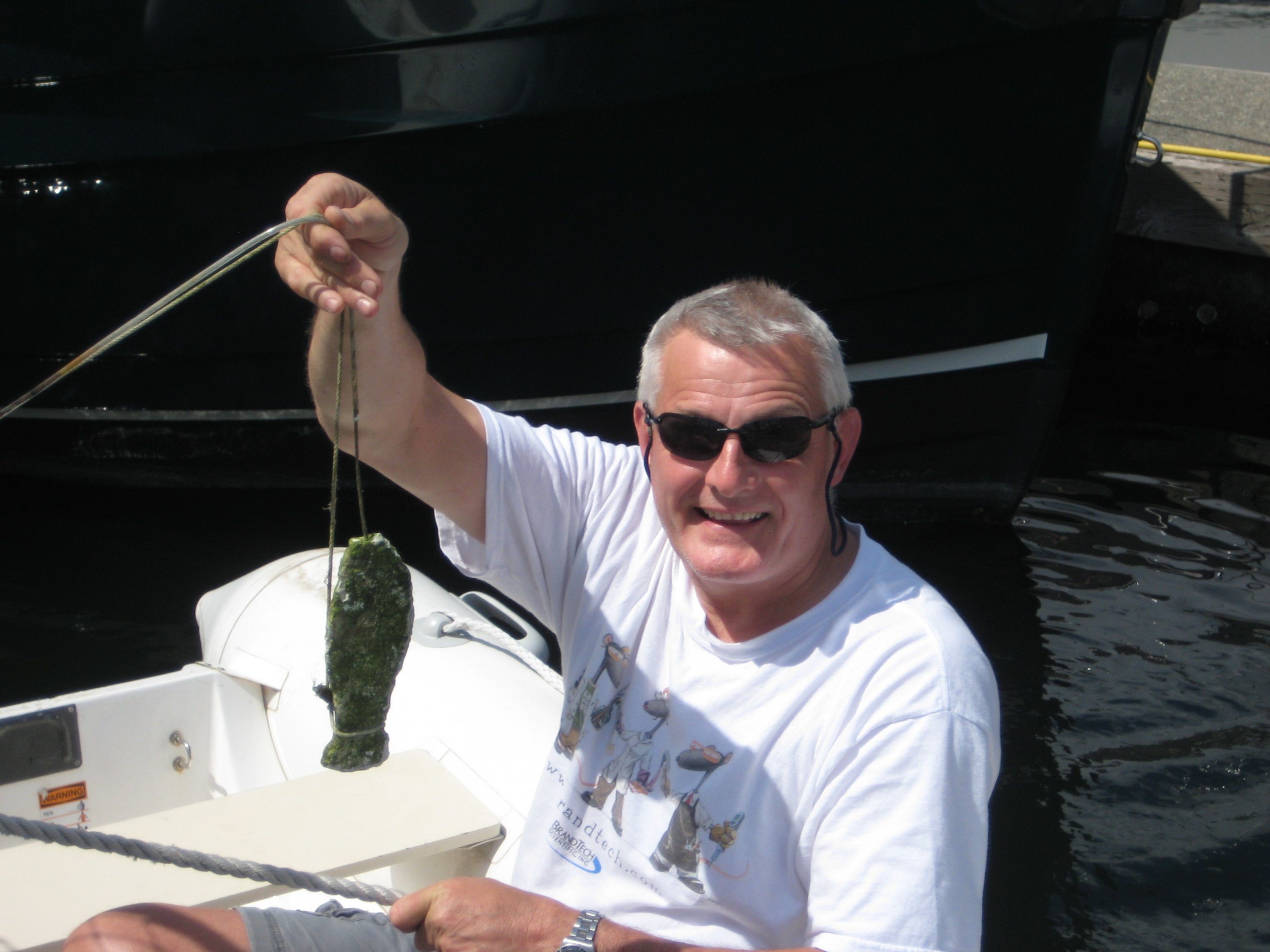

I have an 1991 Beneteau Oceanis 370. It only has a zinc plug that attaches to the end of the prop. I also have a zinc fish that when I moor it while not in use I lowered t he fish over the side. The zinc fish takes most of the corrosion and I can always replace the zinc fish without a haul out or diver. This has worked GREAT for the last 14 years I have own the boat. See picture so far 8 years with this fish
