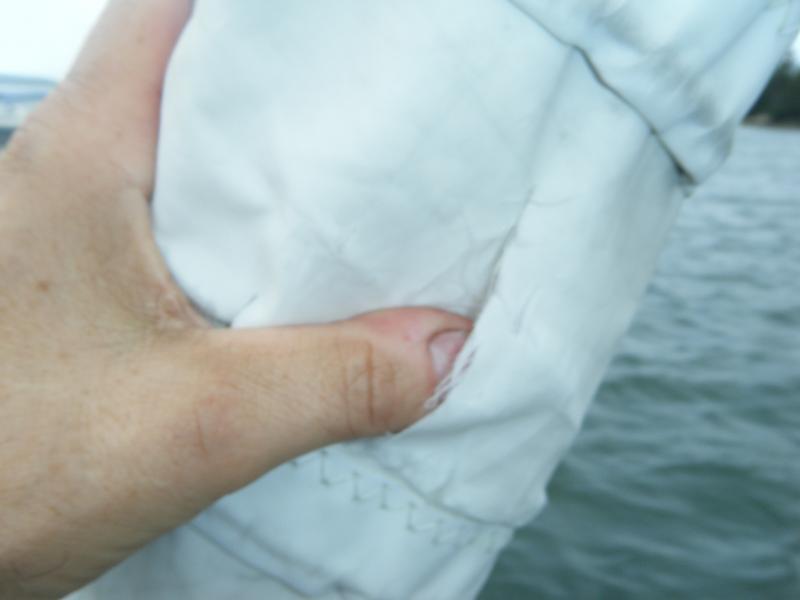

Got a first look at a potential boat yesterday and saw that a headsail on a furler that had a number of rips in the cloth that remains exposed to the sun.
I was wonder, is this sacrifical cloth and if so any guesses at cost to redo this cloth on a 110 headsail with a 30 foot luff.

If that's the "UV resistant" or sacrificial part your thumb is probing, yes, it can be redone. Sorry, no idea what it would cost.

What youre looking at is probably light weight 'insignia cloth' that has become UV burned. Insignia cloth sun covers usually only last a few years before the adhesive backing comes loose and the cloth degrades.
If you have or access to a heavy duty sewing machine, you can easily replace it yourself .... just press the pre-glued panels down and sew across the seams/edges.
