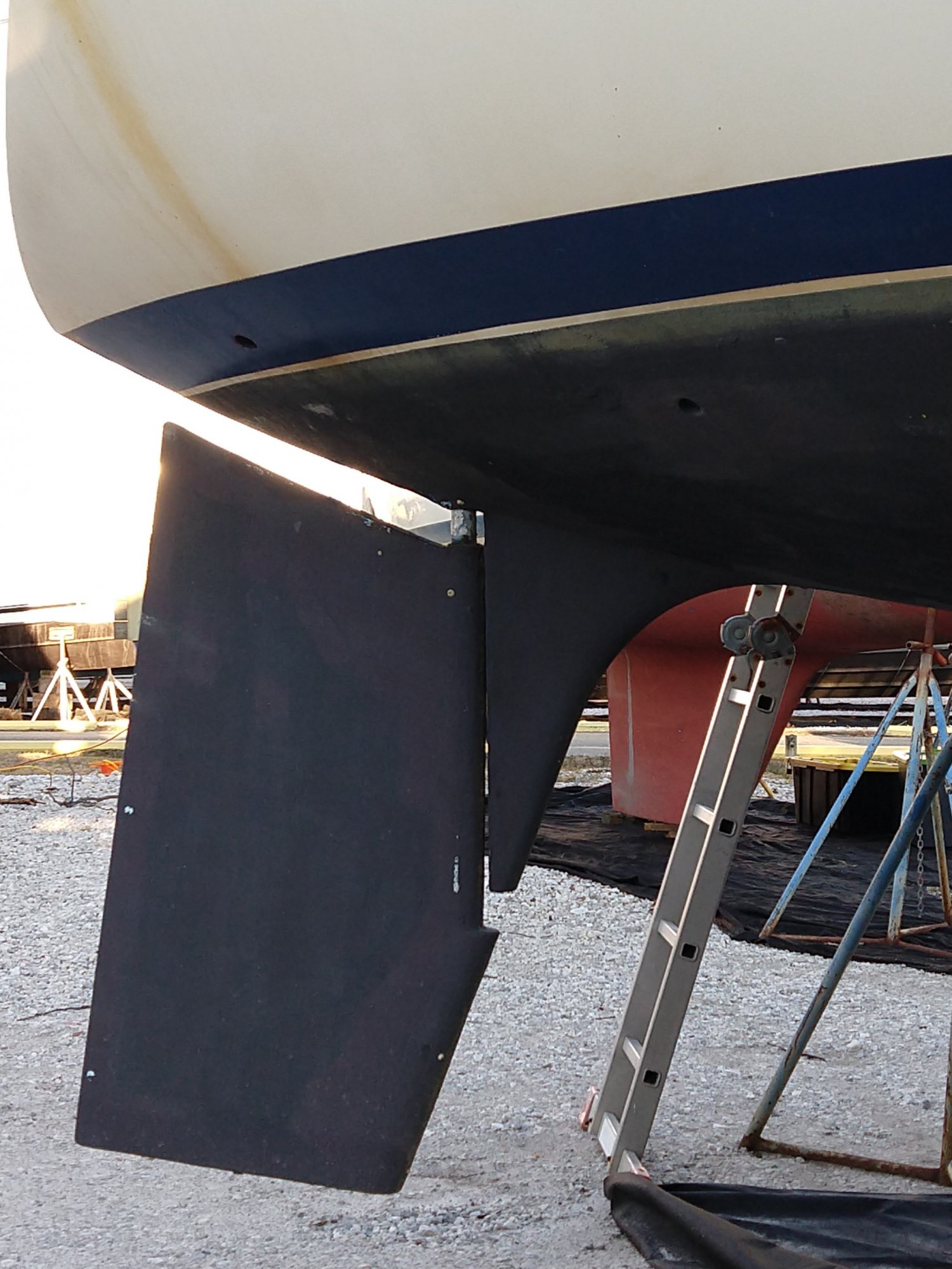

I'm attaching a photo of the rudder on our vessel. (This photo was sent to me this week and I haven't been up to the boat to inspect, but am trying to gather information as I will head up there later this week.) It appears to be hanging a bit lower than designed--Yes? No? Problem? Looking for others' experience and knowledge. Thanks in advance.

I agree… looks like it needs to go up a few inches. Have you tried lifting it... a bottle jack on a solid platform would be handy for that.

Probably a thrust bearing that has slipped. Most likely accessible through the lazarette hatches.. As Joe says, ya probably can jack it a bit and then look at the bearing and relocate it then tighten it.. Might be good to have someone in the laz while ya wiggle it and lift it to make sure that the bearing and its support is OK too.

If it's anything like an 8.0C there is a 2X6 piece of lumber that runs athwart-ship just above the steering sector. Where it passes through this support there is a bushing and above that a pin that goes through the rudder stock. Just guessing the pin has come out and the rudder is being held in by the steering sector that is probably rubbing on the hull.

Thank you, all! This is all very helpful as I plan the weekend's work.
