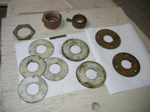

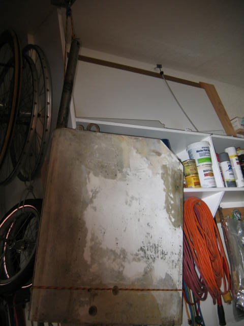

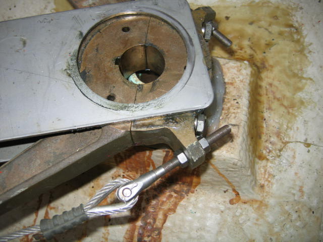

Once you remove the top sleeve from the shaft and the 2X6 you will see how it comes apart much better. The only bearings are plastic sleeves. Remove the 3 screws that are vertical through the steering sector before you loosen the bolts that hold the halves together. Once you loosen the bolts the shaft will slide out. I put a jack under the rudder on the outside and had someone lower the rudder. My rudder came right out through the dry packing. I'm hoping I remember where to put all the Teflon washers when I reassemble. Here are pictures of the parts.

1) rudder hanging in garage 2) steering sector resting on packing gland 3) the parts minus the vertical screws and bolts holding the 2X6
