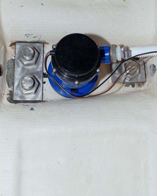

Why are they so heavy? Heavy construction. Four years ago I installed new seacocks in the head. When I pulled the core plug out of my hole saw I was amazed. I pulled out my calipers & measured it at 3/4 of an inch thick. This through hull was quite a distance from the keel, where you'd expect a layup thickness like that.

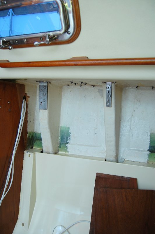

The chain plates, all six, affix directly to the hull via massive fiberglass knees. These go from the inward deck flange almost to the waterline. The chain plates are not affixed to the bulkheads, which can rot, a huge plus in my mind.
Solid Glass Chain Plate Knees:

The keel is external lead & through bolted with at least 316 ss bolts but it is rumored they are Aquamet or Nitronic bolts. They use very hefty SS backing plates. As far as I know I have not heard of any CS-36T keels needing re-setting yet.
Keel Bolts at Year 31
Deck hardware was bedded with butyl rubber which has held up amazingly well! Most of the fittings on our boat, including the genny tracks, are still bone dry after nearly 32 years.

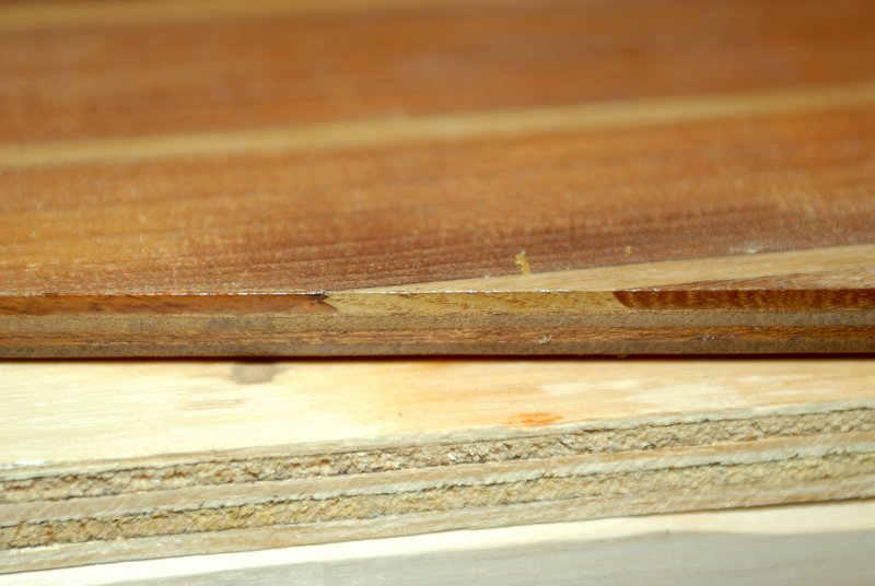

The cabin sole in our boat is a full 3mm veneer. This means you can actually sand and re-finish the cabin sole many, many times and not burn through it. Just for reference a 4X8 sheet of teak and holly with a 3.0 mm veneer will set you back over $1000.00 today. Not even Sabre used teak soles like this. Most other builders use the much less expensive veneer that is about 0.2mm thick and you get perhaps one refinish.
Cabin Sole:
