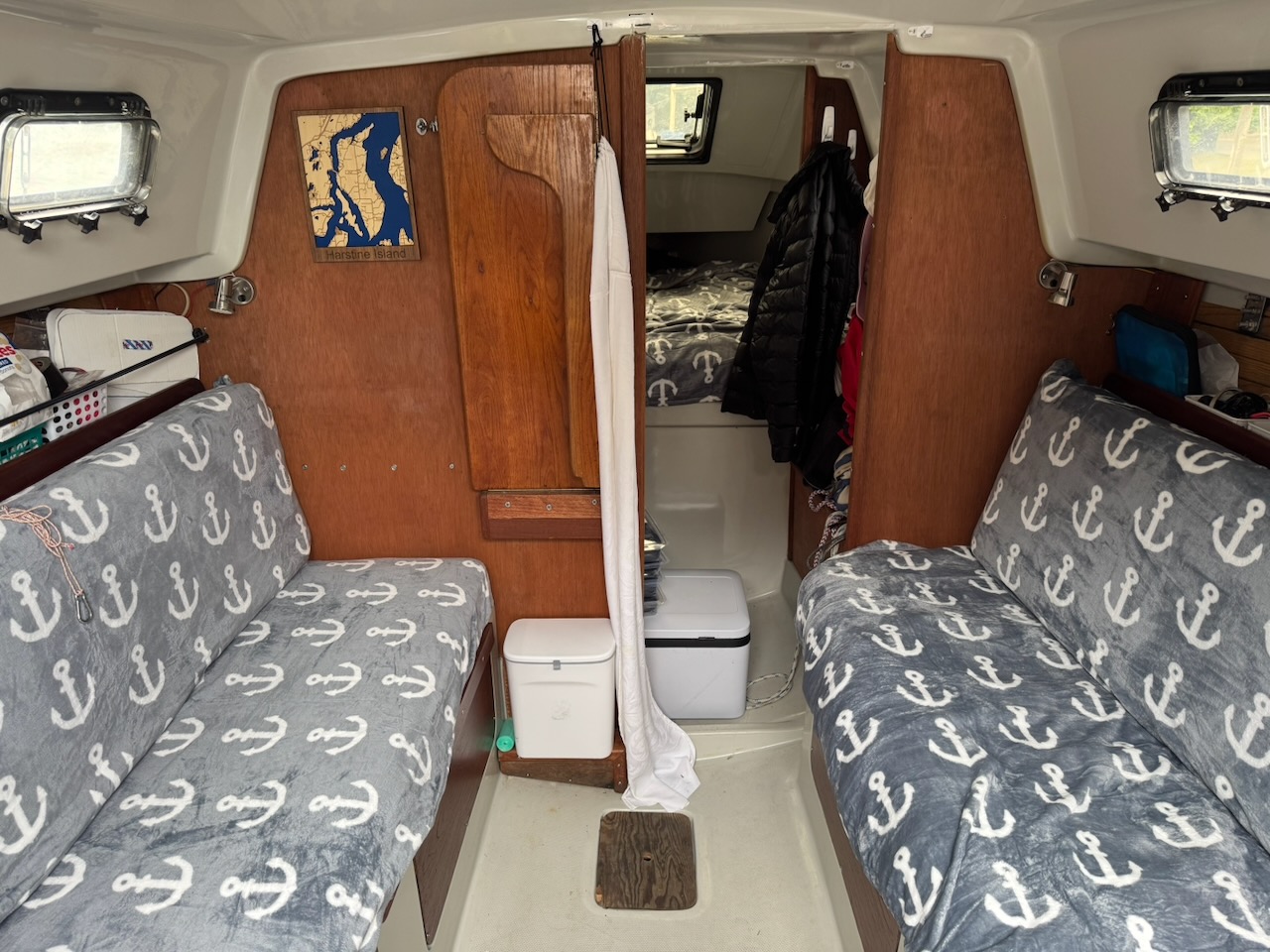

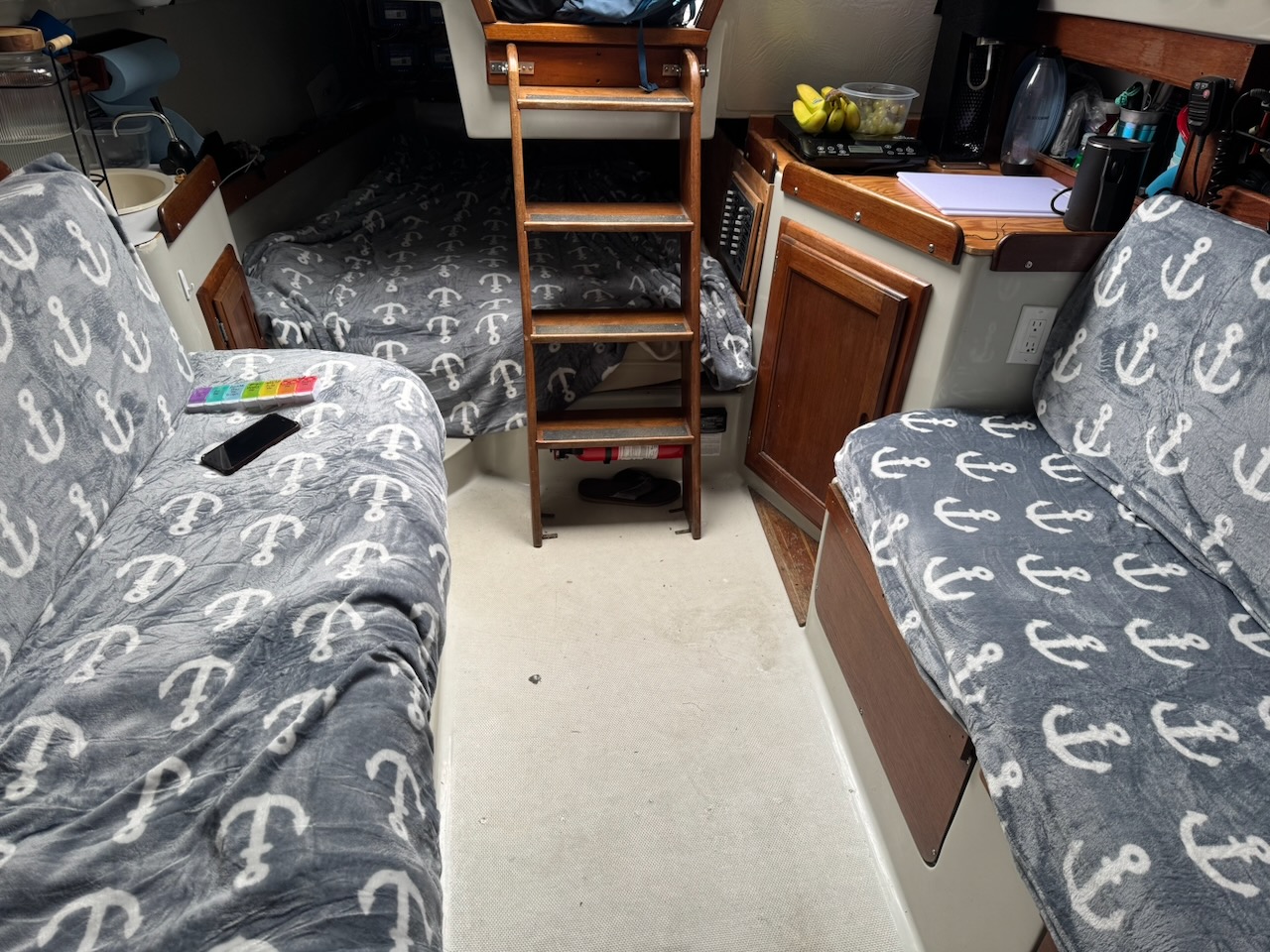

We just launched our new-to-us Raya for the first time, and in so doing, I guess we've joined the ranks of the "Our first cruising boat was a Catalina 22" club. We cruised Breezy for ~12 years, but our kids are now adult-sized; my wife and daughter long shared the C-22's dinette berth, but at 5'8", our daughter was declining boating trips, saying (rightly), "There's no place for me to sleep".
Our criteria for a larger boat was:
  • Still trailerable
  • Bunks to fit all 4 of us
  • 3 H's : 1) Headroom; 2) (enclosed) Head; and 3) (space to install) Heat

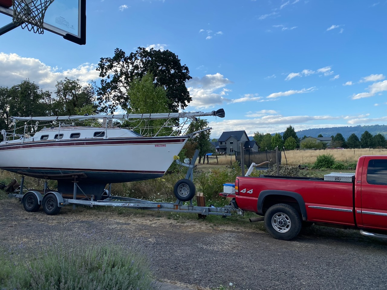

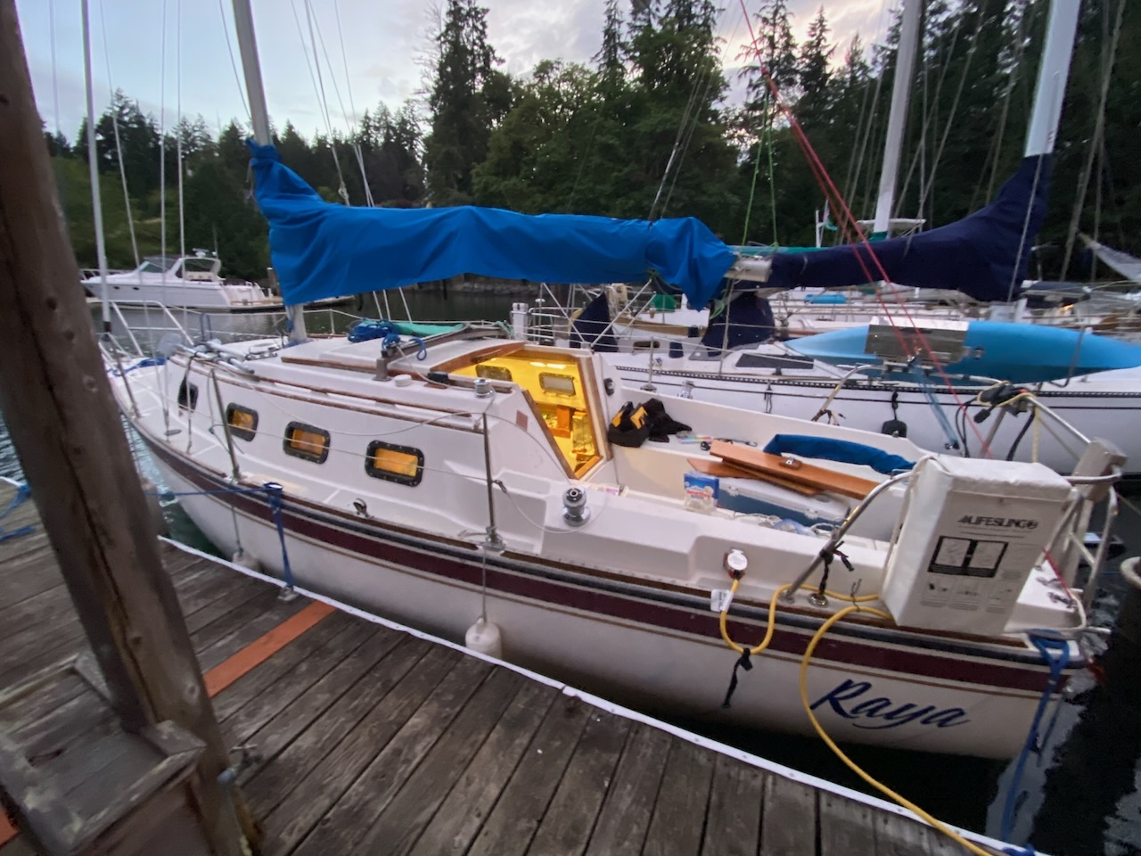

My wife found <name redacted>* last summer in Bremerton. We bought and towed home to Oregon in August. And now she's finally back in her happy place - in salt water (and not leaking!). Moored in her summer slip at Jarrell's Cove Marina.
26' overall, 8'4" beam (almost a foot wider than Breezy, but still road-legal without a wide-load permit); 4400 lbs dry displacement; 3'1" encapsulated keel (See SailboatData)
I wouldn't call our first long-extension ramp launch, "smooth", but we'll take, "successful." (sorry - the lack of pictures goes with the "not entirely smooth" launch)

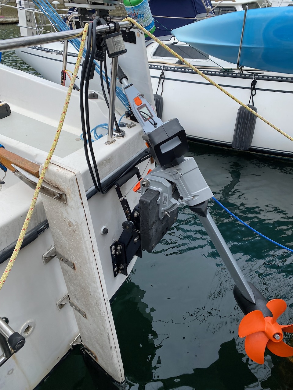

Nearly-silent electric motoring is pretty magical (details and range calculations to follow eventually). And now we have lots of new-to-us experiences: Like: "a sink” or “standing up to change clothes” or “heating tea-water in the cabin” :biggrin:

  • Replaced the trailer jack (that failed as we hitched her up) and trailer brakes (that failed partway home)
  • 20 kWh of propulsion batteries; ~2.5 kWh (200 Ah) of house bank; and 6 MPPT solar controllers
