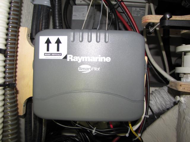

I've got the overall wiring diagram roughed out.
Now I'm looking for a location for the computer.
Here is two possibilities...
paulj :troll:
Dec 25, 2008
1,580
catalina 310 Elk River
I like the idea of keeping it close to the drive motor that way the voltage drop due to excessive cable length will be minimized. Remember Ohms law, as E drops I increases.
This will keep the motor happy. Use a heaver gauge #16 or less, (the largest will fit in the terminals) to power the computer. I may put mine in the lazarette.
I also remember if you use existing cable lengths you don't need to use Ohms Law.
Run those wires from the Com/Nav circut breaker switch on the AC-DC panel to the computer. Now you can use the Ohms thingy.
paulj :troll:
Dec 25, 2008
1,580
The idea is to keep the voltage high. The longer the wire the lower the voltage. This is why they gave you a very short power wire to bring power to the Course Computer. By placing the Course Computer where you plan you will need to replace the power wires with longer ones. Use heavy gauge wire here! Then shorten the wire going to the motor that will keep the voltage up. The length of the wires provided by Raymarine for power transmission is for mounting the Course Computer near the power source. Your plan appears to mount the unit elsewhere.

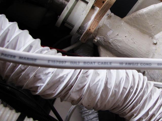

Dec 25, 2008
1,580
Well that will do ya! Normaly they don't use romex for 12v, but it will sure keep the E up!
