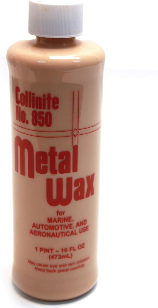

You might take at least one step off of the ladder and see how bad the rust is under it, The lowest step I would think. I use Collinite No. 850 Metal Wax over my stainless for protection and shine.
