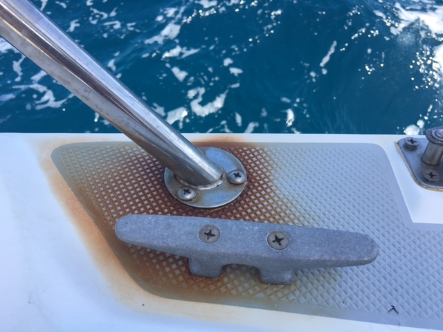

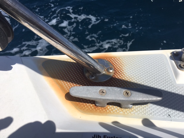

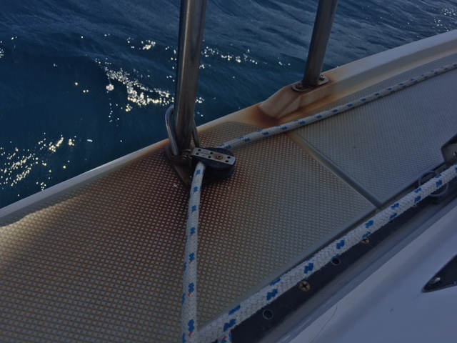

Hello members, I have quite extensive problem with rust showing and discolouring everything around. It's and older (1986) Cat30. After cleaning rusty spots just after 1-2 days at sea they come back and make everything look ugly. Any ideas what is causing this and is there anything I can do to stop this? Thank you for any pointers and advice.
Oct 9, 2008
1,742
Bristol 29.9 Dana Point
Replace the screws. Use marine stainless. They're probably through-bolted so you'll have to find the underside in the cabin or locker.
Also rebed the bases of the stanchions. Use "Bed-it" tape - you can slide it under there without removing the whole pulpit rail. Maybe. Or you may just want to rebed everything anyway.
You may have to polish the undersides of the stanchions if they are rusting too.

It looks like water that gets INSIDE the stainless tubes, even Stainless needs Oxygen to be "clean"
Classic corrosion problem is from the unseen Inside of pipes.
Jim...
PS: just guessing from the circular type stain pattern from around the tubes.

As suggested, examine the stanchions for evidence of rusting inside. Stainless steel is "Stain-Less" not stain free. If it is the stanchions, they may have been a lower grade of stainless when manufactured. Water is intruding. Sitting inside the pipes and rusting them from the inside. You can test the pipes by tapping and squeezing them on the middle to lower third of the pipe. If you squeeze and they collapse you have identified a problem.
More investigation is needed to identify your issue and develop suggestions for resolution.

ALL older Catalinas were manufactured with 304 SS tube to make the Rails and Stanchion tubes. 304 is stronger than 316L but less corrosion resistant. Somewhere you might have a non stainless bolt or screw causing that mess, but also like others have mentioned the tubes can actually rust on the inside.
I wouldn't be surprised if you dismount all that stuff and broken off screw or bolt comes tumbling out the tube, all rusty. You are in Canada, so this looks like a good winter project for the cold months. You'll want to take everything off (its a royal pain that takes two people). Like Skipper said, replace all the screws. Order from a reputable hardware place online so the you know you are getting 316L alloy machine screws & nuts.
There are various chemical cleaners that deal with rust. CLR is one, but not very strong (it used to be stronger). If you know a welder or you live near a welding supply shop try to find a metal cleaner/descaler/degreaser that contains phosphoric acid as the primary ingredient. Don't worry, its just a spray cleaner and won't burn you, just don't get in your eyes or nuthin (same safety precautions as many household cleaners). The stanchions can be soaked in a bucket (you can cut the cleaner with 2/3 hot water). This will clean out all the rust from the inside of the tubes. For the bow rail, you'll have to just spray the inside of the tubes. It would hard to have a vessel deep enough to submerge the whole thing into a solution.
When all that stuff is off your boat it would be a great time to epoxy 'pot' all the mounting holes. This is also a great way to leave them sealed up for the winter while you work on the other stuff. Over-drill all the holes to 5/16", tape them off below and fill the holes with epoxy. Leave them sealed up for the winter, in the spring drill them to 1/4", that leaves you a nice seal of epoxy around the bolts so if water ever gets in it won't harm the wood core.

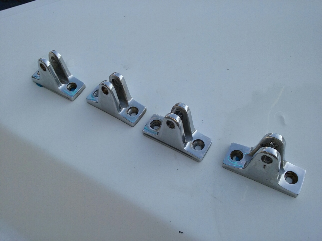

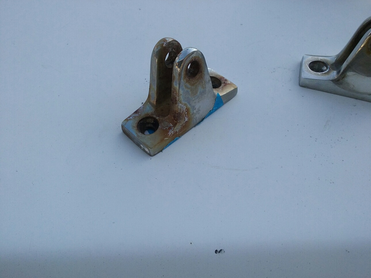

I have tried a lot of different stainless cleaners but Wichinox is the only one I have been happy with. Here are some before and after photos of my dodger bases. I wiped it on with a scrap of terry cloth, waited 20 minutes and hosed it off. It was done in spring and still looks great.

I've seen stains like that when the bedding is leaking and the through bolts are doing the crevice corrosion thing.. When you remove the bolts and find them significantly reduced in diameter, you'll be happy ya changed them and rebedded the whole she-bang..
