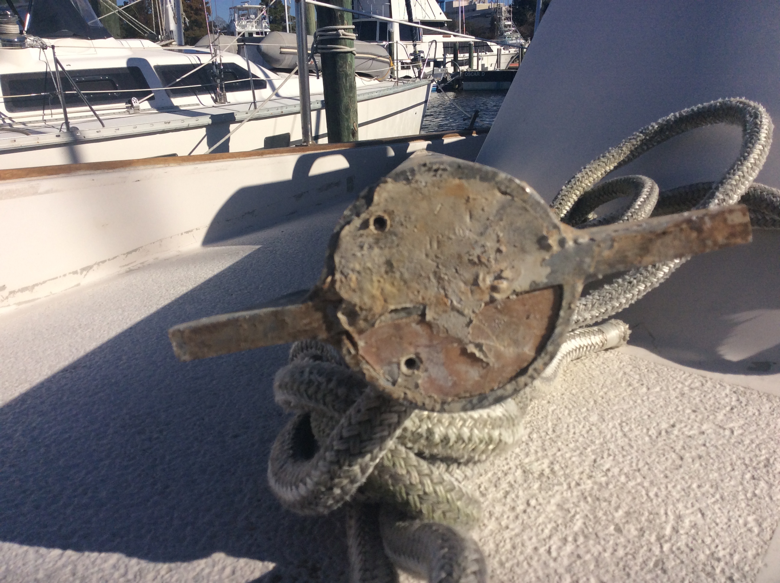

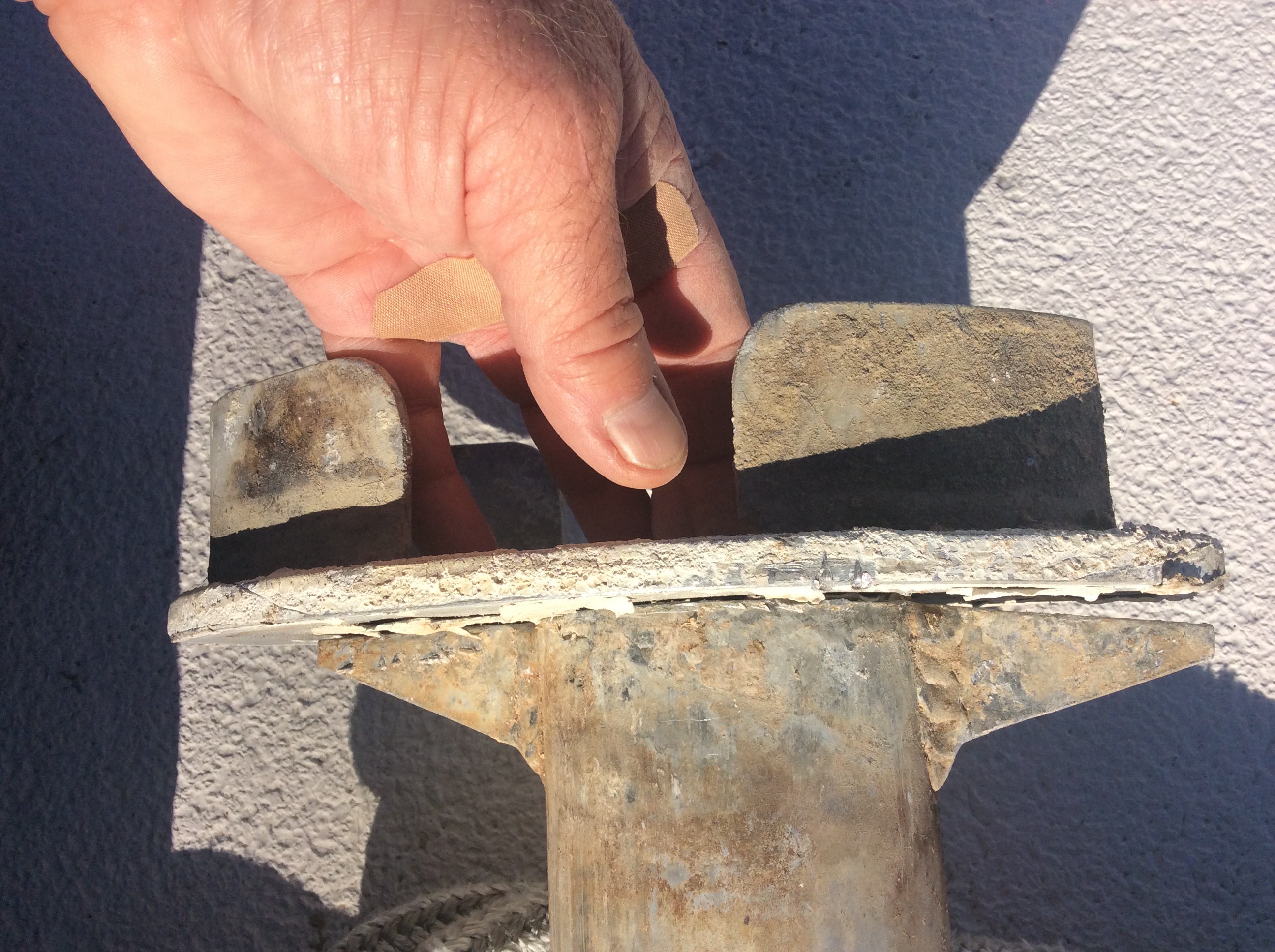

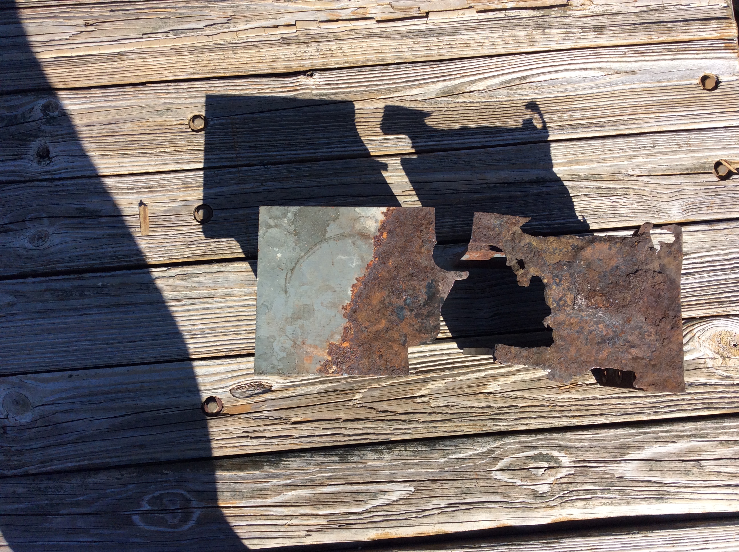

Bought a 1982, 37ft CC MKV ketch in early July. I am currently replacing the steel beam in the bilge that supports the compression post, the post and mast step, surprise! The steel beam was rusted to a fraction of it's original thickness. The post and step are rotten, turning to powder. I am having all these things fabricated.

I am also puzzled by the engineering of the comp post. The hole in the deck seems like a bad idea and the fact that the post support (step?) is bolted to stringers rather than continuing to keel. Any engineering advice regarding whether I should/shouldn't support the compression post from the keel would be nice. I am considering a laminated wooden block under the steel beam.
