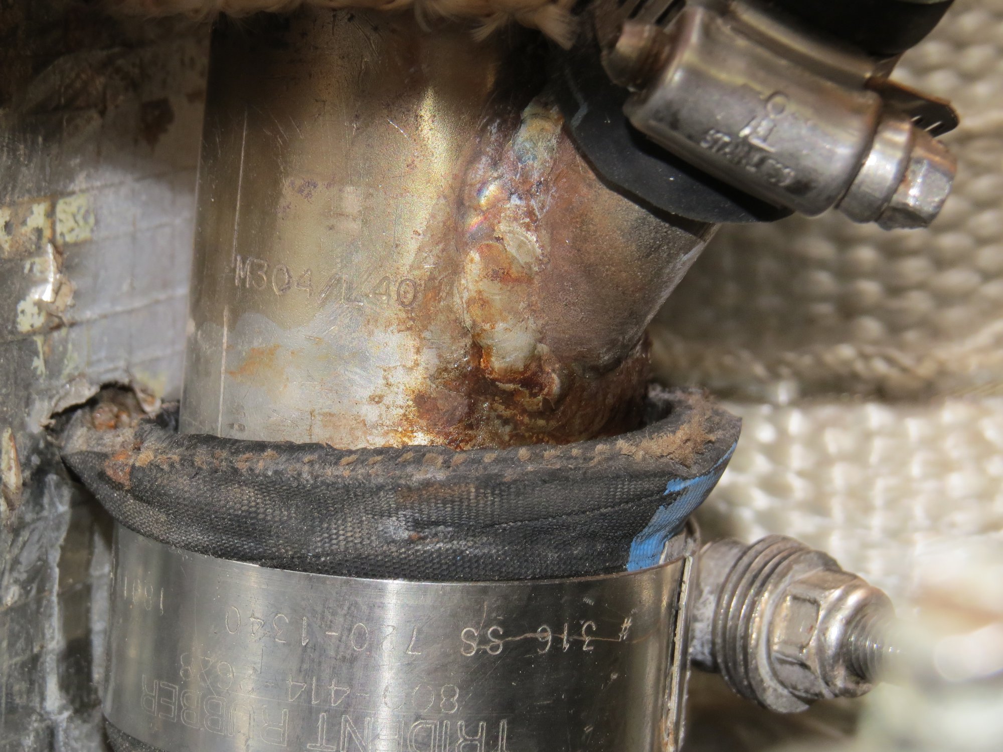

Back in 2019 I had extensive work done on my 2003 Catalina 310, including replacing the exhaust elbow, as the weld connecting the stainless steel cooling water pipe to the cast iron elbow had cracked. I had a new elbow/pipe assembly made up entirely of stainless steel. Now the weld at its lower portion is starting to deteriorate. What should I do. Have it made over again? Cover it with high temperature expoxy putty? Remove the elbow when the boat is hauled and have a muffler shop re-weld it. Awaiting all suggestions

Let me preface with I know nothing about welding. This little bit of information below might mean the elbow wasn't welded together correctly in the first place. I defer to the experts
Does welded stainless steel rust?
Under normal conditions, stainless steel withstands corrosions of all kinds. However, in extreme circumstances, stainless steel can rust. This occurs when the chromium oxide layer – the very element that protects stainless from rusting – is destroyed or removed. Sometimes this can happen during welding, either during heating or cooling process.
Even with TIG welding, rust can be one of the biggest challenges of welding with stainless steel. That’s why cleaning and prepping your stainless before you start is so important. With a properly cleaned and prepped piece of stainless steel, the chromium oxide inside acts as a protective seal against rust during the welding process. It can help the stainless heal itself from discoloration and permanent marks

Another thing to consider is the location of the weld. The elbow is subject to considerable heat from the exhaust. The pipe, on the other hand is cooled by the seawater. This means that the two pieces will expand and contract to different degrees, resulting in further stress on the weld. This is a potential problem spot no matter how carefully the weld is done, and should be inspected regularly by the owner, as well as the yard. The original equipment involved welding stainless steel to cast iron; two metals that expand at different rates, resulting in further stress on a weld that is weaker to begin with. The whole assembly was covered with insulation, making inspection difficult. I remember seeing rust spots on the insulation, as well as on nearby screws and fittings, progressing over 2 years until the weld just broke apart. It must have deteriorated progressively over time until said failure

Remember, it is stainLESS steel, not stainPROOF steel. It will still rust, especially the lower grades, like 304/18-8.
316 would undoubtedly last longer, and you can get 316 pipe and fittings pretty easily. Heavier schedule pipe would help, too.

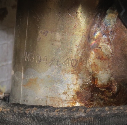

Well, to start off, that weld would never pass a QC inspection when new! There appears to be incomplete fusion in the area of the heavy rust and significant undercut there too. I probably wouldn't have accepted that weld on my anything I paid someone to weld. The pooling of the weld deposited material is not "wavy" like a good weld would be and looks more like "dabs" of weld material applied.

Good call. Looks like it was done by an amateur. Probably not cleaned and prepped properly either, which takes me back to that article I posted.

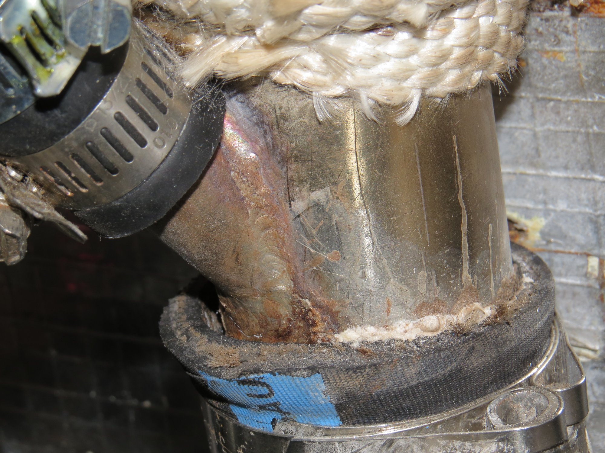

Well thank you everyone. I am posting another photo of the same fitting. At the lower right you can see salt deposits left over from water that was seeping out from the rusted part of the weld, and then boiled off by the heat.

Weld filler material flow is a little better on the middle of the weld on that side but still overall a Butt-Ugly weld that looks like it was done by a shop student still learning to weld. :poop:
:plus:
Welding stainless is not as bad as aluminum. It takes a bit of skill.
Projects that I have had welding done included cleaning up the weld by grinding the excess weld to smooth, and then passivation, as mentioned by @Ken13559. It is not really bluing, it is a process of removing the free iron particles from the surface of the work. (" In stainless steel, the passivation process uses nitric acid or citric acid to remove free iron from the surface. The chemical treatment leads to a protective oxide layer that is less likely to chemically react with air and cause corrosion.")
The fact is stainless is just that Less rust staining. As Dave states the lower grades are more likely to rust.
Looking at the picture it appears the part is made of 304 stainless not 316.
Both types have their uses. 304 will show rust quicker. 316 may be too brittle for the job of the exhaust elbow. I am not sure. Perhaps one of our metallurgist here can give us the answer.
As Smokey identifies the weld technique is questionable. If done at a muffler shop they likely did not finish the piece to get the iron dust in the shop off the piece before you put it into the boat.

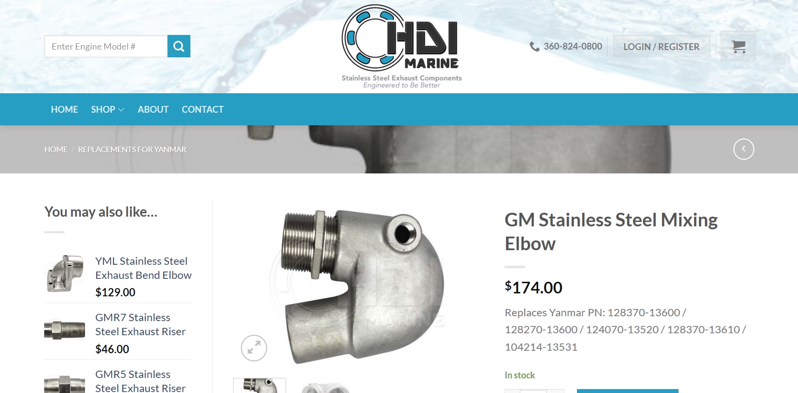

Question for y'all about the stainless steel mixing elbows. Most postings about them say that they're better than the cast iron. A while back, I was talking to our local diesel mechanic, who has worked in our marina for going on 15 years. He said that he didn't care for the stainless elbows because it was harder to get them screwed down properly so that they wouldn't leak. Presumably because they're made from harder steel. Any opinions on this?

What does he base that on? Poor machining is all can think. Mine installed perfectly and no leaks. Buy one from a reputable shop. There is one with a storefront on Ebay. I don't have his name but several members have used him.
I think he's referring to the hand made SS tube mixing elbows rather that the HDI Marine cast 316 SS mixing elbows. The HDI cast SS elbows are identical to the Yanmar CI elbows except for the metal. Oh yes, and the price ...... less than 1/2 the price of a CI elbow.
