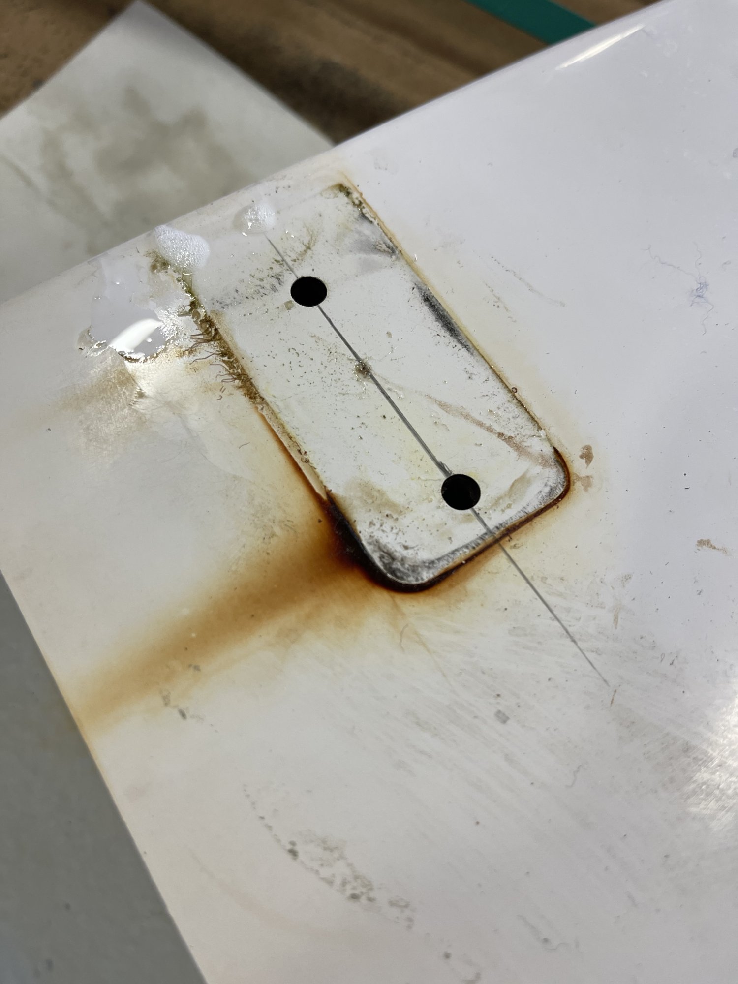

I have a 2022 Capri 22 that was only in the water for a few months in the fall and some (significant?) rust stains formed around the pintles on the rudder. I took the pintles off and it seems like the rust is starting at the pintles themselves. Not sure if I should try to seal them to the rudder with something (no sealant was on them) or if I should try to polish the surfaces of the pintles and or treat them with something to prevent this next season.
Any ideas? Also there was some moisture trapped behind the pintles and in the drill holes when I removed them. I am a little concerned that the foam core is getting water in it.

I think your concern is warranted. There seem to be cracks around the mounting area. Do you have a plan to dry the inside of the rudder? Screws certainly needed to be sealed. I'm at sea about underneath the pintle flange. If those are cracks and you do not choose to repair them, then yes use a sealant like butyl tape. If the area is sound then maybe not.

The photo may look worse then it is, after cleaning up the rust stains it looks fine, no cracks. There is a pencil mark still there from when Catalina drilled the holes. That may be what you are mistaking for a crack. I may just try to run a vacuum hose at the holes for alittle bit to remove some moisture. Then I think I am going to sand/polish the pintles because they seem to have some rough edges from the cutting or stamping process when they were made. finally I think that I will seal everything with 4200 and I think that may make a big improvement. Upon further inspection I think the rough surfaces are causing the rust to start to form.

That crack looked like a pencil mark to me too.
