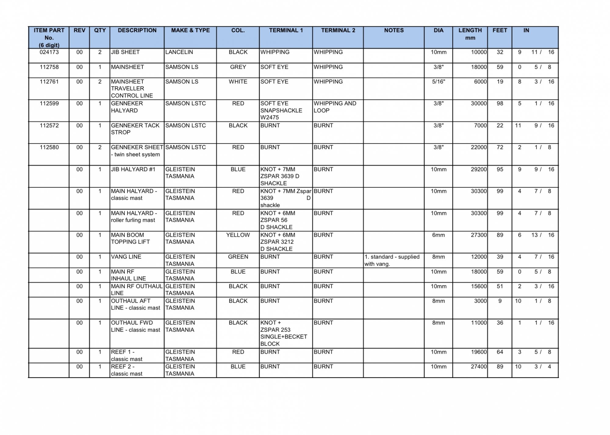

I posted this before… this is the entire list for the Bene 323:
I
