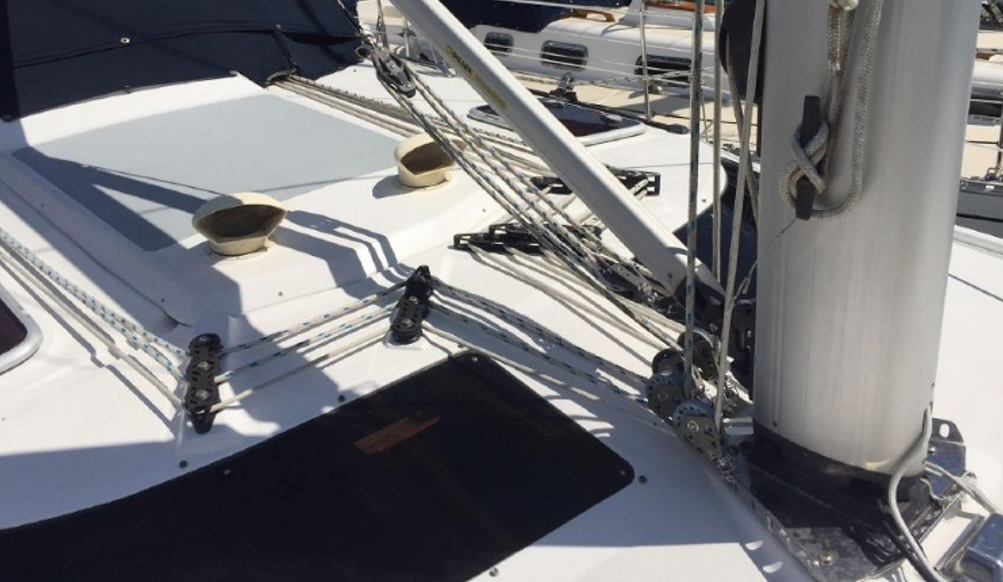

Right!!........below a photo of the mast base plate and deck hardware that routes all the lines aft on my sailboat......albeit, in your case the hardware will not need to be this complicated, as described above and a rigger can set you up with a clean installation with minimum hardware.

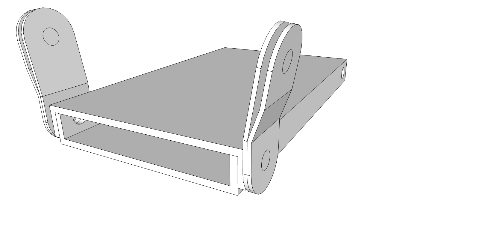

Part of me is wondering if mounting a tang to the current hinged base plate via the existing through pin provisions would be a good solution (see concept image). It would mean no modifications to the mast or deck, I'm just wondering if it would place new stresses in a manner that I'm not thinking of right now after only having 2 cups of coffee....

The new plate I want to try to hold off on until its up on stand in the winter, and the mast is un-stepped. I definitely want to have this type of setup rather than drilling holes in the deck, but un-stepping in the water isn't a wise mans game and I really want this done in the next week or two...so I'm thinking I'm going to create my own "temporary" solution that can be quickly adapted to the base plate system: using tangs attached to the existing hinged plate for mounting the turning blocks (see a previous reply I made with a quick concept drawing), which could them easily be transferred over to the base plated system in the winter.
That should work in the interim. You can still layout deck organizers that will work with the final plan.
Sfbay had to use a few to get around his hatch.

That
That was what I'm thinking. If I use the tangs on the existing plate, the blocks that redirect the halyards to the deck will be in close proximity to the final design with a new plate that I install during the winter.
Awesome, I think I've found my solution. I'm going to get the materials and start working on this. I'll be posting a response on this thread showing my (interim) final design.
