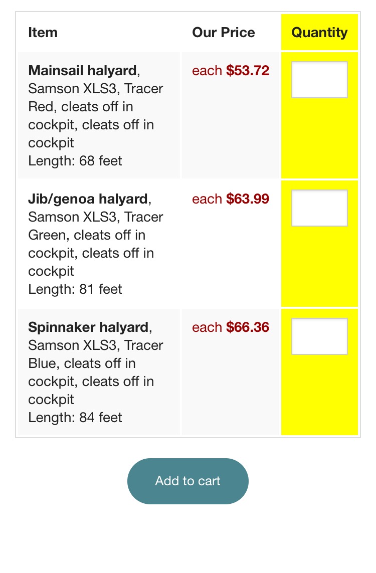

Go to the running rigging calculator in the store on this site and type in your boat information. There will be an option of "cleats at mast" or "cleats in cockpit". And you will get the proper line length for you boat. Here is what I got for an o day 26:
When you get to the page shown put in the quantity you want, add it to your cart and buy the line you need.
Really easy and you don't even have to do any math!

No math? Where's the fun in that?! I do usually like to do my own work, but this certainly makes it easy. Honestly, finding a good path for the lines appears to be a challenge. The handrails are in a very inconvenient place for even the (2) halyards I have (main & jib). It would be easy to do one on either side, but not efficient or look good. I'm going to have to get there today to make some mock ups with some extra line.

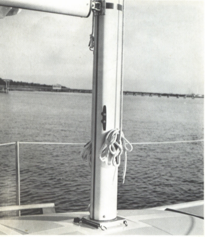

The O'Day 26 manual I found on line shows cleats on the mast for your halyards...........is this what you now have AND want to route these to the cockpit? Suggest discussing with Rig Rite or your local chandlery for halyard lead blocks on the mast or deck to route your halyards aft.
That's exactly what I have, and that's exactly what I'm trying to move away from. Getting up on deck when I'm single handing it has proven to be enough of a headache.
