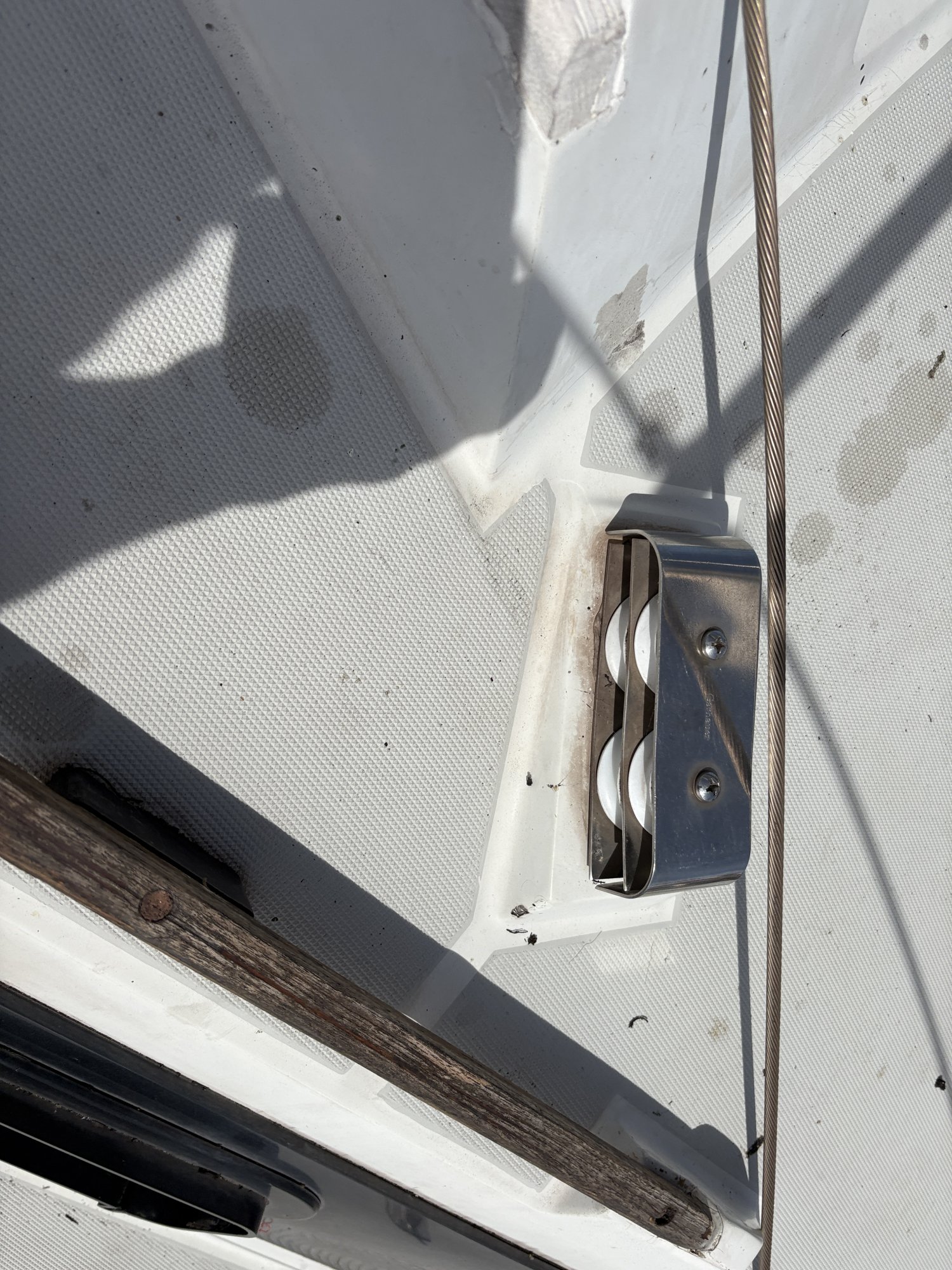

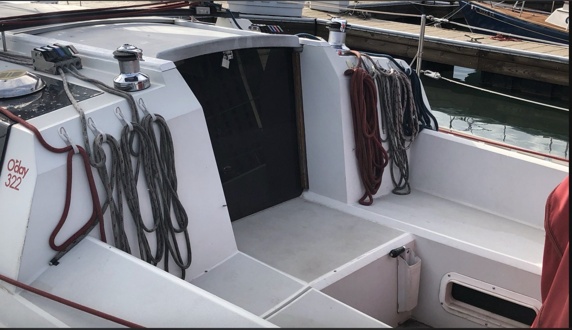

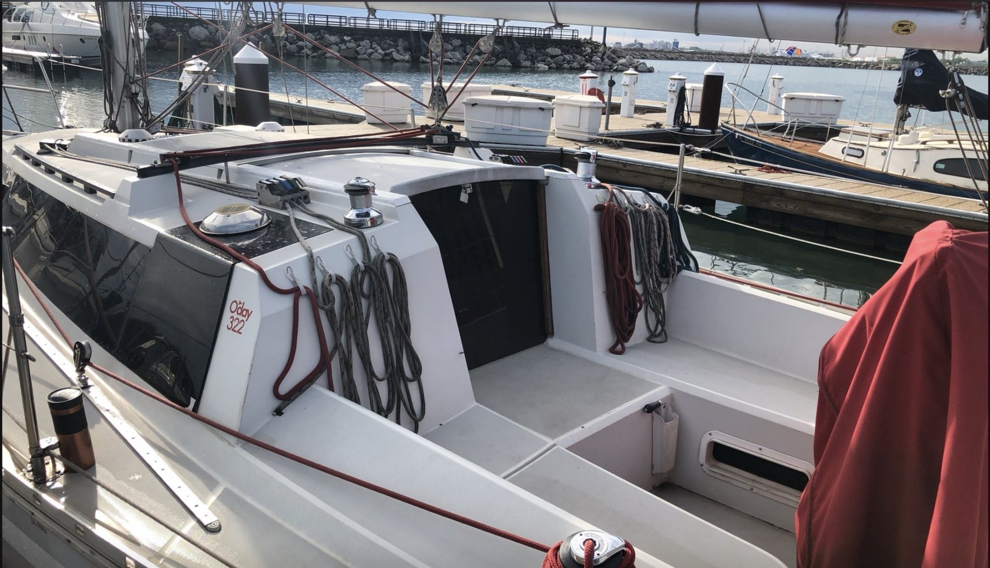

I have an O’Day 322. She has 2) 4x rope clutches on the cabintop and 2) 4x organizers near the mast. The organizers are double stacked.
I have:
1) Reefing line
2) main halyard
3) topping lift
4) main sheet
5) outhaul
6) vang
7) spinnaker halyard
8) furling line
So there isn’t much I cannot do from the cockpit.
Line-handling can get a little messy, but after I get the sails set and adjusted, I tidy up the lines.

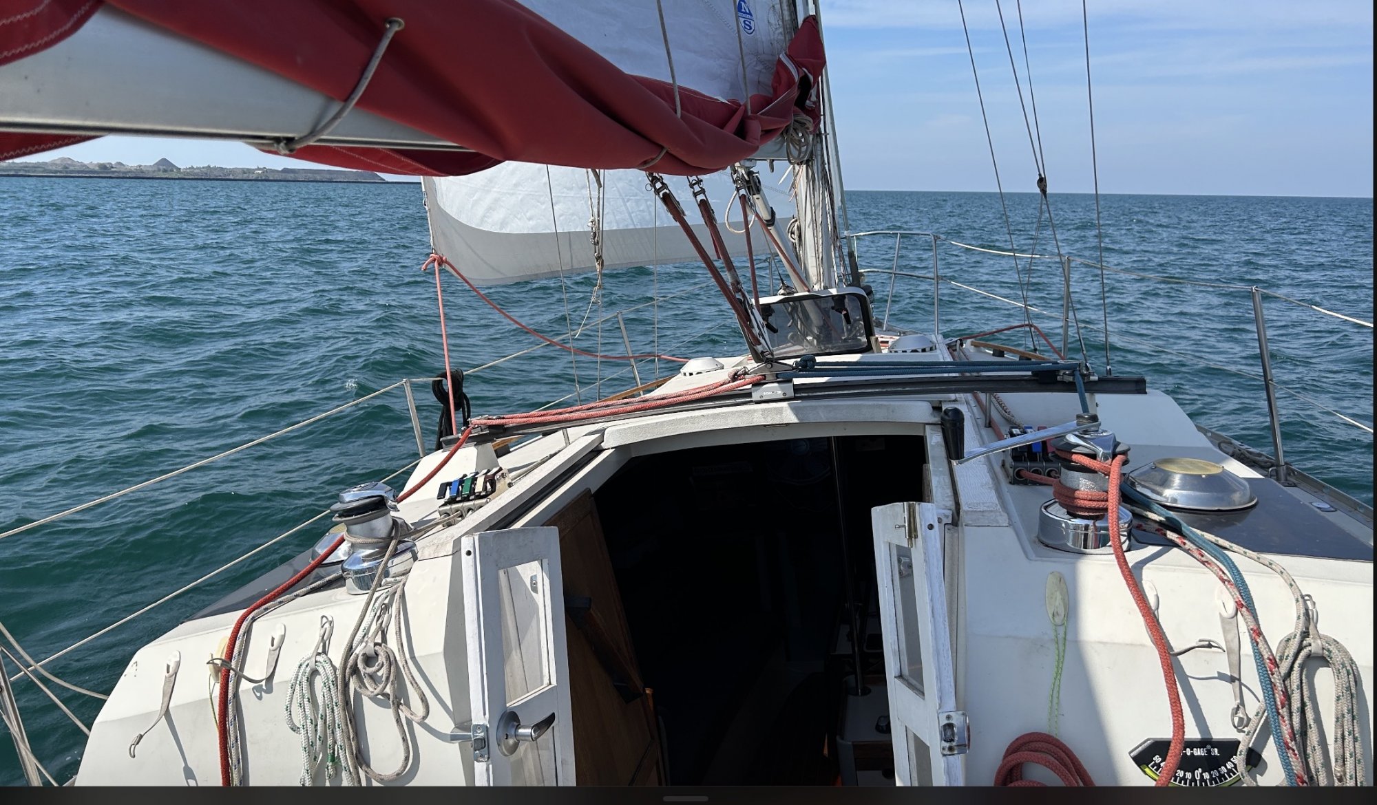

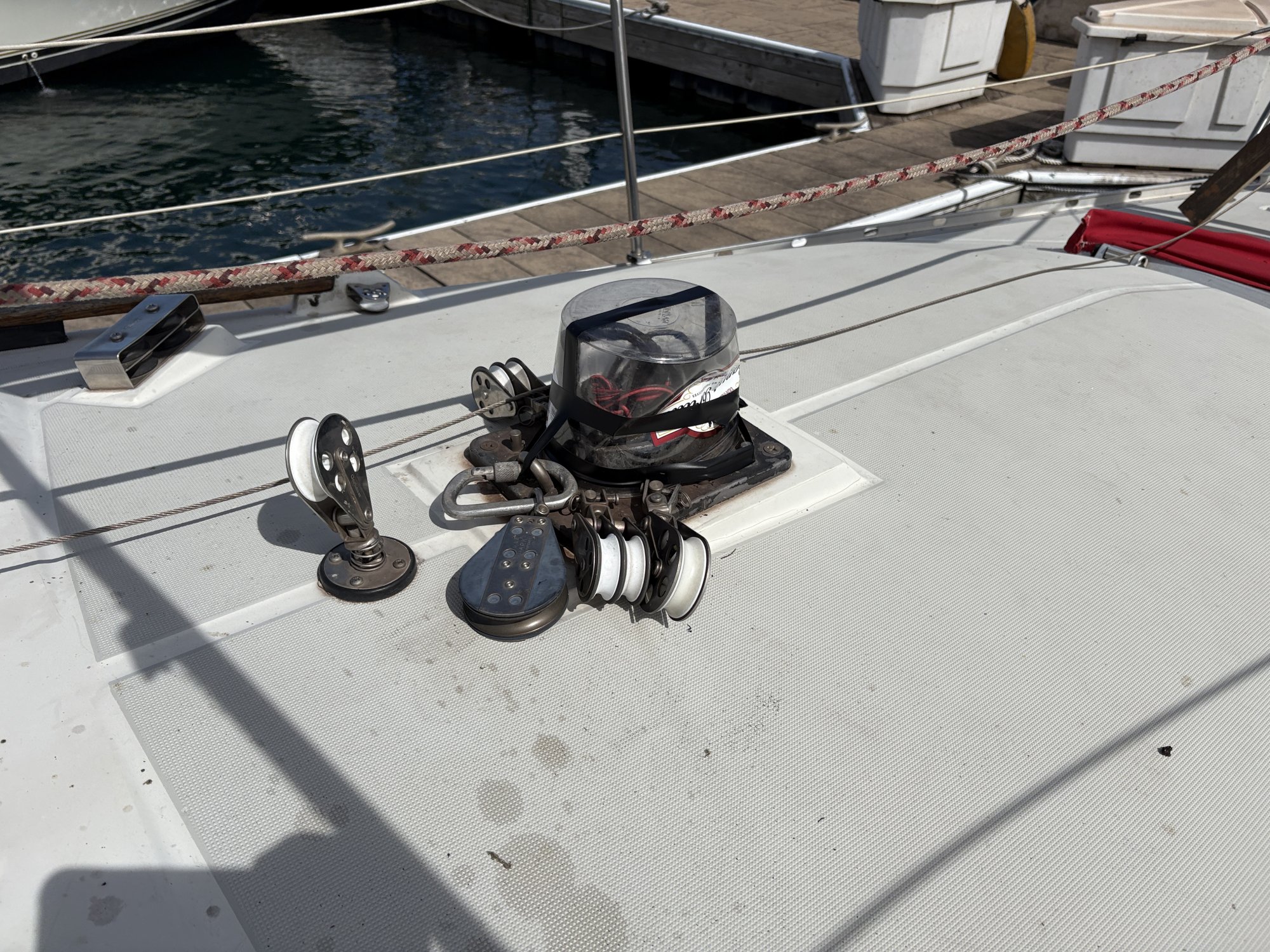

When you figure out what you want to do, check out Garhauer Marine, they have excellent quality and prices and are great to deal with. Here's a shot of what I did on my O'Day 35, though you can't see the rope clutches.:

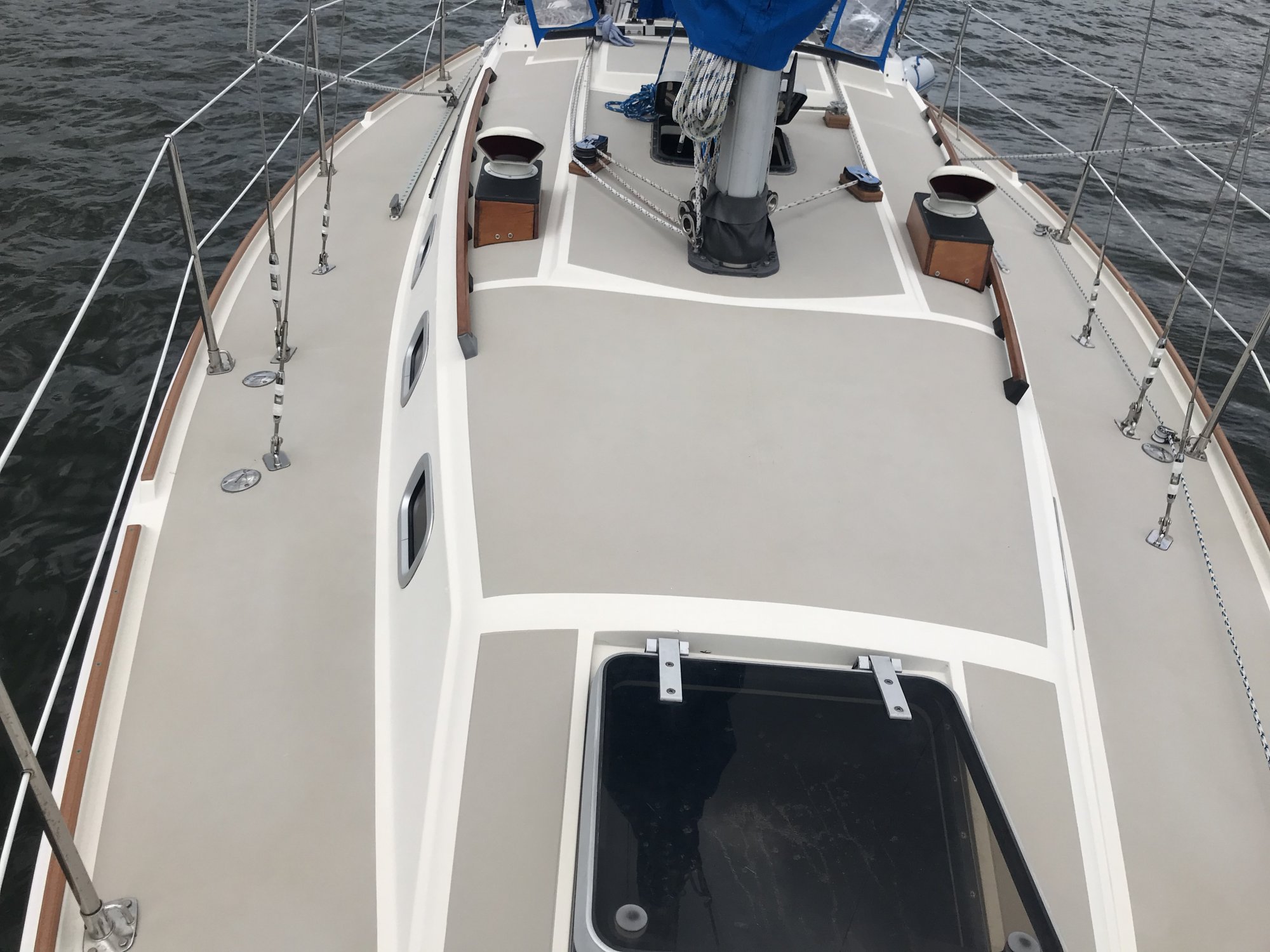

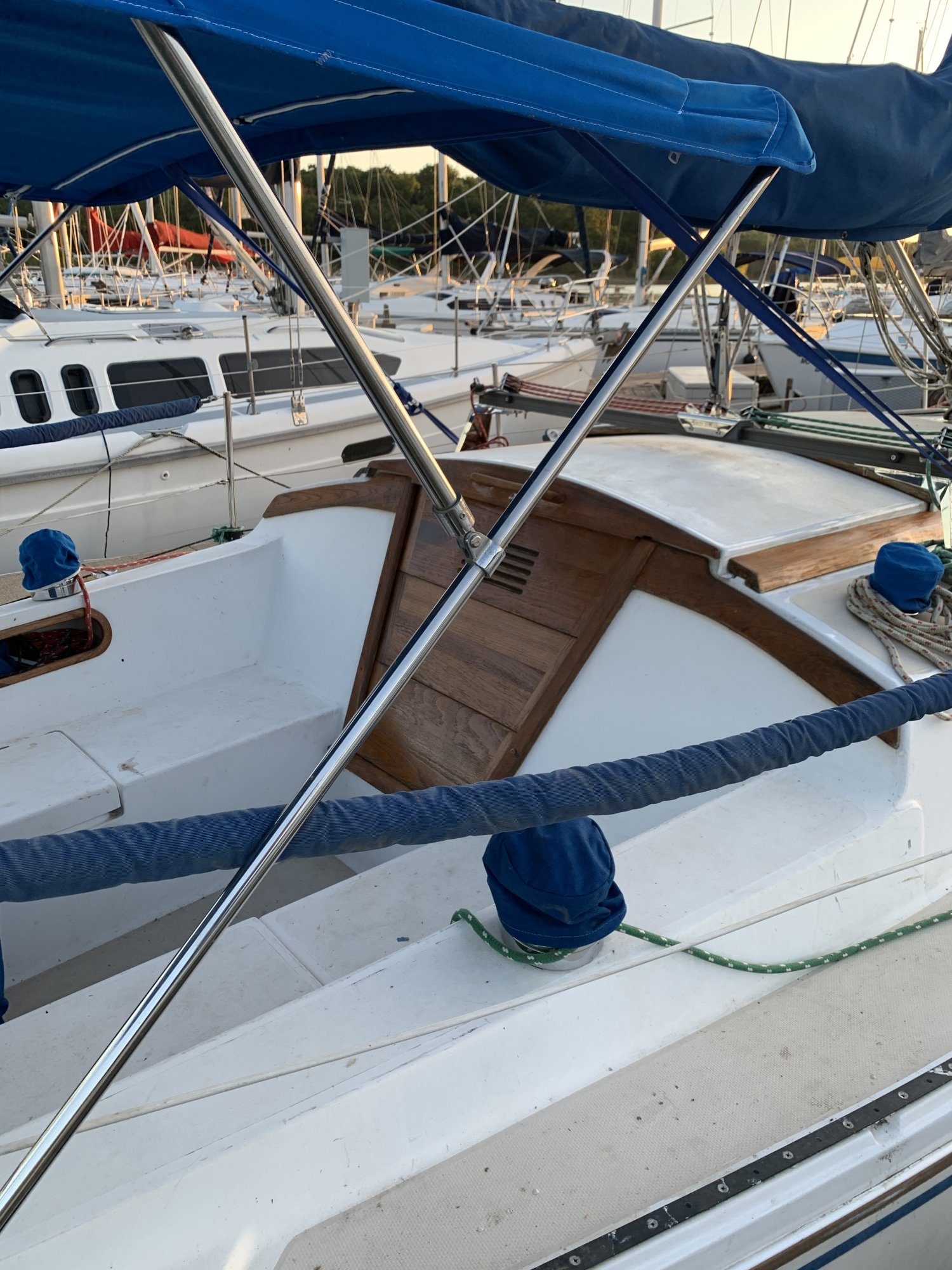

Here are a few shots of my deck organizers (4 lines each side) and my mast base (Sans the mast…a whole other story).
I also have a Mack Pack and lazy jacks, but those are tied off on the boom…so I do go forward to loosen the jacks if necessary.
As Stu mentioned, if you have a rigid vang, you can do away with the topping lift if you want, but I like having an extra halyard available.
I had 2 reefing lines (2 reef points on the sail). But I found I never used the 2nd reef line, so I repurposed that clutch for the furling line. Yes, mine ran along the side deck on the stancions, and was cleated off on the side deck. I did not leaning over trying to furl the sail and secure it on a cleat…especially when reefing in heavy winds. I moved the furling line to a cabintop clutch spot where it is super easy to reef and to use the clutch to stop the line when I want to reef. Honestly, one of the best improvements I have made.
I have a loose-footed main sail, and i do adjust my outhaul to get the full benefit of the loose foot.
my boat came with the provisions for 8 lines led aft. I replaced one of the 4-rope clutches that was in bad shape…because I find them useful to have run aft.
Yes, people like to lean against the bulkhead. If we are a very leisurely sail, I will put a cushion there to lean against And cover the lines.
