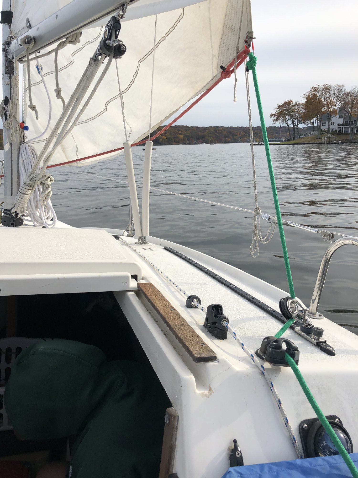

I have a Hunter 18.5, 1988 vintage and I ran both the main and jib halyards from blocks (sheeves) on the base of the mast through a fairlead and over to a cheek block. This would turn the line 90 degrees to another set of fairleads to a spinlock camcleat mounted on the cabin roof. Did this several years ago and this year and ran the jib halyard on the port side through the same arrangement. Works fine for me as I keep the boat in a slip for the season. I did for the first time trailer my boat up to Lake George NY in August. All good.

For the main halyard, I used machine screws and nuts with sealer
On the jib/genoa side used woodscrews with silicone sealer. All good.
