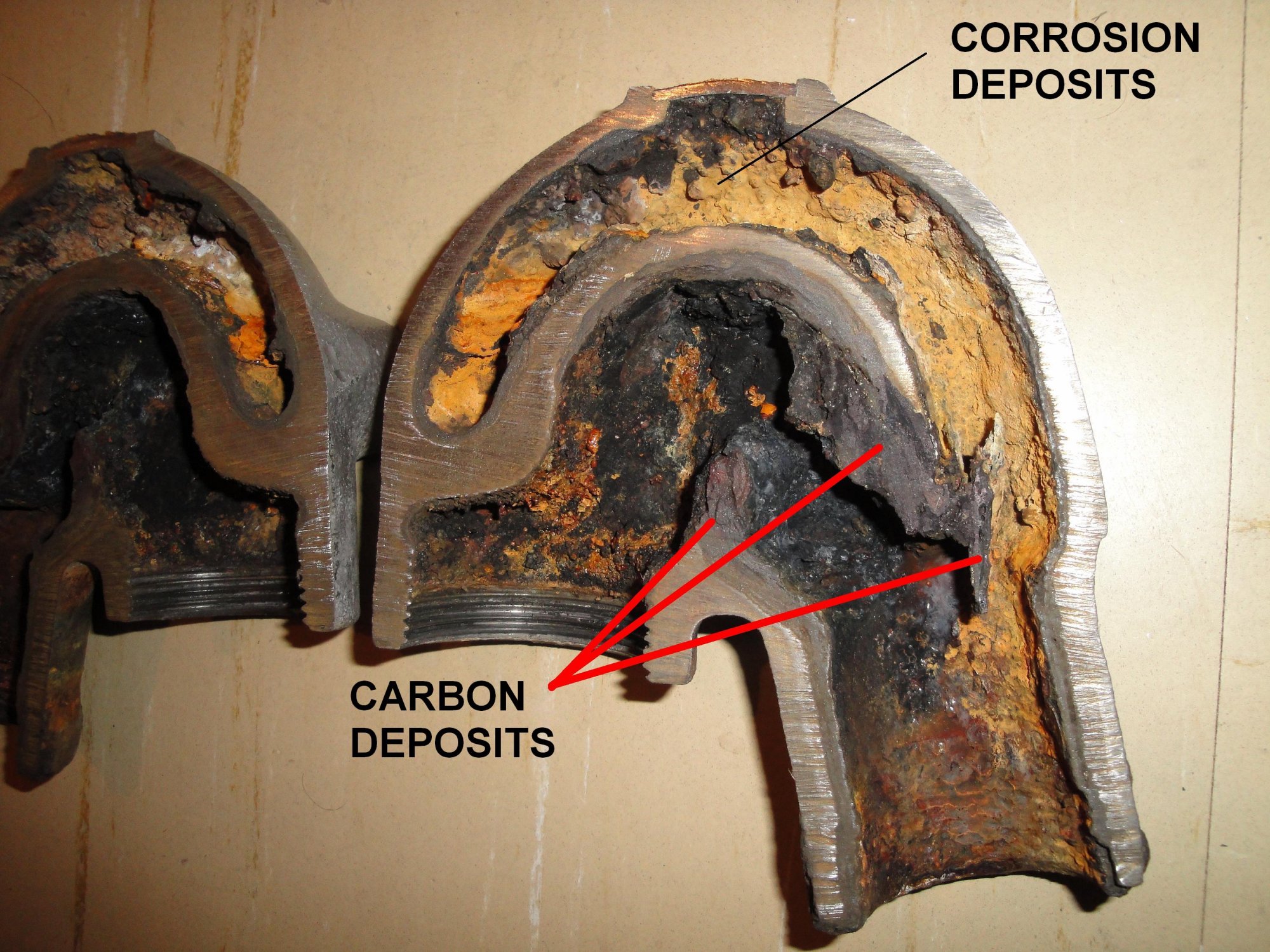

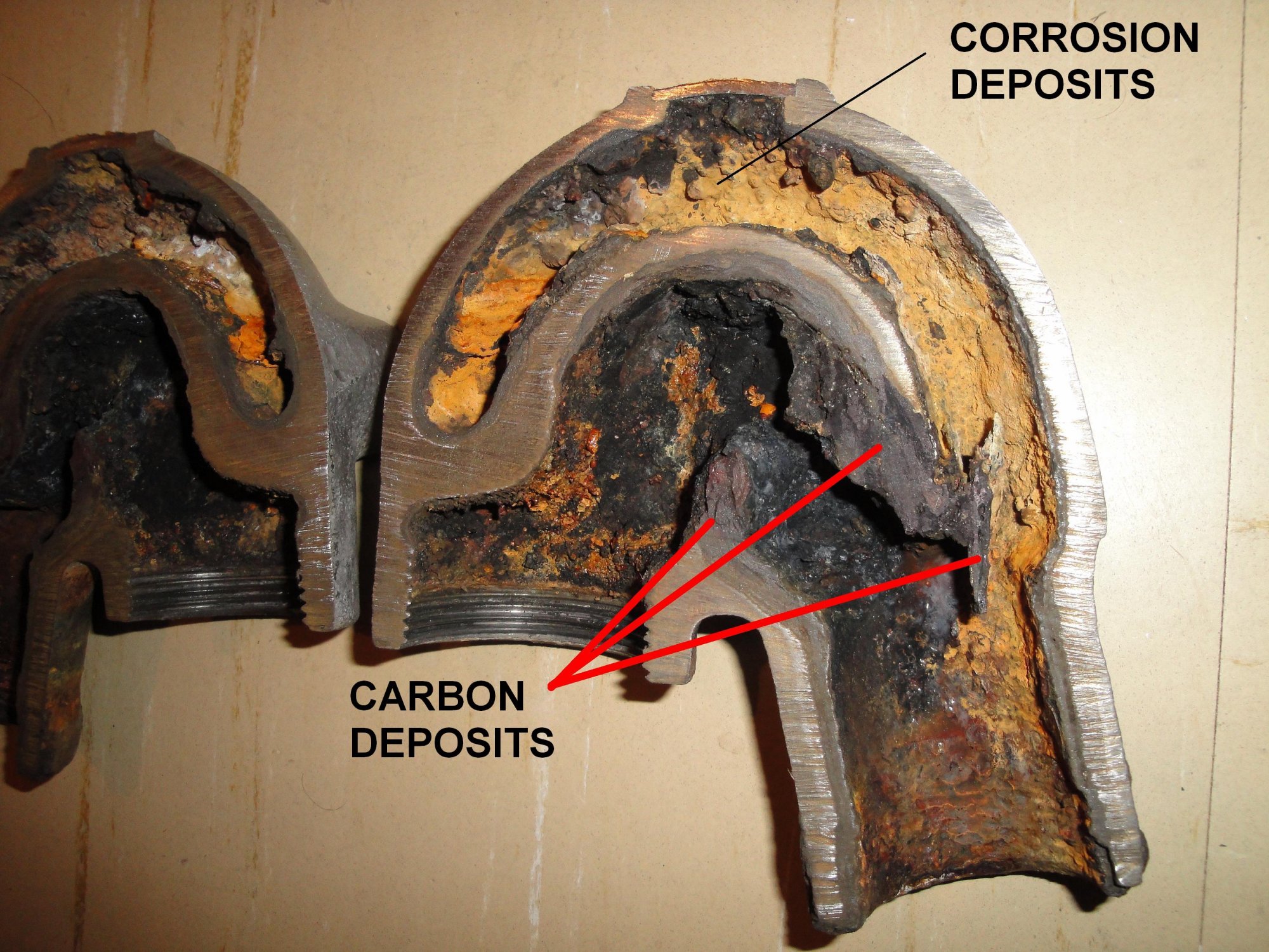

How can you say that .................................... :cuss:?
Pictures like that come up a lot discussing Yanmar ex elbows! Thing is it, can be cleaned from the exhaust outlet side but you need some pretty heavy duty steel brushes and acids but it's worth trying to keep them clean for what these things cost!
