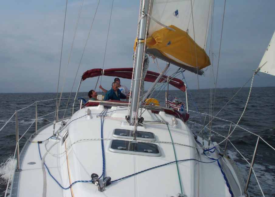

A fix preventer can result in catastrophically large forces on the boom and tow rail during a wild jibe. I prefer to make the preventer with a line that runs through a couple of pulleys and returns back to a winch at the cockpit (blue lines on the picture). Although the pulleys have a weak link that would break before the line, I never cleat the preventer line. Instead, I make 4 to 5 turns on the winch leaving the rest of the line hanging on the companionway. An identical system is set on the opposite side and the line forms a continuous loop. The preventer keeps the boom still in waves minimizing the chances of an accidental gibe. However, when a gibe does take place the preventer works as a brake that slows down the boom as it swings around. Once the boom reaches the opposite side, the preventer from that side has to be trimmed. This system has worked very well form me more than once and in high seas and relatively heavy winds. Effectively, the system works like the “Dutch brake” for a fraction of its cost. Other advantages of this system are that you don’t have to leave the cockpit to set it up and, while on the hook, you can use it to fix the boom eliminating noise at night. Having said that, I do believe that sailing downwind without a preventer is very dangerous since a gibe can be caused by a wave or a gust even while broad reaching. An accidental gibe can not only send somebody overboard, but also result in boom, mast or rig failure.
