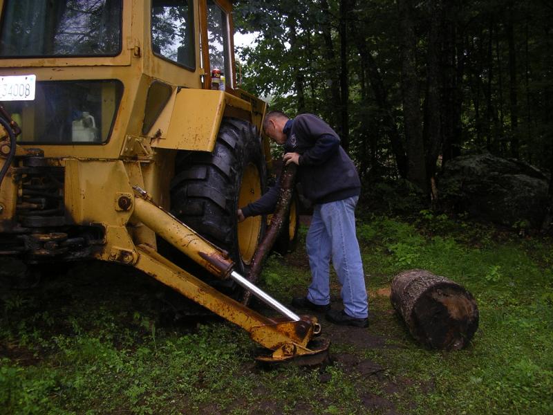

Six years ago I bought this 40 year old backhoe that had been abused by many. The engine is starting and running better now since I changed the oil/gunk and filter. It smokes, groans, and spits soot from the exhaust but sure beats using a shovel. I don't think any service work had been done on it in the last 15 years so I believe they can take some abuse.
All U Get
To add also there aren't glow plugs to start, just a squirt of Snap ether.
