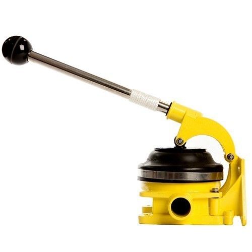

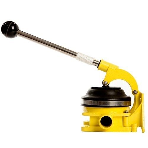

Whale makes a variety of pumps. A popular one is the whale gusher 10 pump. It will help to empty your bilge.1622180055424.jpeg
There is a kit to replace the diaphragm.
They are a great pump.

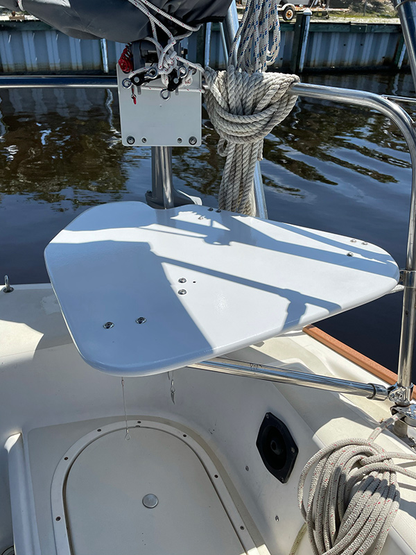

The Rule pump is located in the cockpit . Built into the fiberglass. It would be nice to just rebuild it instead of replacing it. I was hoping someone had this same problem and found interchangeable parts with Whale.

The gusher pump has a parts kit to replace the diaphragm if damaged.
The whale pumps can be oriented to be pumped from in the cockpit through the fiberglass. Insert a pump handle when needed. The pump can be serviced by climbing inside the boat. The pump can be removed to service the parts if that would be easier.

This is the only pic I have right now. Boat is 5 hrs away. I was just hoping someone has had the same problem. I could not find any info on a rule gusher pump, and I looked for a long time. Just hope the Whale fits the hole.
24,773
It looks similar to the Whale through deck plate. You stick a handle in the connection and pump water overboard. The similar pumps go be the names titan and urchin.
There are kits to fix them. You willneed the actual name of the pump to get the right kit. I replaced the diaphragm on my pump last year. A DIY task. Level 2 out of 5.Most boat stores have them. WM has the kits. Whether they are in stock is anyone’s guess.
Looks like the connection for the handle on my Whale pump.
