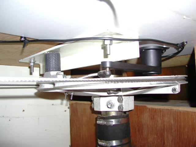

I am planning to install a Raymarine rudder sensor on a Hunter 31. Has anyone installed one before? I am looking at the 4 page installation diagrams and they don't quite make sense for my 31. If I installed the Rudder Sensor to the ceiling in the back of the quarter berth, it would seem to fit, work not sure. The fittings and clips on the rudder sensor would be upside down. Any help would be appreciated.

Here is what I did in my H-34; similar but not identical to the setup on the 31:
it is mounted inverted. I had to nibble a bit of rudder stop off to clear the pushrod.. Measure carefully. If I remember correctly, I had to reverse the red and green wires going to the control head.
Thank you, this is what I was thinking. Thank you for the quick simple response.

You can install it upside down if that is the best way to mount it. You may need to switch the wires to the AP around…so it displays properly.
