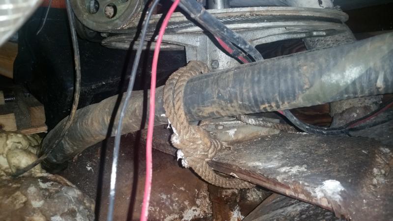

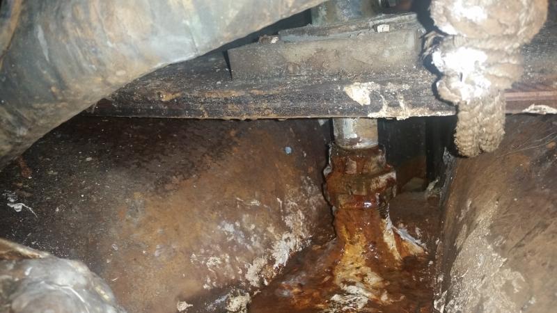

I've removed my rudder twice while on the hard. I guess you could do it when the boat was in the water if the and if the packing gland is above the waterline....... but the risk of breaking something on an old boat that is critical in keeping the water out is pretty high, especially looking at your pictures. If it was me I'd do it on the hard. You either have to dig a really deep hole under the rudder, or get the yard to lift the boat, but your pride and joy won't sink!

Progress has been made. The rudder is at the shop being investigated right now. Its 100% not the original rudder. Nothing a out it matches up to any diagrams or specs sheet info I have. Either way, Im not trying to win any races and it got the job done so were primarily concerned about the integrity of it. He'll begin rebuilding and shaping the rudder. In the mean time ive been sand blasting, removing broken bolts and replacing all with new SS bolts, and repainting the steering quadrant. Juat a quick pic.
