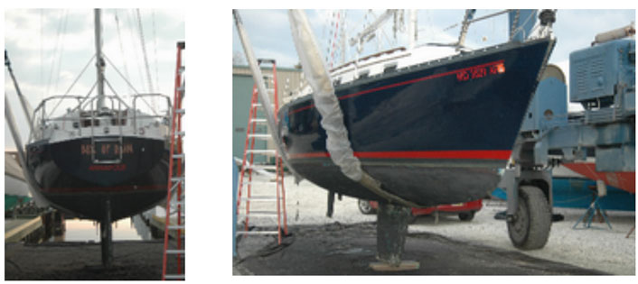

I see lots of people on here speculating about having to drop the rudder in order to remove the prop shaft. This is not the case on my H27 (1980). The strut is bent slightly. You can turn the rudder to one side and easily pull the prop shaft out. It is made like that so you don't have to drop the rudder.
I have a good close up of this and I will post it when I find it.
Thanks for looking.
