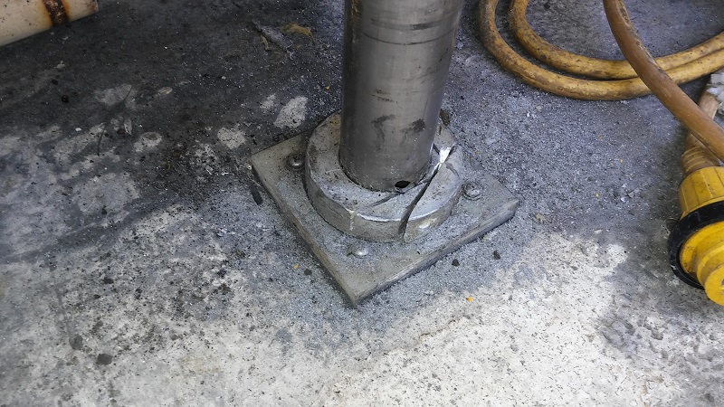

Got the steering quadrant off finally. Thanks Franklin. Then it took several hours to get the collar bolt out. Now the collar will not come off, so I am cutting the son of a gun. I tried everything, PB, banging, heat, pressure on the top of the rudder post (suitably protected). Let me tell you this collar is a bitch to cut.

Mine broke off on the process and had to be taken to a machine shop to be drilled out and then they put SS inserts in to combat the corrosion on the bolts and drilled & tapped those. Hopefully you won't have an issue with yours.
