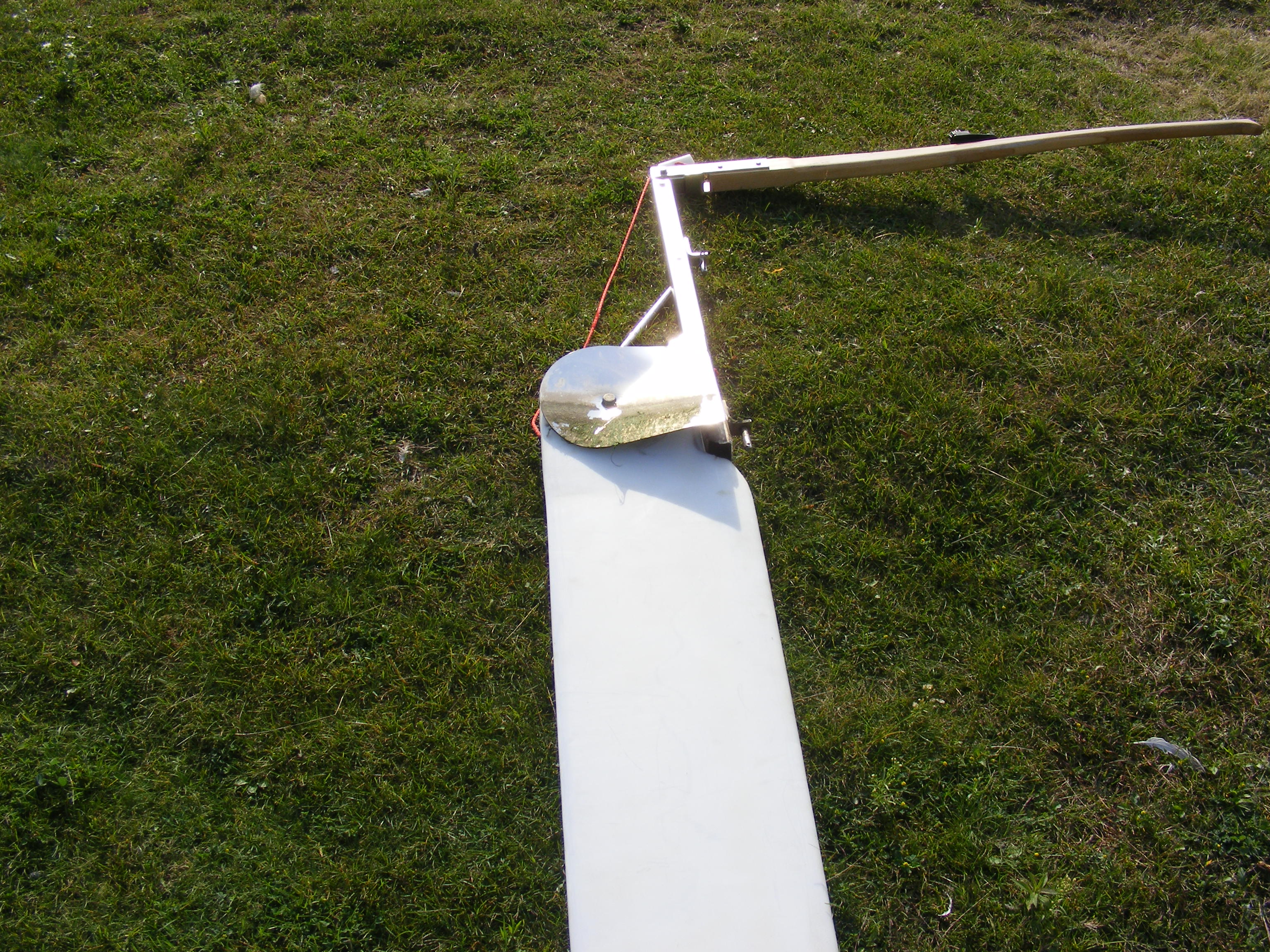

My rudder recetly failed rather spectacularly, and here is my story for any that are interested.
We were participating in the annual Cloud 9 race from Peter's Rock (half way between Coburg and Port Hope) ON to Point Breeze NY about 30 NM. We sailed across Lake Ontario on the Saturday and stayed overnight in Oak Orchards Yacht club in NY. The second leg the race we retun to Peter’s rock across the lake. We set out from Oak Orchard at 9AM we had five to six foot waves with a 20-25 mph wind from the SW with gusts up to 30mph. We were heading almost due north on a broad reach with the Genoa and Main sail set. We were making between 6-7 knts speed. Just past the weather buoy in the middle of Lake Ontario we noticed that the boat started to head up into the wind when ever a gust would hit and we couldn't seem to hold course even with the rudder hard over. We also noticed that their was practically no resistance on the tiller even when hard over.

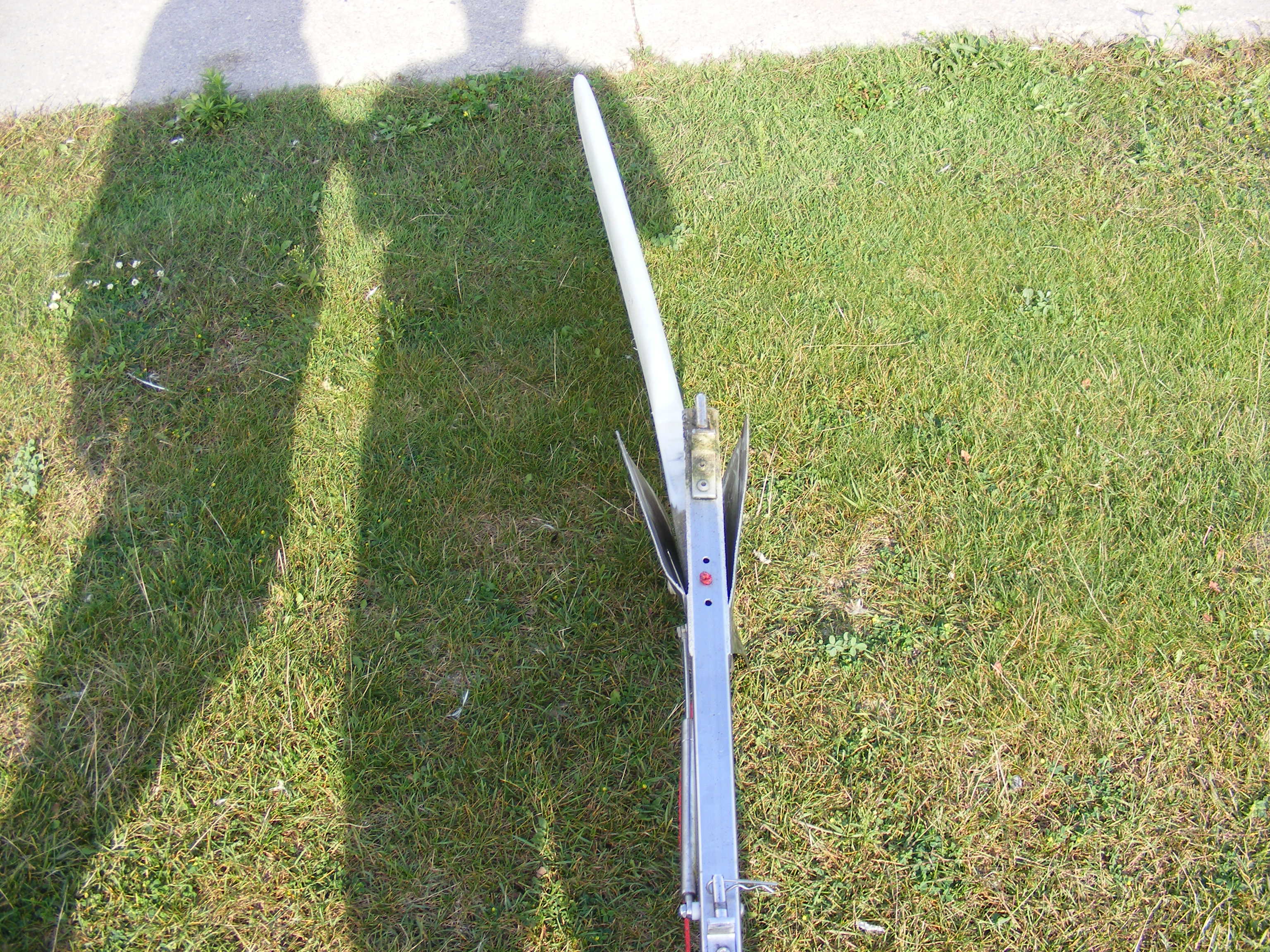

We took a look over the back and saw the rudder at a very strange angle. We immediately dropped sail and pulled the rudder off the back of the boat. It was as you can see in the pictures. We tried to bend the sides in a bit and to splint the rudder using duct tape and our emergency paddle. We then put it back on and tried to hold a course while under power. This broke the paddle and the rudder hit prop nearly immediately. We pulled the rudder back inboard and proceeded back using the outboard alone to steer her in. Now I don't know if your familiar with the motor well on the back of a 26D but it is sunk down into the lazarette on the port side. There is only enough room in the well for the motor head to swing about 2 inches to port and 1 inch to starboard. So with this limitation and the large waves that day we swung back and forth drunkenly as we kept our eyes firmly glued on the cartplotter and compass mounted on the starboard cabin wall. Three of four hours latter we arrived in Coburg. We managed to make it across the harbour to the boat ramp where we tied up and called for a ride back to Port Hope so we could pick up the car and our trailer, and hauled the boat.
I contacted the rudder's manufacturer, and after they saw the pictures they offered to replace it right away. So my rudder is currently "in the mail".
So what spectacular failures have you had on your cruises this year, and please feel free to coment on how you would deal with a problem like the one I had.

The long tube from the tiller is made of stainless box tubeing and is by far more ridgid than the original rudder. The two bent out peices are also stainless steel and seem very strong. The part of the rudder that failed was the weld that help the stainless sideplates to the box tubeing. The HDPE rudder blade itself was fine. I was actually very suprised that it broke were it did. I had expected that if it was going to break it would be the plastic that sheared off.
I would not be suprissed to find out that the whole problem was caused a welder haveing a bad day.

The way that is designed makes it hard for the welder to have a good day because without a special TIG torch all you can do is make a pass on the outside seam as it to narrow to weld inside the channel that is formed
