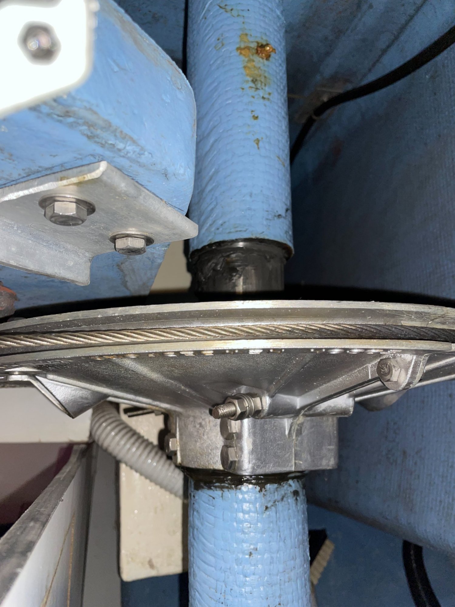

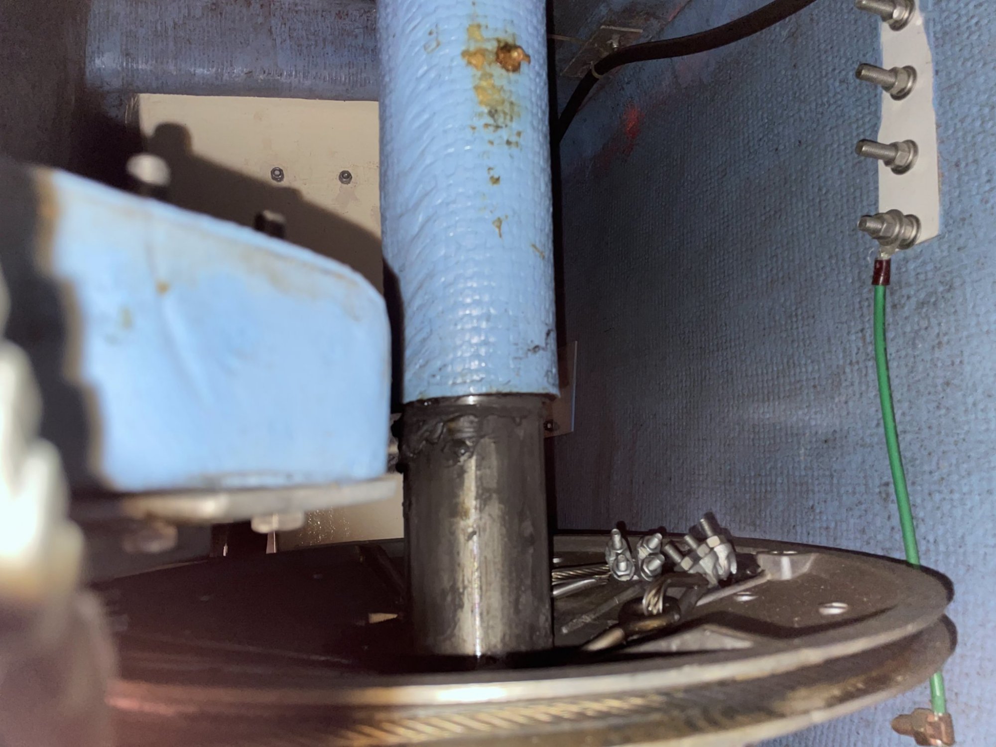

I have an 1988 O’Day 322 and my rudder post looks like this:
You can see a grease zerk on the upper part of the tube. There is a similar one on the lower part of the tube.
I don’t think we would see this on an Edson drawing as the tube is not part of their system (nor is the shaft).

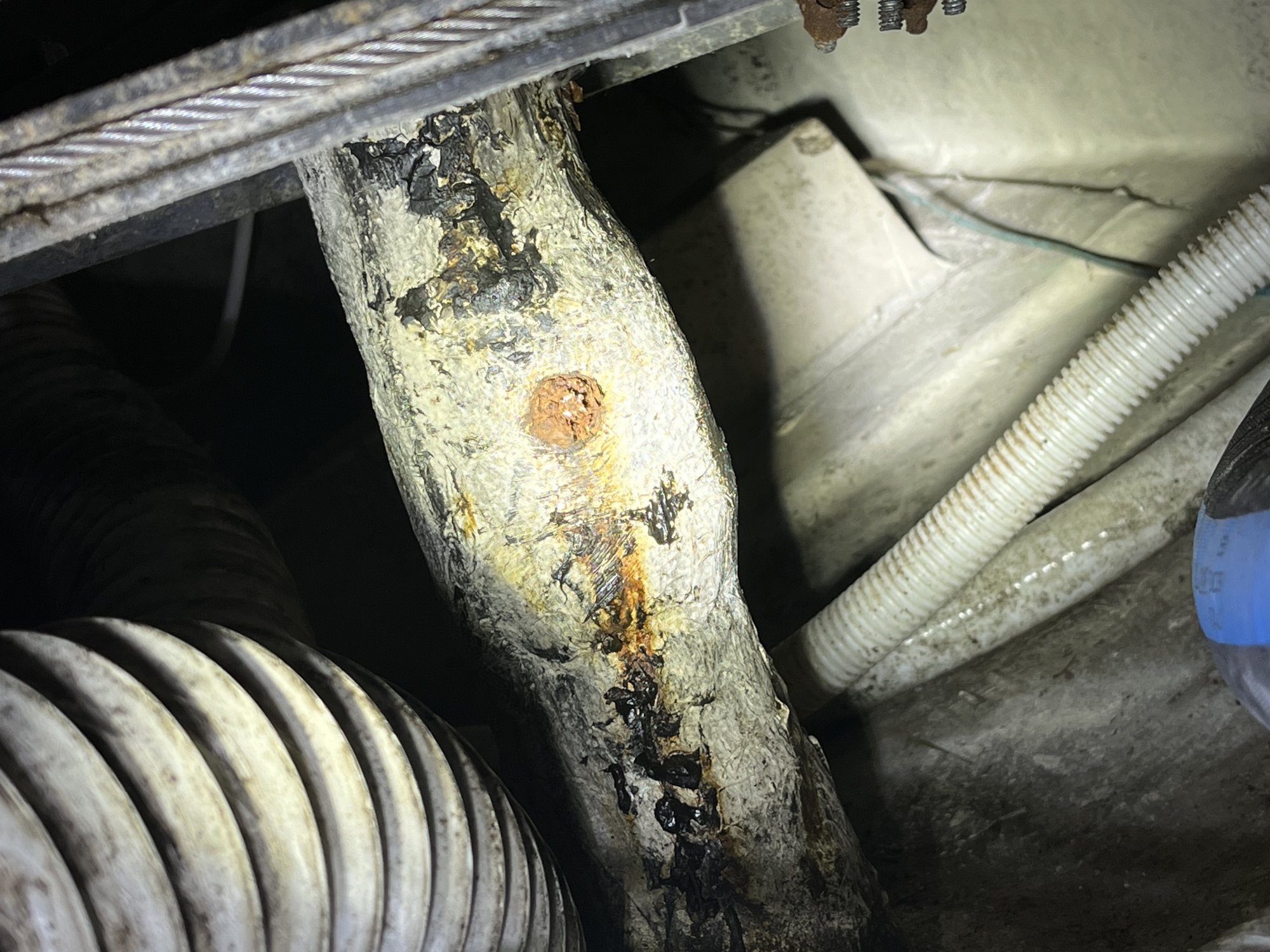

Greg - YES thank you. I found a brown rusted nub (attached) that I wondered about but couldn't identify...My setup not nearly as nice as yours. That should just be threaded in?
Thanks again.

I am guessing that there is a zero under that rust. Maybe carefully wire brush it and see what is left of the verk.
if it is toast, I think that it is just threaded into the fiberglass rudder tube.
