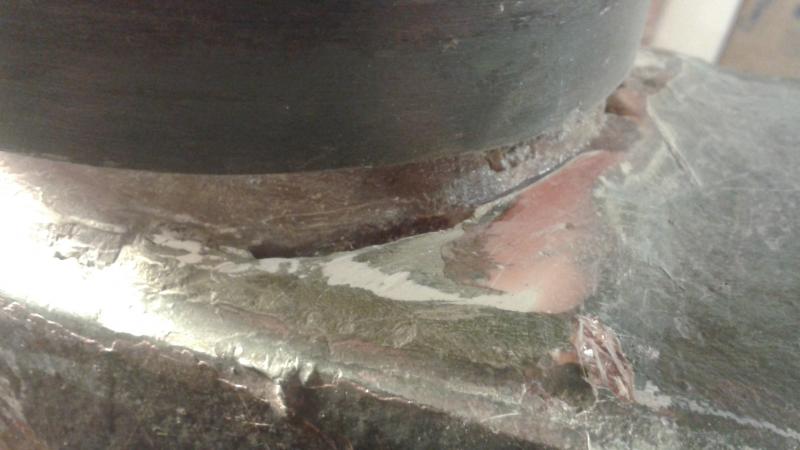

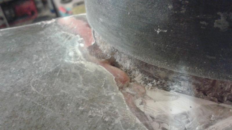

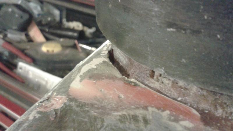

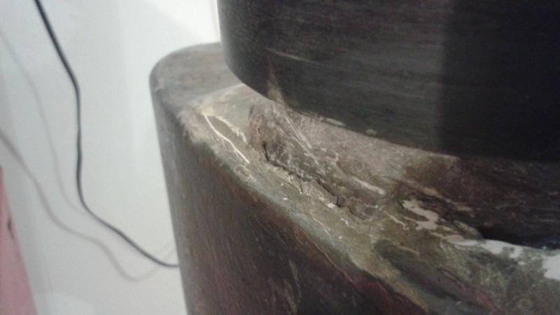

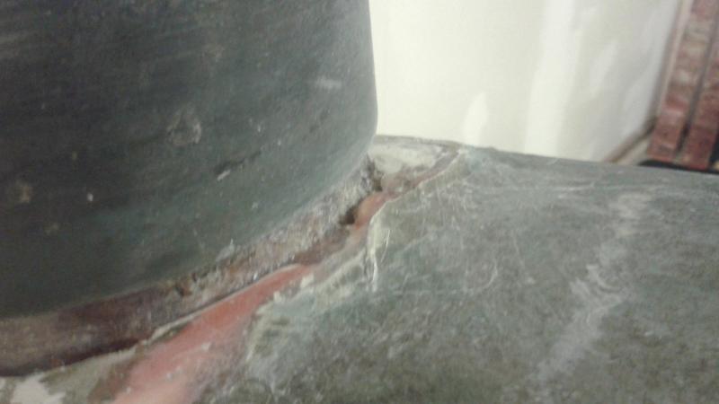

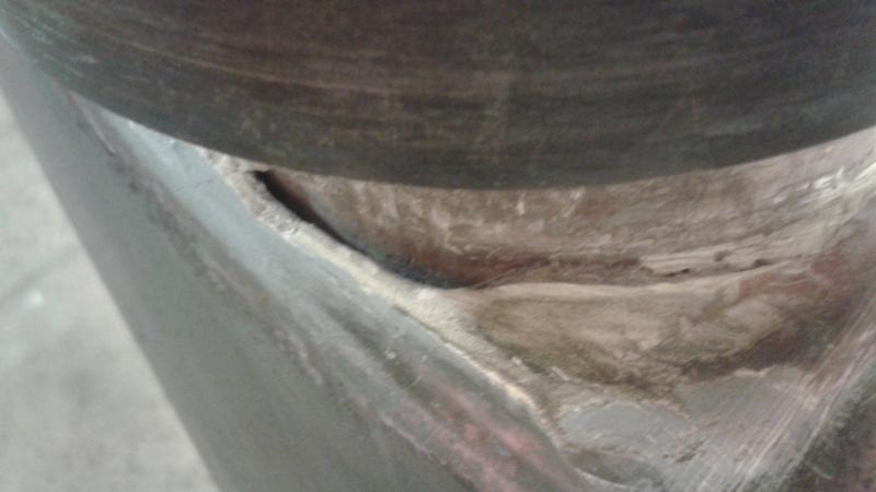

After getting the rudder home, I laid it on its side and proceeded to investigate the rudder stock connection. What I thought was fairing compound between the rudder and rudder stock was more like caulking (soft and pliable), with a screw driver and putty knife I was able to
remove most of it and the water started running out. I left it like that for several days with towels soaking up the water, I bet about 2 to 3 gallons came out. Then I installed an eye bolt in the ceiling so I could stand the rudder up right and get a better look at it and get the rest of the caulking removed, once cleaned up there it was the root of my trouble,

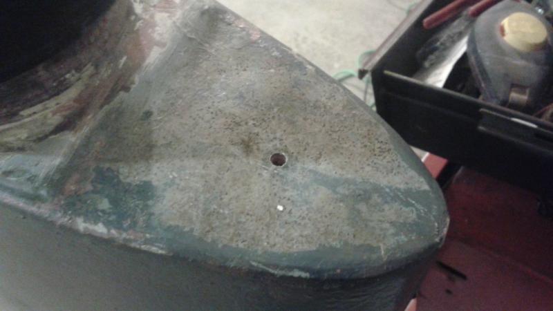

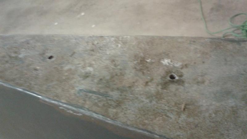

VOIDS in the adhesive between the rudder stock and the rudder housing (See attached Pics), I laid the rudder back on its side and more water came out. Ok now I know what the trouble is so let’s formulate a plan of action, first I’ll drill some ¼” holes in the top and bottom of
the rudder, then stand it back up put some mild heat of about 100 to 150 deg and drive off the remaining moisture then mix up some west systems epoxy fill in the voids and holes and be ready to go right…….WRONG..!!!!!

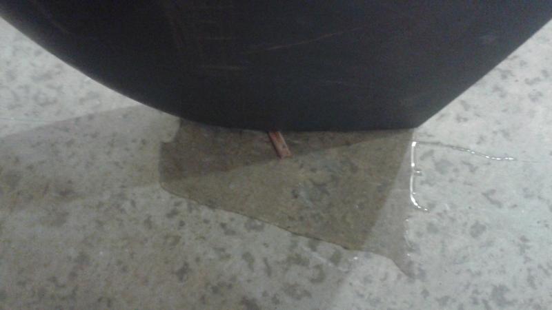

Here I am 2 months later and I still have water coming out, I took a small air compressor and blew low pressure air (about 10 to 15 psi) in the holes I had drilled and water came streaming out of the rudder stock connection and the other holes that I had drilled (See Pics). OK I’ve got to get the water of this thing before I make any repairs, so I turn to the

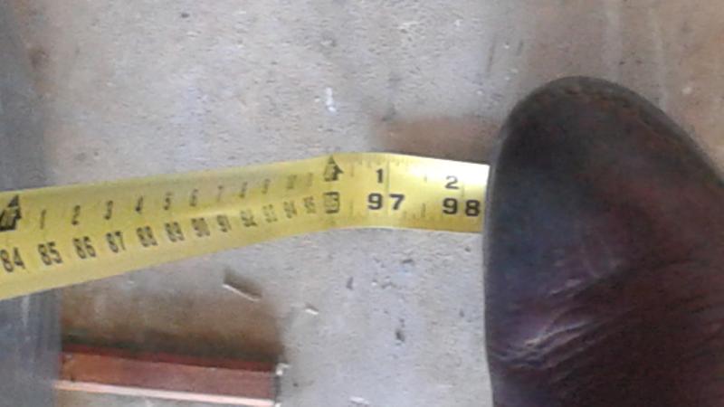

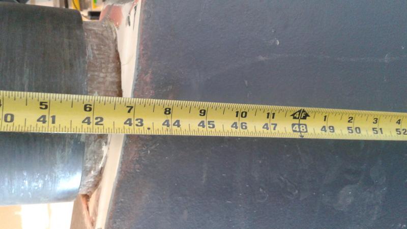

Back to the rudder stock, after reading some of the forum posts about the rudder failures and they seemed to fail a few inches below the top of rudder it got me thinking so I grabbed my tape measure and went to the garage, the rudder and stock combined are about 96” (see Pics)
and the failure point as indicated in some of the posts was about 2” below the top of the rudder, about 45” down from the tip of the stock. Now I’m not a Marine Architect but I have worked in heavy industry engineering for 35 years and have witnessed many fatigue failures over the years, so based on the size of the rudder and stock I’m guessing a water logged

Take a closer look at the 'fingers' coming off the shaft. They are SS and serve as a substrate for the so-called composite which is the problem. If you don't believe me, call Foss Foam in California.
