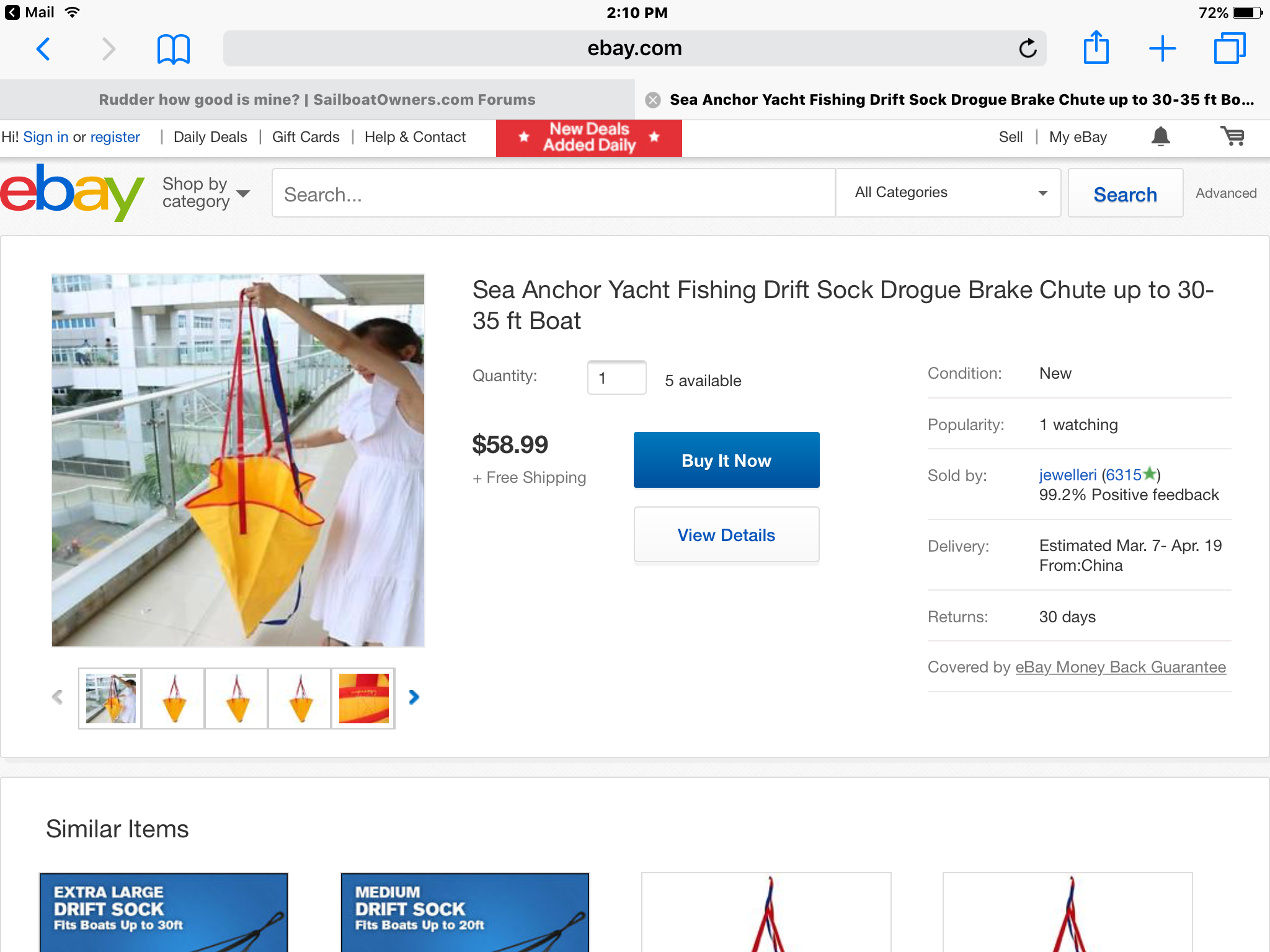

Awesome video @Gunni, I have never even thought about this, never mind see how they work. Very impressive! I probably would never have a reason the use one...but if I did sure would be nice to have the onboard inventory include a drogue. Any idea if something like this would work...its quite different than the one used in the video.

That looks pretty flimsy, straps don't encircle the bag. Looks more like a sea anchor than a drogue. Drogues are designed to slow the boat, not stop it. That said, I have heard of guys steering the boat in a similar manner using a bucket. I didn't want to experiment so I just went with the Galerider.
