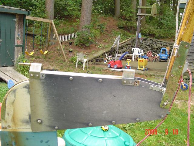

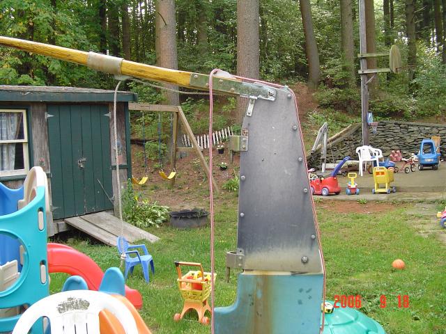

I AM NEW TO SAILING BUT 30 YEARS IN BOATING BUT ONLY TAKEN THIS BOAT OUT A FEW TIMES SO FAR IN 2 SEASONS. i HAVE LITTLE CONFIDENCE IN THE MOTOR WHICH HAS BEEN BOGGING DOWN WHEN i TRY TO THROTTLE UP. mAYBE OIL TOO RICH IN THE GAS??? bUT, THE HEAD OF THE RUDDER HAS THE WOODEN TILLER AFFIXED BY A HEAVY GAGE ALUMINUM "H" TYPE OF A BRACKET WITH ABOUT A 3/8'S BOLT AND A WING NUT THAT SECURES IT TO THE HOLE IN THE HEAD. tHE HOLE HAS WORN OUT AND IS A GOOD BIT LARGER CREATING A VERY SLOPPY FASTENING FOR THE TILLER PLUS THE PART OF THE BRACKET THAT MOVES AROUND THE RUDDER HEAD AS U RAISE OR LOWER THE TILLER-UP OR DOWN, IS ALSO SLOPPY WITH ABOUT 1/8 " GAP ON EITHER SIDE-MEANING THE SPACE BETWEEN THE SIDE OF THE RUDDER HEAD AND THE INSIDE OF THE "H" BRACKET. wHAT MIGHT BE THE BEST IDEAS TO CORRECT BOTH PROBLEMS INEXPENSIVELY. i DON'T THINK WASHERS WILL PROVIDE ENOUGH SURFACE FOR THE "H" BRACKET'S SLACK BUT MAYBE SOME KIND OF PLATING ON BOTH SIDES OR PERHAPS BUILD UP THE BRACKET ITSELF? fOR THE HOLE SOME SAID FILL IT AND RE-DRILL BUT WHAT IS THE HARDEST MATERIAL i COULD USE? oTHERS SUGGESTED SOME KIND OF A BEARING OR A BUSHING? aNY HELP IS APPRECIATED!!!! FEEL FREE TO EMAIL ME AT ICCSINC1@VERIZON.NET[/email] AND THANKS!! RICK

Rick,
Can you post some pictures of this? The rudder head has two pintles that fit into two gudgeons on the stern. Are these worn? The rudder head being aluminum, has a hole for the bolt where your tiller connects. Is the hole worn oblong? Rudy has a lot of the O'Day parts if you need them. http://www.drmarine.com/ Perhaps the hole in the rudder head can be filled in by a marine welder and a new hole drilled, or a metal bushing can be added to it somehow. The 2 stroke gasoline sail drive engines have always had issues. Some guys like them when they run right. Other guys have removed them, plugged the hole and installed a bracket for an outboard. I've never been fond of the idea of having a gasoline tank in the bilge of a sailboat. One of our club members has an O'Day 27 with and OMC Johnson sail drive and he installed a bracket on the transom for a Johnson long shaft 9.9 2 stroke outboard engine.

Joe, the O'Day 25 has a fiberglass outboard rudder. To fill it I'd use thickened Epoxy resin (I use WEST System, but System 3 or MAAS is good too). Also, the VIRE 7 is a straight inboard, not a saildrive. A good engine in it's day......still good if in good condition and tune.
Rick, As I say above, thickened epoxy poured into the hole in the rudder (tape over the back side) will be strong enough if you use a high-density filler, WEST has a graphite filler that will also serve to create a good bearing surface for the pivot bolt and tiller straps (that aluminum "H" piece that connects tiller to rudder. I would suspect (hard to tell without seeing your rudder) that the slop has caused wear on the rudder surface and that is adding to the looseness. You may be able to build-up the rudder thickness with the filler. perhaps laminate a layer of glass tape to each side before redrilling the bolt hole.

thanks for the tips! The rudder is FG and is worn as u said from the strap bracket. A bush might be a good isea so I'll see what Napa might have and other places otherwise I will check out the epoxy fillers and try to build up the head. How about building up the strap on the insides with some kind of nylon sheeting? I don't know where or what is out there for that but nylon wears well. ?? The motor seems ok but it has died on me when I try to accelerate and have to quickly return to just above idle to stay moving. I think I put too much oil in the gas last year but it was not smokey-I don't know. I wish I knew someone in the Middle River area of Baltimore who is familiar with this motor and could check it out for me without giving up my 1st born. Vire 7 has a web site but it may have been abandoned as it has not been updated since 9/08. It has helped me on this engine but I just don't trust it and it is very hard to reach with a messed up back now. Maybe I ought to run it all around, close to my marina in case of a breakdown, to iron out its problems and test its capabilities???

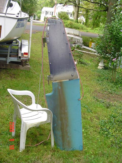

The O'Day fiberglass rudder blades have had some serious issues for years. I went through two of them on my boat and finally had a solid blade built by Rudy years ago and have had no problems since. With that said, looking at the picture of your rudder I can see that it is completely made of fiberglass with no aluminum rudder head. I don't see why you can't do some fiberglass reconstruction work on it. Pick up Don Casey's book, "Sailboat Hull & Deck Repair" at your local library and get familiar with the ins and outs of working with fiberglass. Use a good epoxy for the repair. I see an outboard on this boat. Is this what you have? I was under the impression that you had a sail drive inboard.

I think that I got a little confused by the pictures that you just showed and what he was trying to explain to me. I didn't know that they put a straight inboard 2 stroke gas engine in the 25's. I'd still be kind of leery having an inboard gasoline engine in a sailboat. Years ago a powerboat that was docked along side of my boat on the Taunton River in Somerset, blew up. Luckily, I got my boat out of there just in time after the explosion. I had just bought two new Thurston sails for it. The force of the explosion blew the guy right out of the cockpit and into the water. The shrapnel from it hit me in back of my neck. Both myself and the powerboat owner were lucky that day. If fact, the boat was made of aluminum and was able to be saved after the fire got put out.

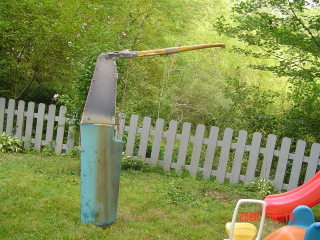

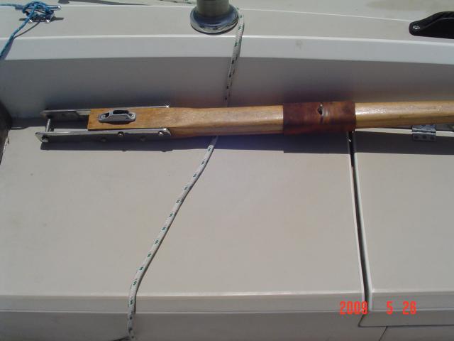

Rick, for what it's worth, I had a similar problem with the rudder on my O'Day 23. When I bought the boat a few years ago, there was play between the rudder head and the H-bracket that connected the rudder and the tiller. (The hole for the bolt that holds the bracket onto the rudder was fine.) I ended up inserting a few heavy-duty stainless steel washers on the inside of the H-bracket (between the inside of the bracket and the rudder head). That solved my problem.

What I did...
I brought the pin with the wing nut to the hardware store, poked around in the plumbing deptment and scooped up a couple copper bushings that fit around the pin and drilled out the rudder to the diameter of the bushings. Measured the space between the sides of the H cut one of the bushings down a bit and epoxy directly in the rudder.
Works perfect.
