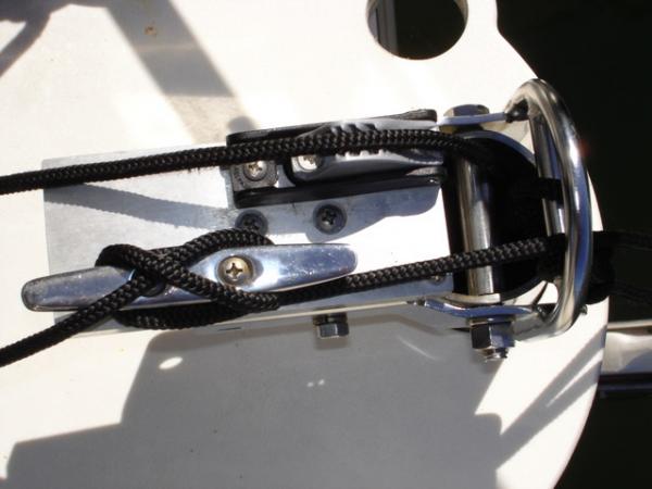

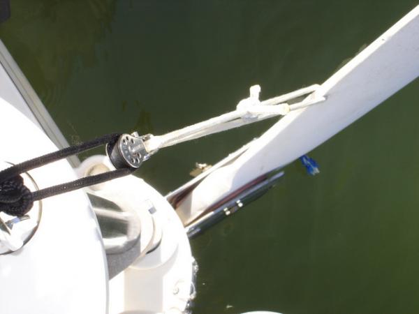

I added a quick release cleat for the rudder down haul and a block to the rudder uphaul to make it easier to lift it all the way up. Here are a couple of pictures.
Are you having trouble lifting the rudder out of the water or getting rudder down straight to sail the boat ? It is usually more difficult to get it to go down than up. Often have to use your foot to get it under water then you can pull it the rest of the way down with the line.

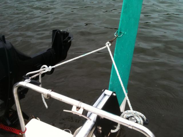

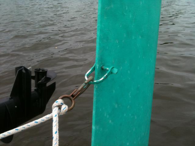

Same problem here getting it past horizontal on our 23.5. The PO of Grasshopper installed a shackle on the aft end of the rudder. We use the boat hook to fish it up from there. We then use a short line to attach a snapshackle and secure it to 2 rail cleats to discourage sway. I also have a PVC tiller holder I use for additional support. Will append photos in due course.

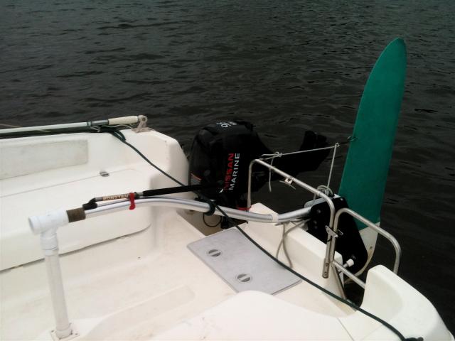

For what it's worth, I got some snapshots today of my rudder rig. As you can see, I have a triply redundant system to keep the tiller/rudder from swaying & banging: the shackle on the trailing edge of the rudder tied off to the rail; the PVC tiller post; and a "Cajun tiller tamer" tied off to the stern cleats. No doubt it's over the top, but I'm a believer in safety over sorrow.

Chiriqui, the hole and shackle were already there from the PO. I'm not sure I would have done it myself. No doubt, it subtracts 0.00001 kts of boatspeed due to the extra drag! :doh:
