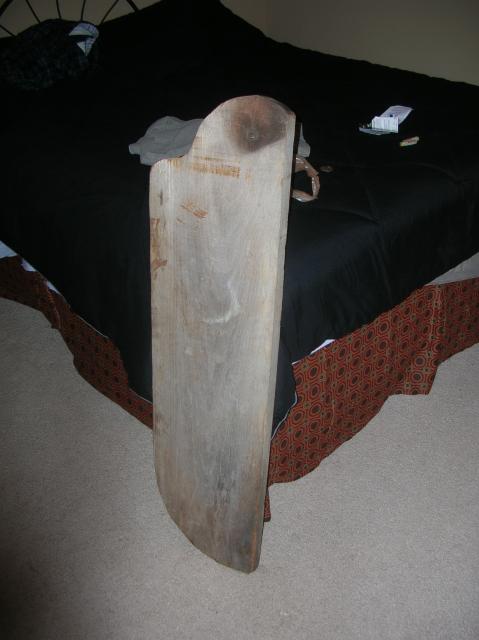

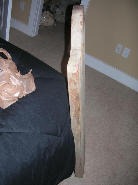

What would my infinitely more wise fellow sailors recommend for a foil shape on this rudder. This is going on the back of a 22' Helsen. From what I was reading, one should choose a NACA 0015-0025 shape for rudders. Also I read that for slower boats (im assuming something like a Catalina) a NACA 0018 should be used. The dimensions of the rudder are 1.5" in thick and 10.75" wide. Any constructive advice is appreciated.
