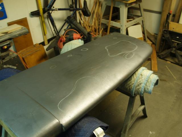

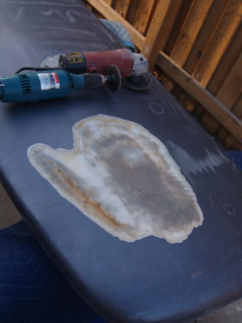

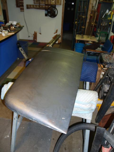

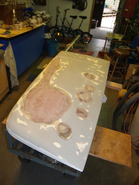

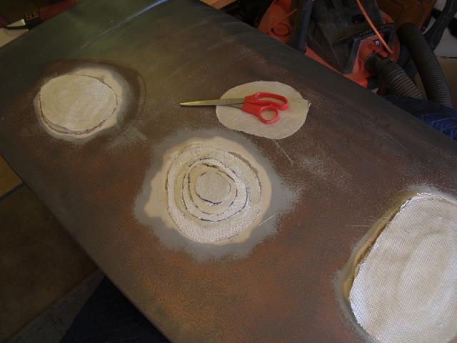

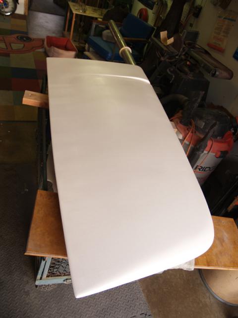

I know that many of you have been hanging on the edge of your seats to know how my rudder project went so I thought I'd post some photos. The project seemed a little bit daunting before I got started (like most projects) but it was pretty straightforward. I found the delaminated areas by dragging a ball peen hammer across the surface of the rudder. It was easy to hear the difference in tone where the solid areas were vs. the delaminated areas. Grinding was no fun but that was really the quickest part of the project. It's amazing how fast you can tear something apart, putting it back together correctly however, takes a long time. The project certainly took a while to complete, but I have confidence that the repair will last. I ended up applying Interlux 2000E which is seen in the last photo. I'll apply my VC17 when I paint the boat.
