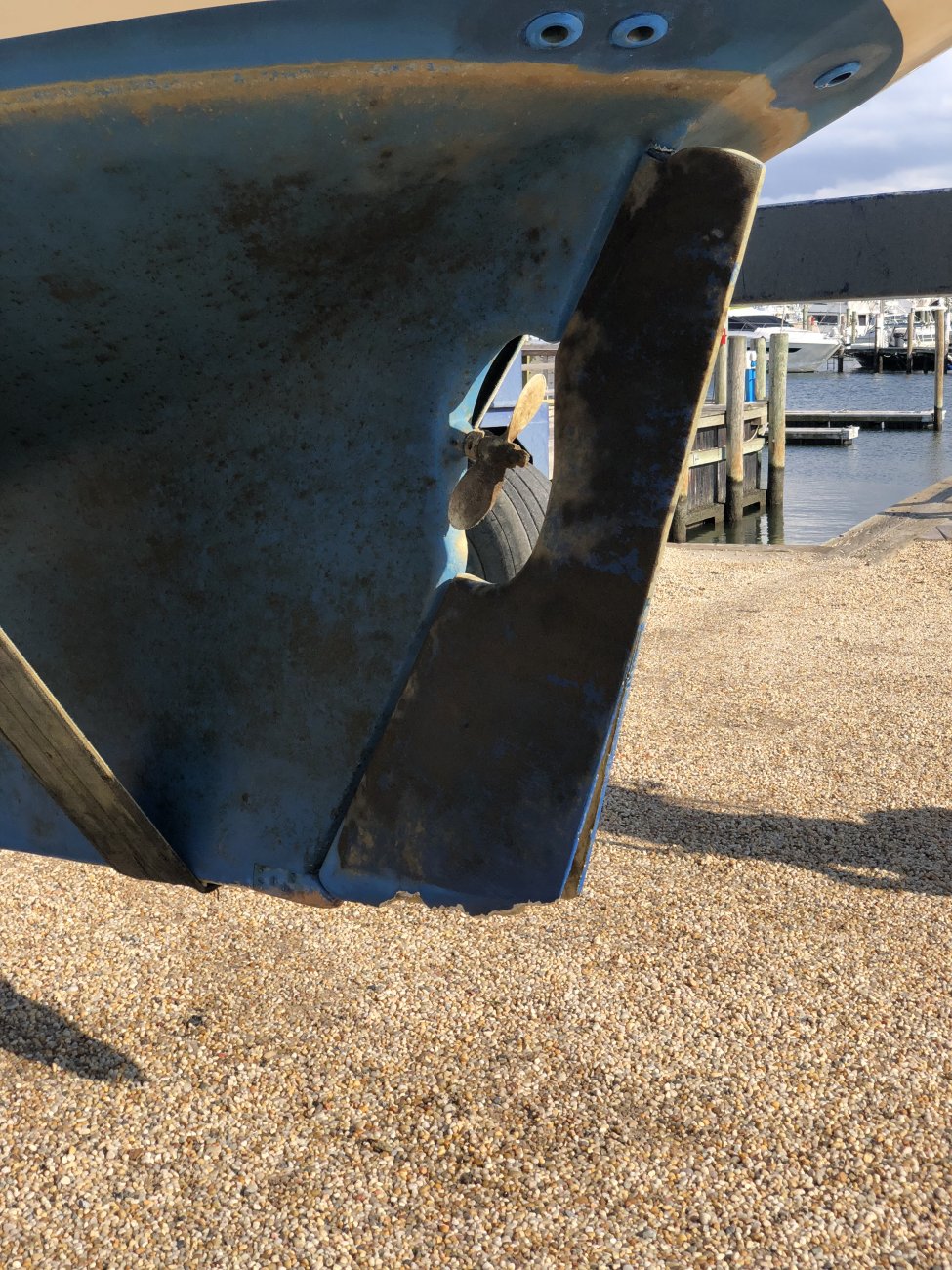

It wasn't until hauling 5 weeks later that I saw the damage. My boat had been slamming off the bottom from the large swell and astronomical low tide that came with the storm.
The bottom of the rudder had blown apart, the rudder shoe had broken loose and keel from midships aft was down to bare gelcoat, with some spots of roving exposed.

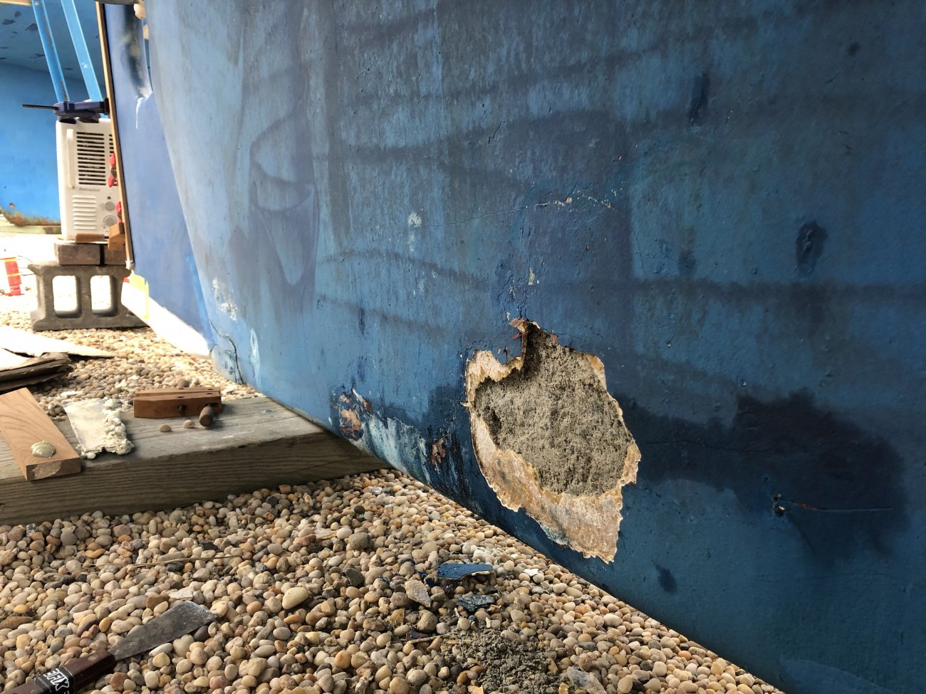

Fast forward to a weather window last week. I went to the boat to start the repair only to find a large portion of the lower encapsulated keel cracked. One portion of it had actually blown apart, leaving pieces of laminate on the ground exposing cement underneath.
I'm guessing water intruded after the damage had occurred while it sat in the water those weeks after. This winters freeze and thaw cycles must have taken an extreme toll and this is the result.

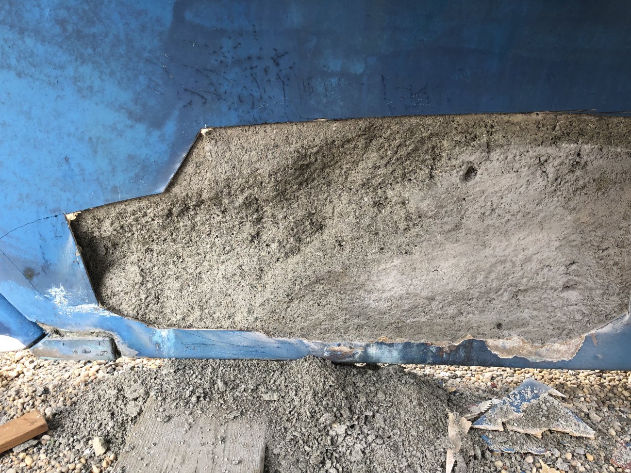

I decided to remove some of the dead laminate and found lots of crumbling cement with no end in sight, I stopped and walked away for now. My plan is to fill the voids with new concrete and laminate over that. Most likely, this is on both port and starboard sides, though the starboard side laminate has yet to fail.
Should I keep going, or is she a total loss?
