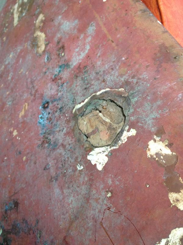

In addition - the rudder has a weird bit of damage to it - here is a picture:
Not sure what it is - the rudder weighs rough 35-40 pounds and appears to be solid but a little scratched up - this "hole" is dry. I am considering just pouring some epoxy in it - but would appreciate a more reasoned response.

Check out boat works today on YouTube the guy has a whole series on rudder repair it is pretty good

Danny, could your repairs have been done with the rudder on the boat?
Do you remember how heavy it is?
My '84 has about the same areas of delamination.
Also, other than crevice corrosion concerns, I wonder if some areas of delamination could just be monitored. It is very hard to find rudders more than a few years old that do not have increased moisture readings so if I do repair mine, I expect that without annual fall draining more issues will develop over time.

Delamination makes sense - do you think I need to open the rudder up any further or just grind around the hole? Would I replace the bit of missing material or just pour epoxy in - the rudder is off the boat and based on the last registration of the boat it hasn't been in water in at least 10 years - so the rudder is quite dry at least. One more project - going to be a long winter.
