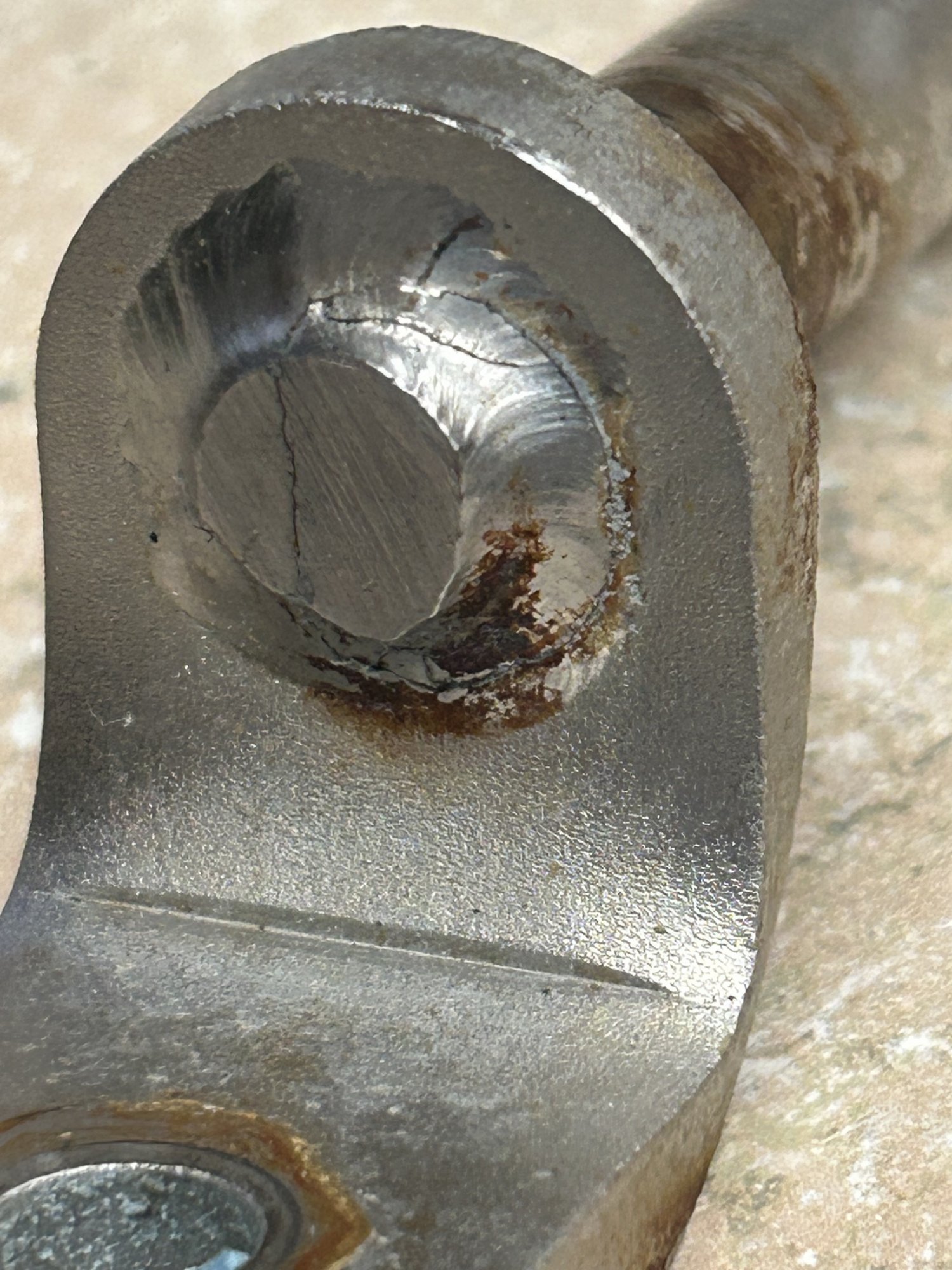

1) PROBLEM ; The Pintles are not very well engineered. The welding between the Pin and the L bracket cracks due to poor design. The last inspection a few day's ago found the 2nd cracked pintle.
I called RC and alerted them to the issue.They remembered having the same discussion a year ago. The shop never did anything to correct the issue.
At first I was told I would have to pay for a new part but when I told them it was still within the 6 year warranty they said they would send me one for free.
SOLUTION ; Inspect Pintles every 6 months
