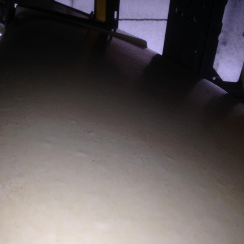

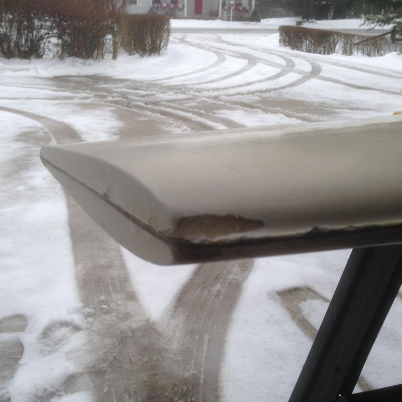

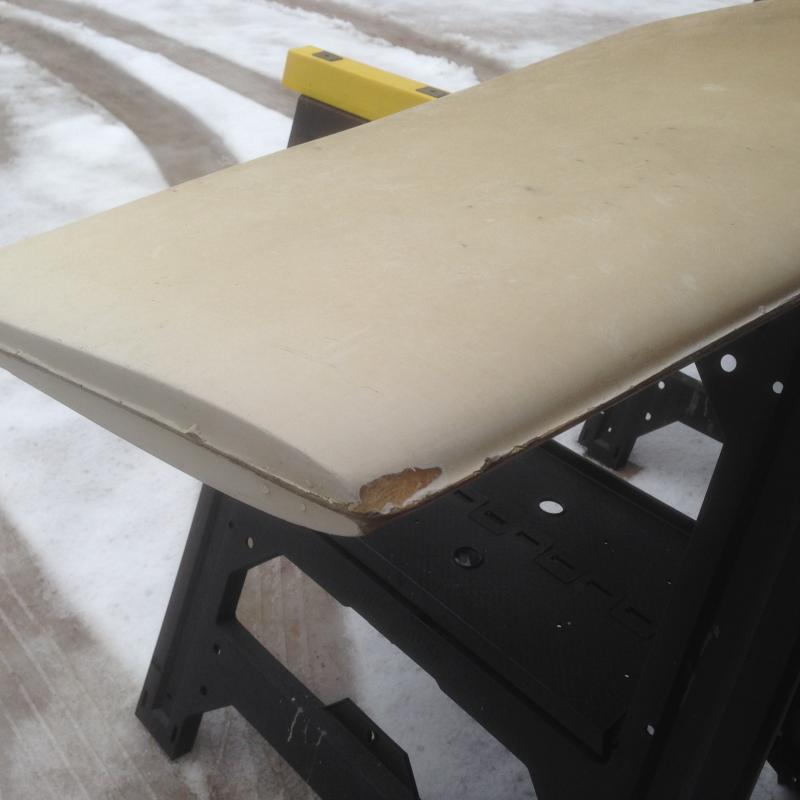

I have small blisters, the gelcoat chipped off the end of rudder, no water inside. What should I do to correct this. I want to paint the rudder with vc17 ,which is what on the bottom of my boat now.

I would dremel those even though numerous, fill in with two part expoxy to include the area where gel coat missing, sand smooth and refill if necessary and sand. Coat with barrier coat and the bottom paint. It did not look as if the bottom of the rudder blade has split unless it has which you will need to advise.
Find out which bottom paint works well for your area is the best advice on that.

What I said about grinding them out especially applies to Ken's problem. If they're gelcoat cracks (spiderwebs), that's *different* from blisters.
There's only two reasons I can think of for cracked gelcoat: stress and air bubbles. Stress can do funny things-- I had tons of it in the hull right under where the shrouds attached to the toerail. No mystery there. Oilcanning (repetitive 'b-doinking') of wide, flimsy sections of hull-- above the v-berth, aft of the quarter berths-- will show the same thing. These need to be done with a Dremel and filled with epoxy (second choice: polyester/vinylester product) and appropriate filler.
'Draw' the tool along the line, as far as it goes. If you hit it once, a little, and you see no crack just below the surface, leave it alone. Otherwise dig them out till you see no remainder of the crack (usually into the greenish resin-- the gelcoat is microscopically thin on most of our older boats by now).
Airbubbles look like blisters; but they don't show up for the same reasons. Airbubbles are typically caused by the factory peons applying too much gelcoat with too little brushing and daubing (such as with a fast, wide sweep of the gun), so that a thin skin of gelcoat gets into the outer skin of a corner (like along the top of the hull, under the toerail, along the bow, edges of the rudder) but more of it forms a kind of bubble over which the first layer of fiberglass goes, so that it's never noticed. When the boat comes out of the mold, the outer layer of gelcoat appears to be a sound skin. But it will crack and admit water, if only just into that bubble. I found a lot of these in Diana's topsides under the toerail. They may look like thin cracks; but you hit it with the tip of the pointy stone on the Dremel and it gives way to a veritable cave in there.
I had one on the transom, looking like the tiniest little line, but I hit it and-- I do not make this up-- it was 5/16" deep and about 7/8" across in there. :doh: Really I wonder if it had ever really been leaking at all. But it's filled now with epoxy (and glass fibers).
As for blisters, they're caused by one of two things: pinhole cracks admitting water from the outside, or, worse, osmosis from the inside of the hull (which typically is not gelcoated-- it should be). These look like what Ken has on the side of the rudder blade. I would be careful to check if the foam core is not wet or rotting-- grind these out with the 3" wheel as I said earlier and see what's inside there. Definitely fill these with 'glass patches, not mere filler putty.

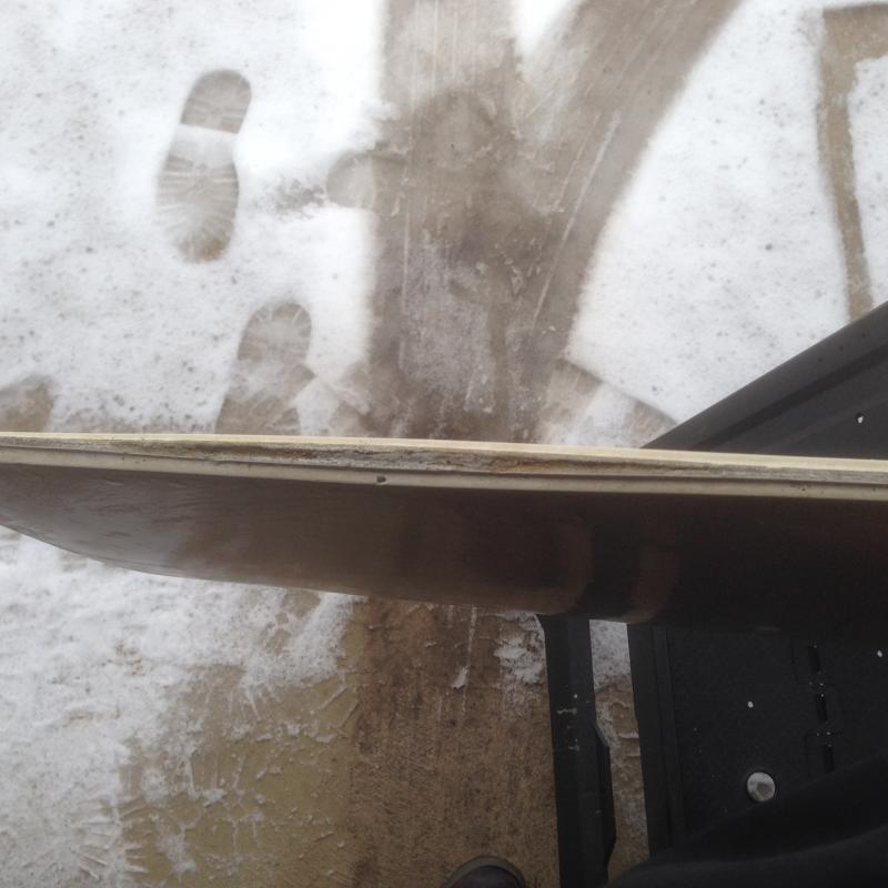

Ken, do I see an outside flange around that rudder blade-- like the two halves are dimpled outside? Is that how they made that thing? Heinous.
I would grind that whole thing off, to take the half-a-knot's gain and the more delicate steering ability, and 'glass over the whole leading edge and re-fair it. Why not? --you have it on the bench now. All it is is work.
