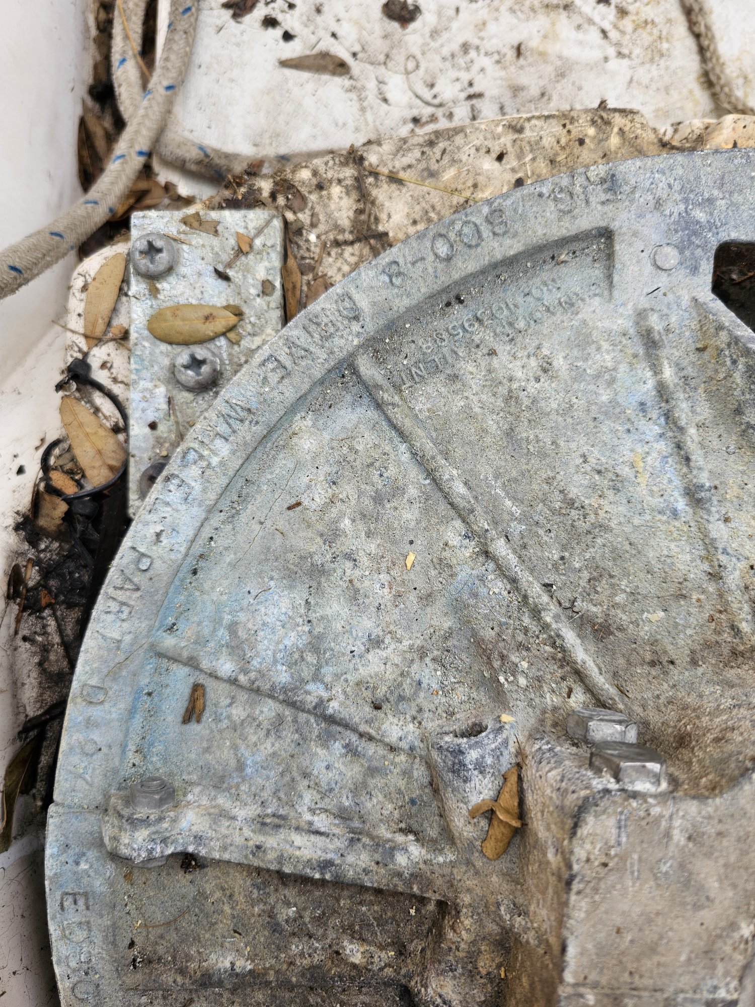

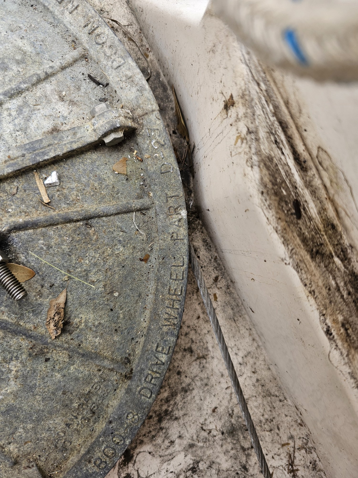

As far as bolts, I need to remove the after side of the quadrant to get to the 2 bolts that hold the rudder stop on.

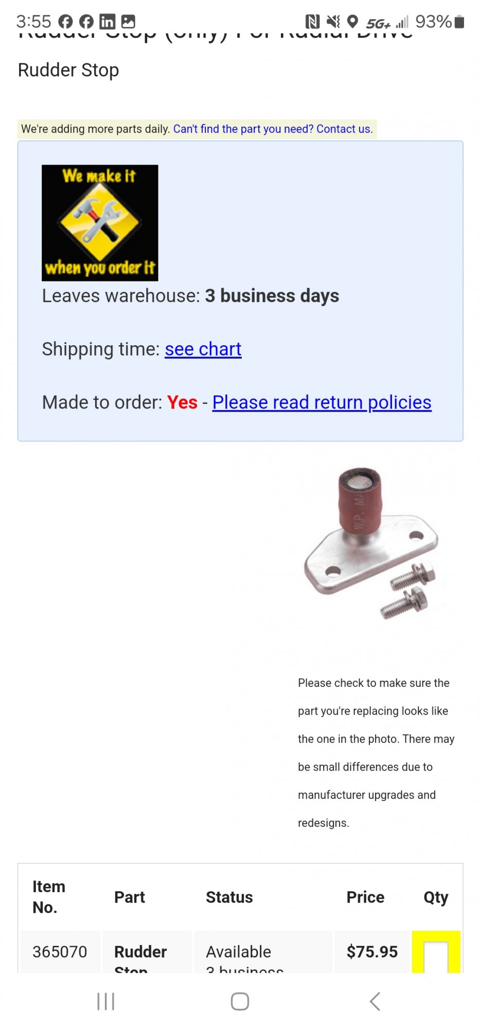

I don't have a picture of mine that shows everything, just the part numbers (attached) , but it looks like attached and the part I purchased to replace the broken part attached too.
