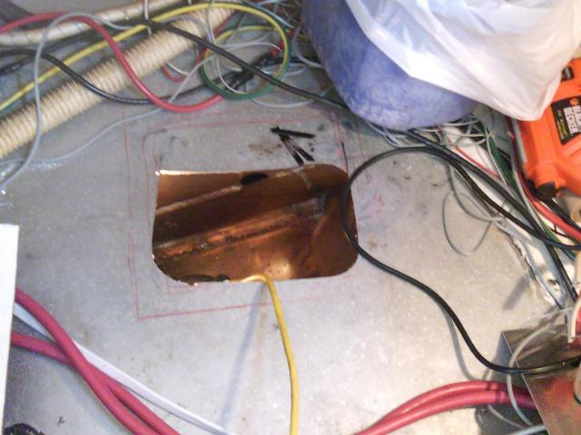

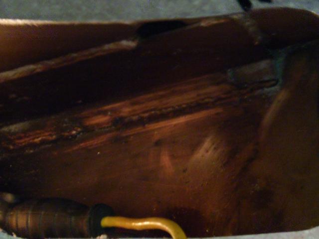

Those who followed my recent cruise blog know that we had our engine die on us 4 times due to blocked fuel line. Now that we are home and opened up the fuel tank, found a soft rubber "thing" at the bottom of the fuel tank by the fuel pickup. Don't know how it got there or how long it has been there. We've had the boat year and half, and just started with fuel line problem during Feb. cruise. If anyone has a theory, would be interested in hearing it. Attached is picture of rubber "thing." It's little over inch long.

Bill, do you have the standard aluminum tank with the gauge in the forward inside corner? If you were able to get down to the pickup tube then someone cut an access port. And is there a return fuel line from the engine? The original QM engines did not have a return line but a newer one would. Just trying to see how your tank is different from the original.
1,483
Don't know if tank is standard, or even original, but it fills the space under the quarter berth and the fuel gauge is in the forward inboard corner. No access. I cut a hole in the tank to the first baffle. Was surprised how close to the forward end that baffle was. Tank is stained brownish, but no gunk in the bottom or on the walls. Pickup is copper tube, maybe 3/8"id brazed? into inboard bottom corner of tank. No screen. Tube runs fwd to within 2-3 inches of forward wall, right at bottom of tank. Will suck up all but the last few ounces of whatever is in the tank.

What you described is original Bill. And if you were the first to cut an access then the only way into the tank was through the gauge hole. The fuel line hole and the vent hole would be too small for that rubber thingy to get in that way. The gauge itself had no parts like that. At least not the original one. I still have it, all metal except for the cork. And it still works! I added cleanout ports years ago and then had to add the return fuel line when I installed the 3YM30.

Did you take a sabre saw to the tank? Did you have to do anything to get rid of the fumes before cutting or is diesel fumes just not an issue? Are you going to use machine screws when putting everything back together?

Normally you don't want the engine to suck out the last oz of fuel. Fuel pickup should be a little off the bottom to avoid sediment. The fuel pickup on my tank is through the top with a tube into almost the bottom of the tank. There is also a fine mesh screen at the end.
You can just plug up the existing and put a new one in from the top.
Yes
No
Yes
